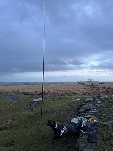

20m 1/4 vertical using 80W

Hams have been working G<VK/ZL paths for a long time but normally from home with beams etc. just a case of right band at the right time. So doing S2S with possibly one end QRP and simple antennas is always much, much more satisfying especially when you’re out in poor light etc. You should treat yourself to some custard to celebrate. Shadow doesn’t look so impressed though.

He wasn’t. Faffing on Beacon Batch mean’t he was 2 hours later for his dinner. He was pretty upset I hadn’t considered this and I wouldn’t be surprised if you get a formal complaint… :rofl: :dog2:
