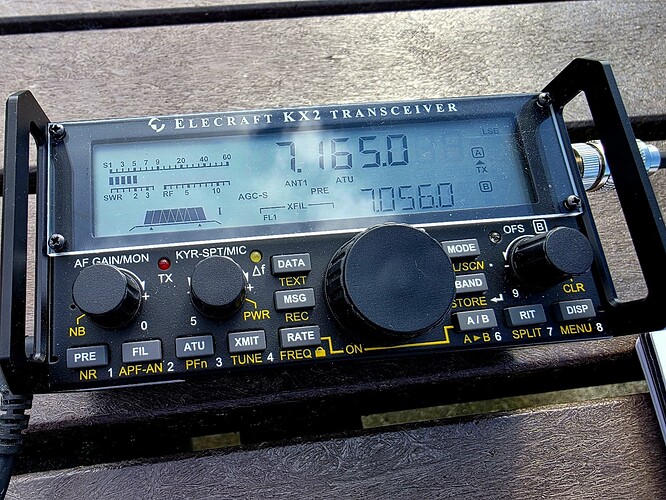

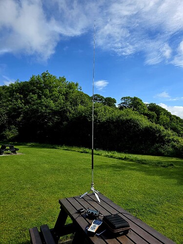

Couldn’t get out yesterday as the weather was absolute trousers. Took Barry and the KX2 up to a POTA spot and just tried to test things out, get used to tuning the RHM-12 and so on.

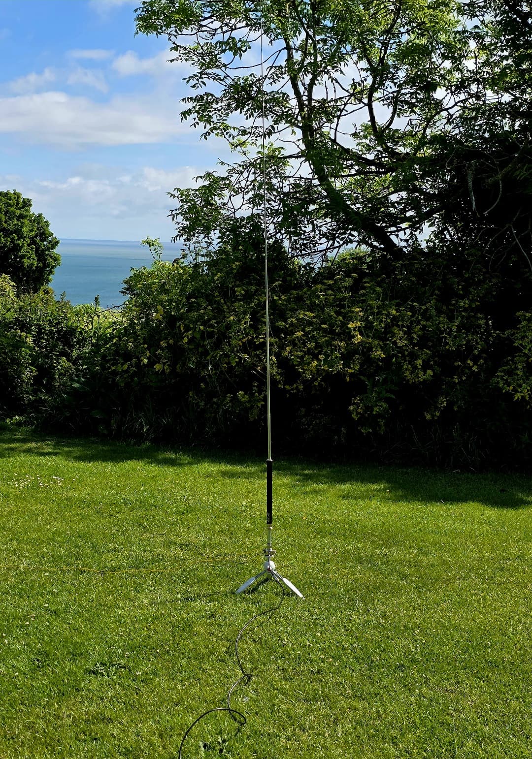

This is a snap of how I set it up. Couple of points of note:
  1. I only used 2 radials. I haven’t made 2 more yet.
  2. I didn’t bring a whopper tripod, just a portable Manfrotto. I will test though at some stage.
  3. I ran 10w on the KX2 voice only as I was short on time.

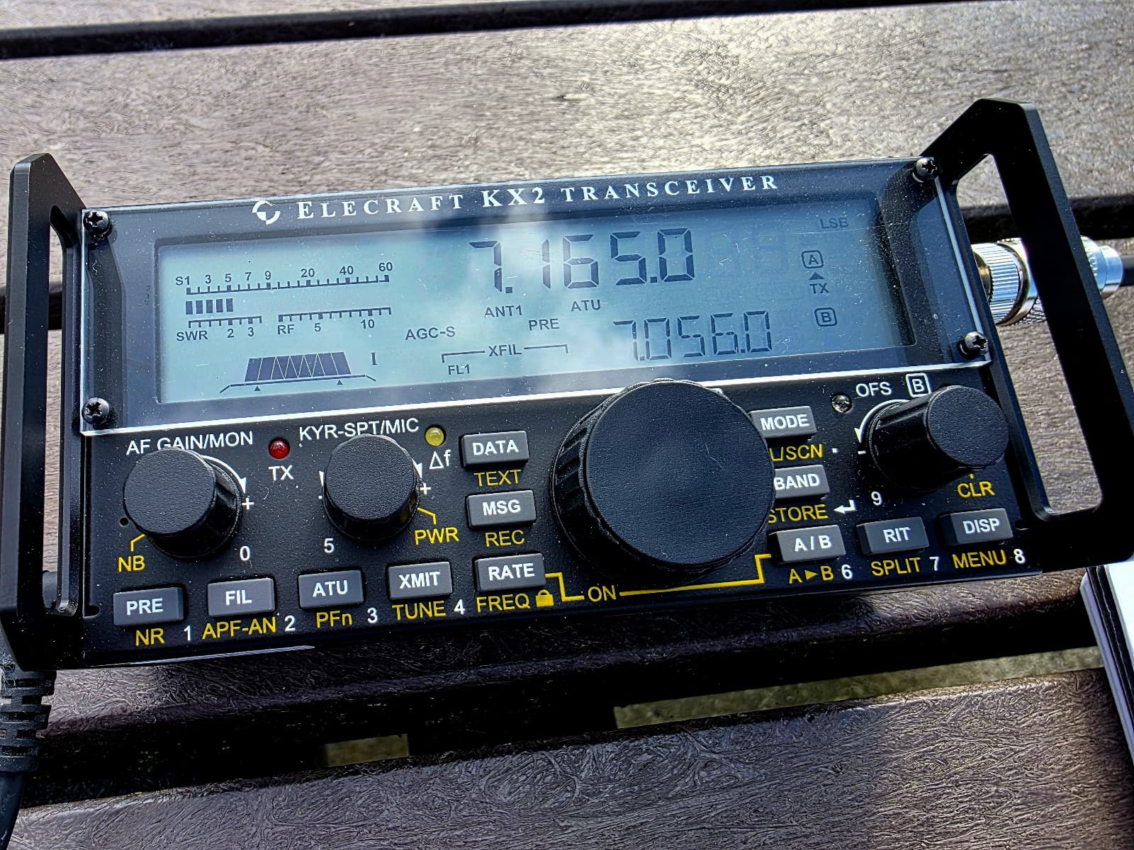

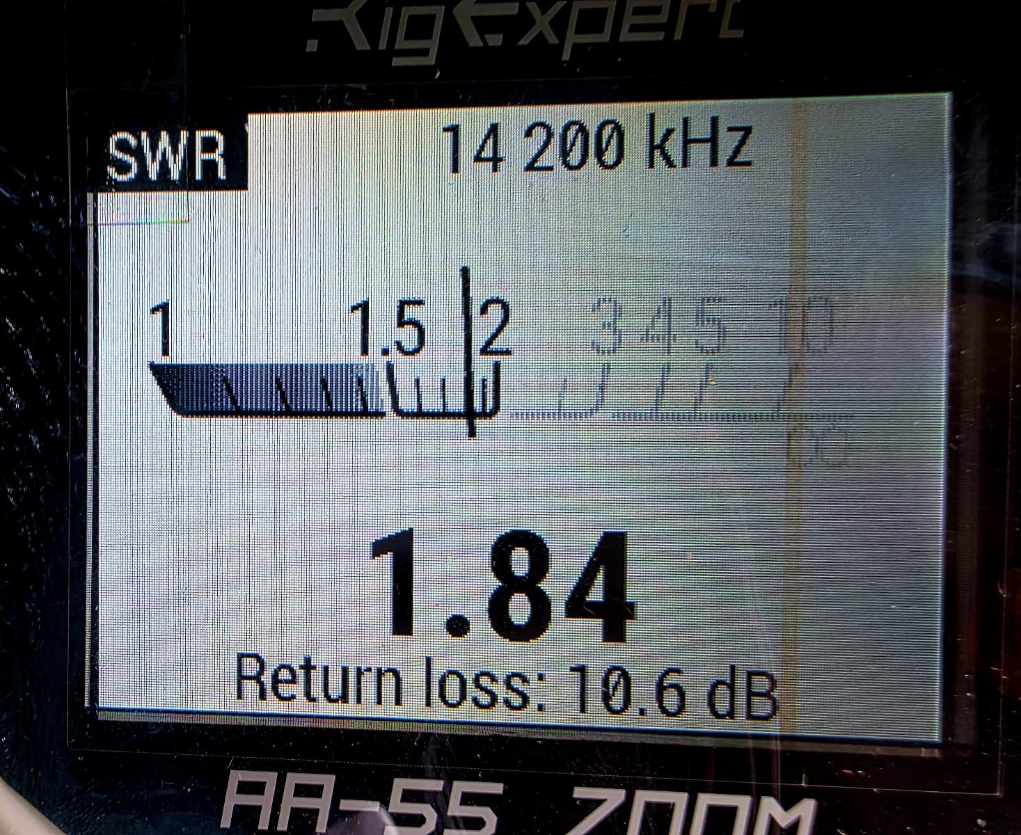

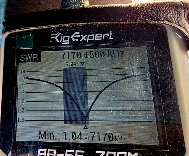

Here’s some snaps. You can see tuning on 40m was super easy. 20m not so much but I think it was more due to the set up and proximity etc. Sorry for the rubbish Rigexpert snaps, it was strong sunlight even with the colours inverted. Usually I use the black and orange setting.
Also, the second I switched on the KX2 I was on a frequency where a chap in Belgium was doing a QRP WWFF. I got a 57 RST and he was a 59 to me. What a fluke!
Tried another contact on 20m in Germany but he couldn’t copy my whole callsign due to noise. A shame but nice I was heard.
I did set up the 70cm antenna and radial, also the 2m setup using the enclosed string to measure the whip. Worked a treat as I was able to break squelch on repeaters (no sod was listening so no contacts, but break squelch I call that a success!).
Barry seems to be performing amicably. Next I am going to try using my FT891 with 100 full-fat, premium Yaesu Watts and we’ll see how that goes!

Here’s what my RigExpert was showing anyways. Thought to show an example if it helps anyone in a pinch on a summit.
inage deleted I uploaded the same 40m image and just noticed the image of 80m didnt save on my blower! Apologies. Anyways I was getting about 1.04:1 with a similar curve on the chart. Works really well! Here’s a photo of a 1986 Austin Maestro camper to make up for the lost image, my apologies.

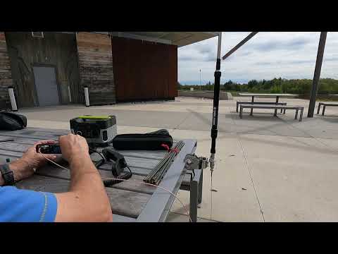

GRA-M105 Ultimate Portable M10x1.0 Connector Manpack Collapsible Whip Antenna: Enhancing GRA-RPG Series with 3/8"-24 Adaptor, 235.5cm, Ideal for POTA, for GRA-7350T, GRA-7350TC
No worries about bending the whip and offering something more rugged
Included adapters means I can use with my JAWS clamps

Can I also ask what length counterpoise wire you used on 40m to get such low SWR?

I used 3 x 10m lengths of wire. Nothing fancy, 24 AWG I think, crimped to spades.

There a few of using this 20m 1/4 wave telescopic antenna. It is very quick to deploy on a activation.
Also have a look at this video that Frazer made
I love mine and it’s been to Spain and Aruba and the USA

If it works like an RHM-12 then no tuner required. An SWR meter will help though. The good thing with the RHM-12 and similar style antennas is you can just give it a quick twist and nudge it up or down to fine tune. Run an SWR sweep again and see where you are at.
The markings on the RHM-12 are reasonably accurate. You can then adjust more to where you want to be on a specific band. Personally I find it very quick to deploy and tune this way.
