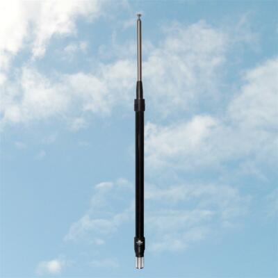

Just wondered if anyone knows anything about the Diamond RHM-12 mobile antenna?
Reason I tagged it ‘elusive’ is because nobody seems to have written a single word about it, so I haven’t a breeze if it’s worth trading a medieval coin purse of Florins and Guineas for.
There’s a couple of videos on YouTube but they are in Japanese. No trace or mention of it from the usual sponsored shills.
If anyone thinks it might be good to have on the motor, strapped to a triple magmount and a Diamond MAT-50, hooked up to an FT-891 (with optional MAT-30 ATU if it helps), I’d love to get some thoughts on that before bankrupting myself.

This antenna is sold (or copied) under quite a few brand names, but they all appear to be very similar. Stephan @HB9EAJ did a video on how he adapted it for ground mounting for space restricted summits:
Don’t expect great perfomance below 20m, and as Stephan says you can safely leave the 80m coil at home!
I built a version similar to Stephan’s setup as my stealth antenna for locations (POTA/SOTA) where I can’t get away with putting up a more noticeable antenna. It works fine on the higher bands for this (better than no antenna in these circumstances!).
I know 10m is great at the moment, but I did a local POTA the other day using this setup on 10m and worked reasonably far across the US and also down Chile with 5w using CW. I won’t have much expectations on the low bands however.

As others have said, the Diamond RHM-8B and 12 are antennas imported and sold by Diamond for many years. They consist of a slidable coil section on the bottom that is effectively the ATU. The RHM-8B has a BNC plug and was targeted at the FT-817/817ND market. I’ve never seen the RHM-12, but could it have been a similar antenna only with a PL259 connector?
As others have also said - the Spanish “Komunica Power” company design and sell a range of antennas both directly and via their distributors.
The HF-PRO-2-PLUS-T is a brilliant antenna when used either roof mounted on a magnetic base or used portably on a tripod with radial wires (also available from Komunica Power - or make your own tripod - an old photo tripod can be converted).
The HF-PRO-2-Plus-T came out about 6-7 years ago from which time I have had one and it ALWAYS performs! Unfortunately, 2 years ago, some Chinese company decided to copy the design and sell it at half the price through MFJ and some other US dealers, and I believe some UK importers. The Chinese copy appeared at Friedrichshafen in 2023 and a colleague of mine bought one. Being a copy, it works just as well as the original, except it comes without the 80m additional coil- so it is really a 40m - 6m antenna. I prefer to buy from the European company who designed it but that is always it’s buyers choice, whether to support a “local” company or buy cheaper from another company who stole the design.
You don’t need an ATU with the HF-PRO-2-PLUS-T - it, like the Diamond RHM series has a slidable bottom section that is your antenna matching.
Dont be tempted by the antennas that have a coil at the bottom and banana plug leads to short different parts out. If you can get those to work, they are a bad alternative to the HF-PRO-2-Plus-T. By the way, there is also the HF-PRO-2 which is the same antenna but with a solid rod element rather than the telescopic one. It works just as well but needs more space if you take it with you travelling.
73 Ed DD5LP.

I have the RHM-12, I purchased in Japan Oct 23. I also had the Kommunica one, which I believe is made by Gabil antenna and like others mention sold under different names. I purchased under the sharman md-3500 name from Moonraker.
I use/used both portable. The Kommunica has been a superb antenna, I have worked dx with SOTA and it’s great for a small impact quick deploy antenna.
I did a couple of reports on qrper.com.
Bottom line: Both do the same thing electrically, the Diamond is slightly bulkier but finished to a much higher quality. With a telescopic whip you stick need to take care to avoid damaging.
Unless like me you are lucky enough to be in Japan, the price of the RHM12 is not really worth with it. I can recommend the Kommunica/Gabil/Sharman.
