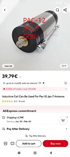

I’m considering making/buying a coil for 40 and 30m. Not sure yet how worse it would be to put that coil straight on the feed point instead of a few decimeters above with one “extension” shaft.
I though about a variable one like this:
I need to study a bit more.
