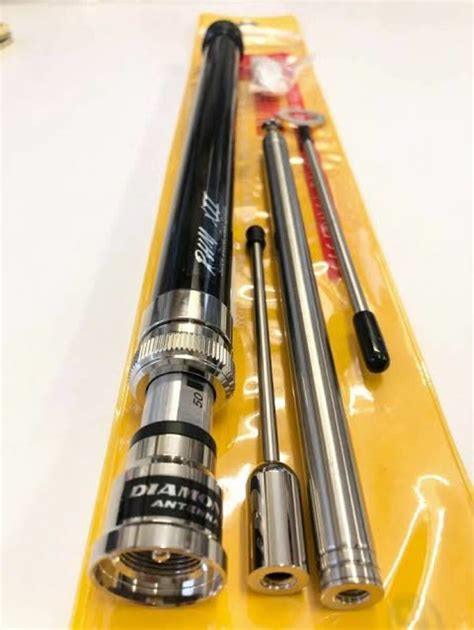

Barry ‘Diamond’ White and his pals arrived today, cheerfully delivered by DHL after only leaving Osaka on Monday afternoon JST. Impressive.
I did try the setup at a park this afternoon, but I was so short on time I only tuned the main antenna and rod to 20 and 40. 1:1 match with the KX2 ATU.
It was then I realised I’d forgotten to attach the 2 x 10m counterpoise wires to the TRS-3, by which time I had to pack up (I had my drone with me and wanted to spend 5 mins testing some settings before having to drive somewhere else to be on time).

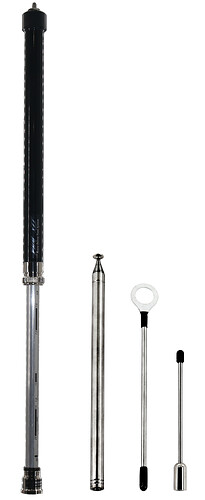

A very quick first impressions summary though of the RHM-12, RHM-12C and TRS-3 after literally 15 mins or so today.
  1. Build quality is very impressive throughout. The slider on the main antenna is superb and super easy to adjust. Each band is very well marked. Even the .jp emergency frequency is added.
    2.I didn’t try the 70cm antenna and radial. I will when ive more time. Looks well made though.
  2. The piece of string is to measure out the length of the whip you need for 2m. A nice touch and saves faff.
  3. The whole thing is incredibly light but superbly finished. A proper air of quality about it.

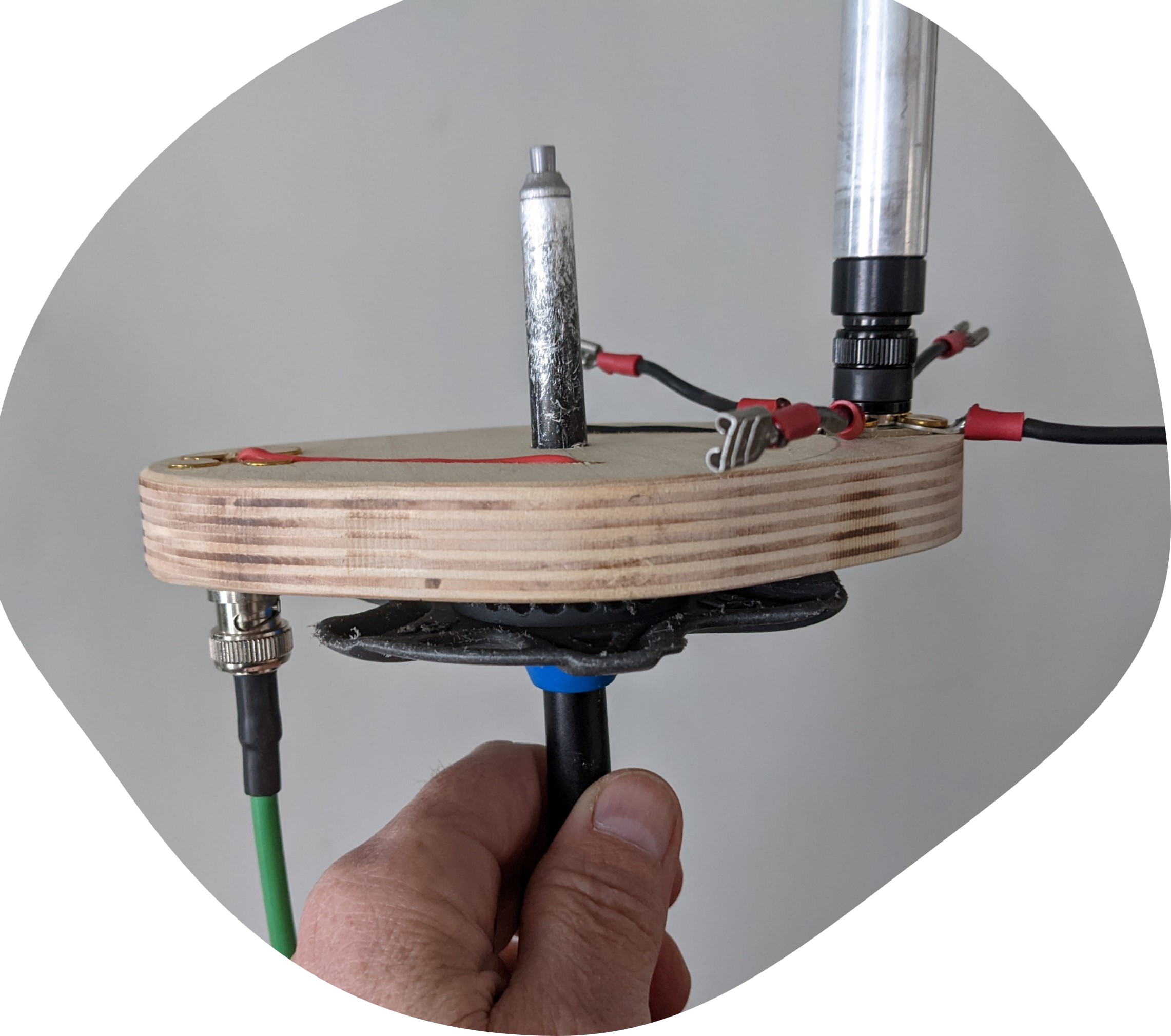

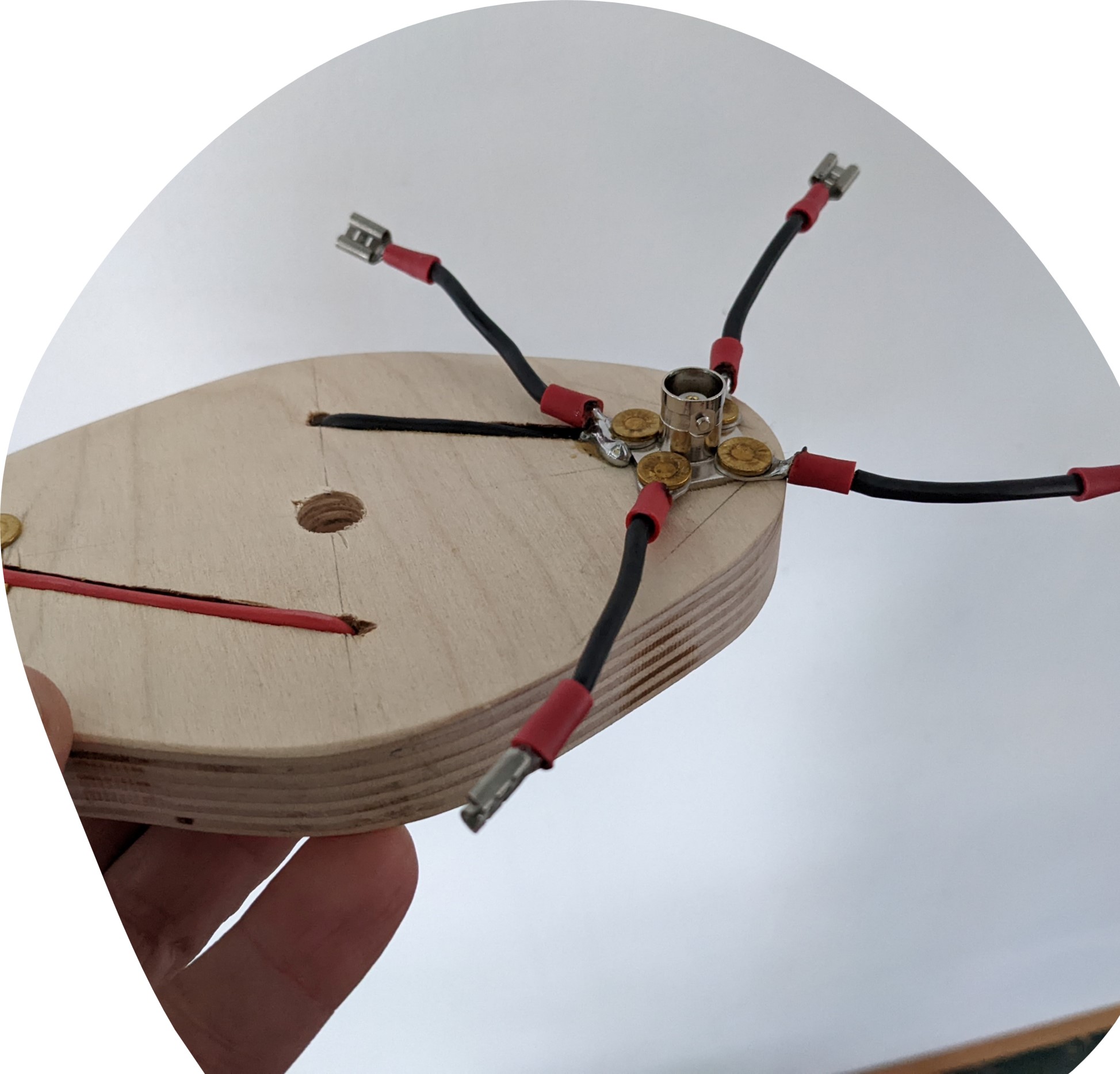

Thanks for the tip on the counterpoise wires. I made two using just wire and crimped on fork connectors with double heat shrink. (Thanks @MM0EFI for your tip on the AWG wire recently)
The TRS-3 has 3 connection points ready to go, though I only made up 2 wires. Might make 2 more now that I see you are using 4!
