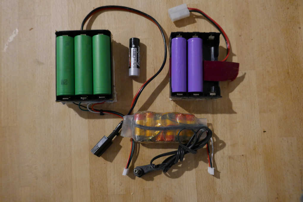

A selection of LiPo packs: top left green cells, 21700 4000mAh acquired new but I can’t remember where from, top right purple cells, 18650 2200mAh ex-HP laptop, bottom centre yellow, black, red cells 1000mAhr 3s2p KX2 backup pack ex-Vape ā€˜dogging’ cells. Centre is an AA cell for scale.

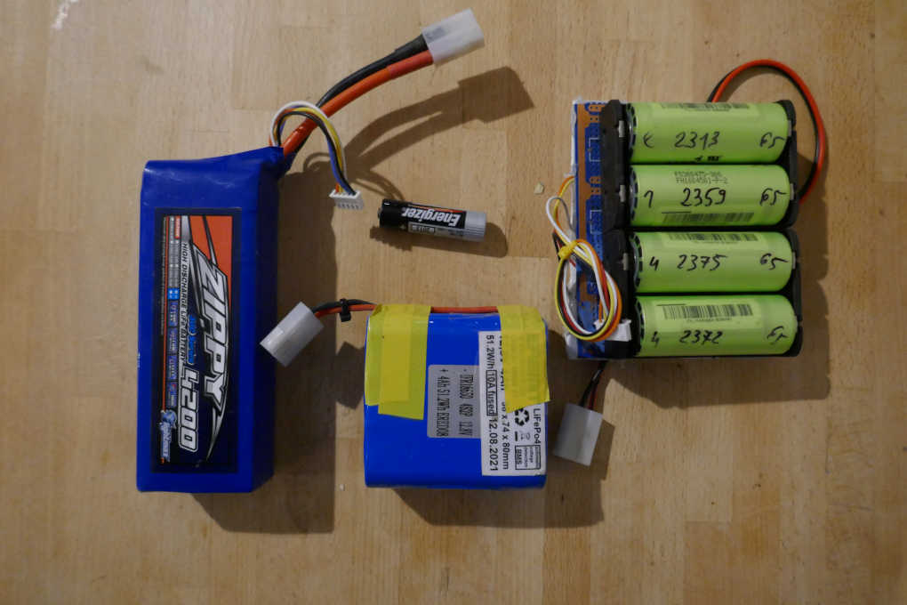

LiFePo packs: left 4200mAh Zippy 4s1p, centre bottom Eremit 18650 4000mAh 4s2p, right 26650 2500mAh 4s1p ex-Ebike, centre AA cell for scale.
The emergency pack is to satisfy my OCD. I don’t want to do a big walk/ascent only to find the main battery is at home still, or discharged. So the emergency pack is big enough to run a KX2 for about 1 hour or so and weighs 75g including wires. Not quite 2 KitKats, so is an acceptable weight. The production one is in a nice 3d printed case.

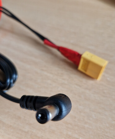

After some pondering and realising its a PITA to charge 10 x AA batteries in a charger that only does 4 at a time and takes all day. I decided to use the spare power lead that came with the KX2 and convert to XT60 connectors, also did the same to the batteries I use to power the FT-857.
Means I don’t need another charger, or buy more batteries (at least not yet) plus it also means I don’t have the risk of connecting the battery the wrong way around.
KX2 power cable with XT60 connector

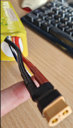

Zippy battery with XT60 connector
