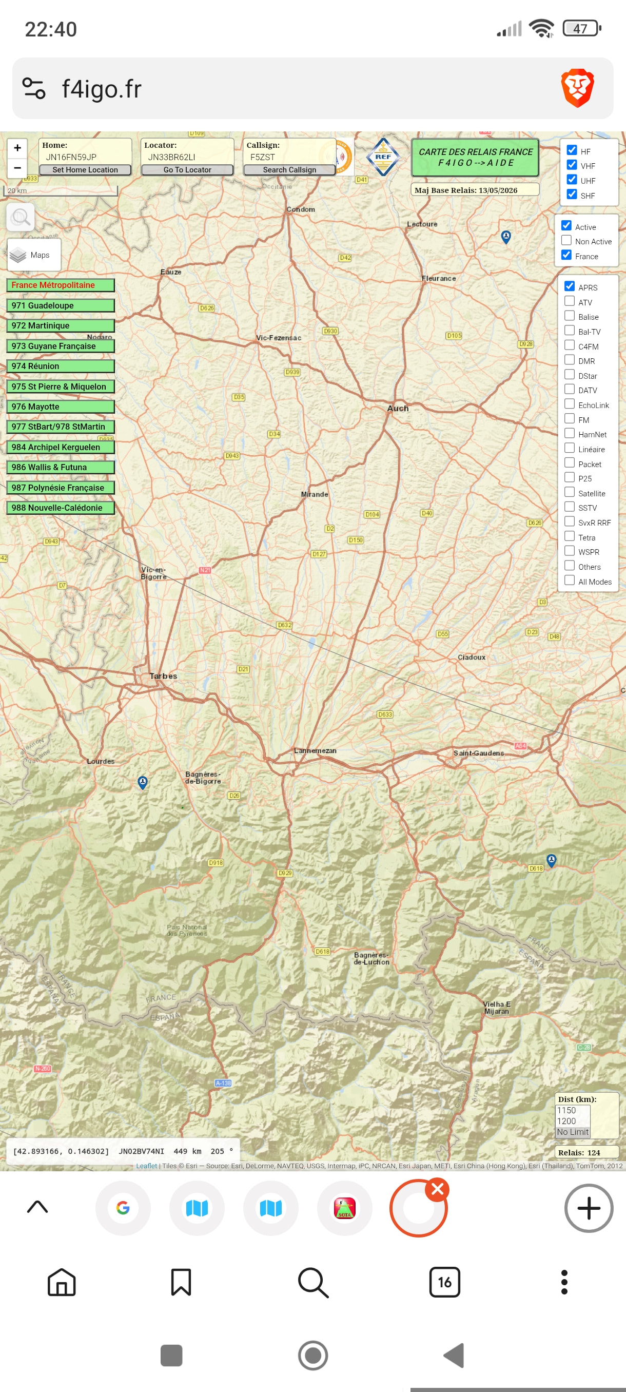

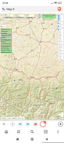

It’s very cool and I agree that sending real time text messages would be great. However, did you try it on the French side ? because when I see the map of the aprs repeaters … It’s quite sparse to say the least :neutral_face:
Only 2 repeaters , and at least one is in a deep valley.

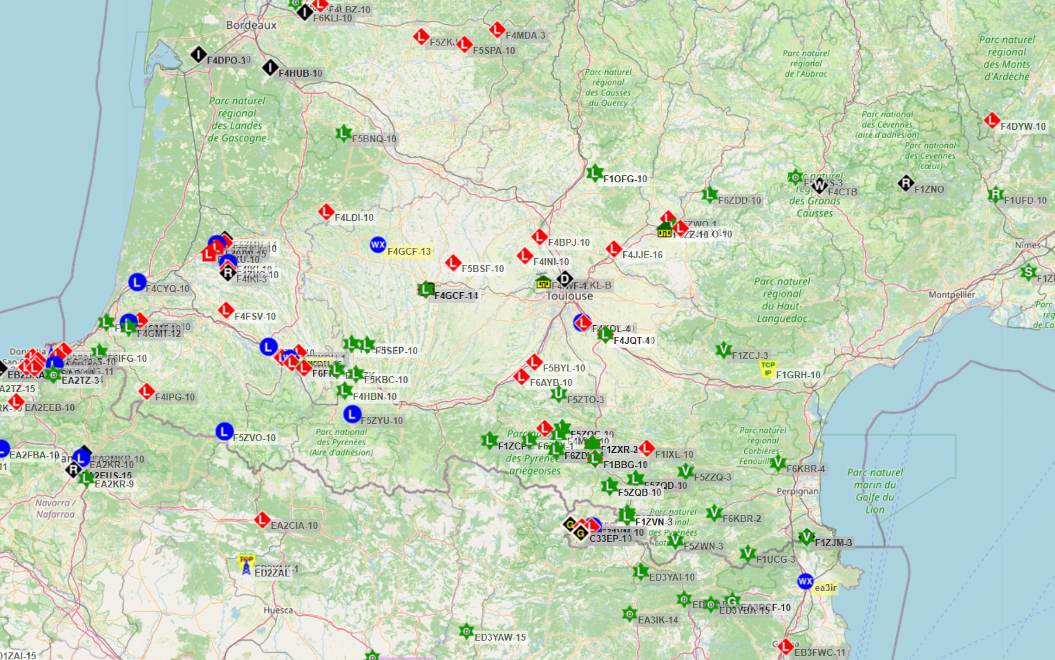

Yes, but not away from the Pyrenees. When I go to France I usually have very good APRS service, even too many stations heard at the same time and no time to transmit.
What I can tell is that there are a ton of LoRa iGates and digipeaters in France, as far as I can see:
I don’t know how to filter out Lora devices in aprs.fi…
But the good news is that you could try to find a cheap LoRa APRS (like a Lilygo or Heltec) and see if the network works well. But if you don’t have problems with regular internet you won’t probably use it much (maybe for beaconing)
