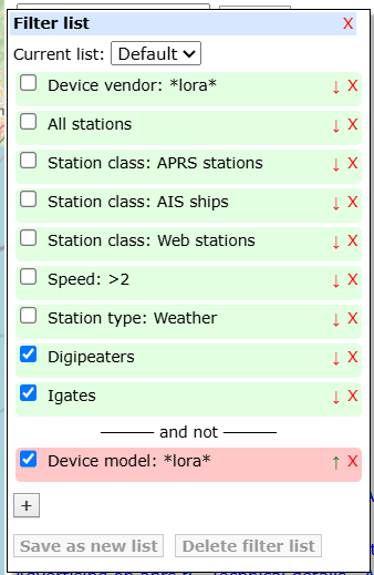

I learnt how to use filters in aprs.fi to “filter out” LoRa, or almost.
When I use this filter:

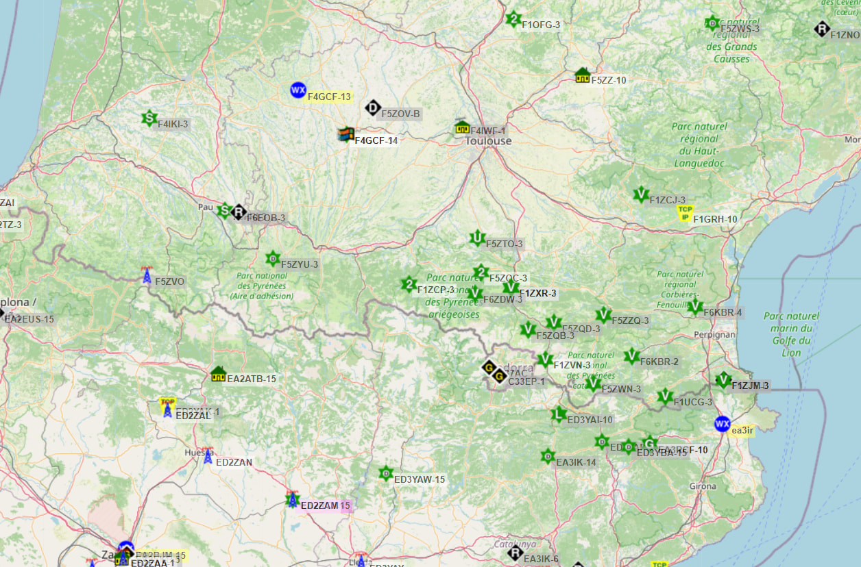

Look how many relay stations there are in France:
Basically:
  • Green symbols: digipeaters - they are repeaters, they don’t have Internet access.
  • Non green symbols: usually they provide Internet access
If you hover a station and it says "via TCPIP* and not “via WIDE…”, it means it has Internet access.
In conclusion, the VHF APRS network in France seems healthy!
However, this is exactly what I mean when I say that sometimes there are simply too many stations. Each of these stations transmits a beacon periodically, and if those beacons are sent too frequently and then repeated by multiple digipeaters, the network can quickly become saturated with traffic that adds very little useful information. In the end, you are effectively congesting the network with meaningless beacon traffic, which makes absolutely no sense.
