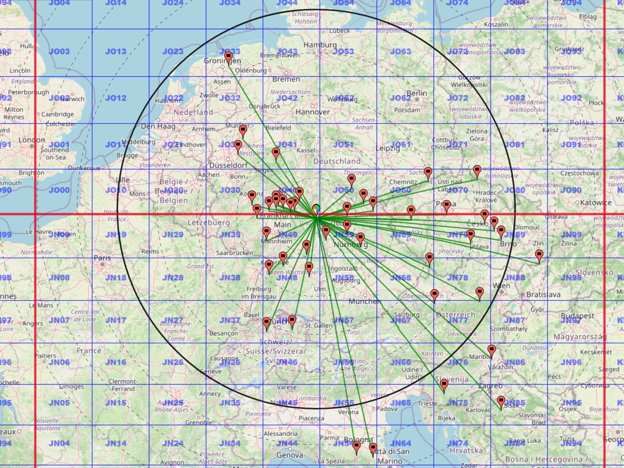

Yesterday, I participated in the DARC VHF July Contest from DM/BM-380 using my 6-fold Oblong, which is very close to the double hourglass antenna with respect to gain and radiation profile. The weather was mixed but the scenery was wonderful.
10 DXCC and an ODX of > 700 km completed the picture.
Not too bad when you take into account that I was working only with 35 W out of my trusted FT-857.

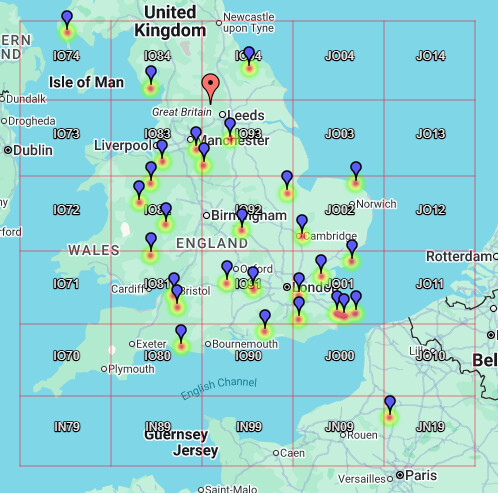

Yesterday I took part in the RSGB 2m Backpackers Contest from G/NP-028 with 5W from my FT817 and the hourglass antenna. All the European VHF contests were happening at the same time so there were plenty of stations on. I was very pleased to work a French station at 540km as well as several English stations over 300km. I also heard a PA and DL but they were too weak to work.

Yes, the French station was reasonably strong into IO82PE also - for most of the last hour or so. I saw your claimed score figures, nice work with the hourglass antenna.

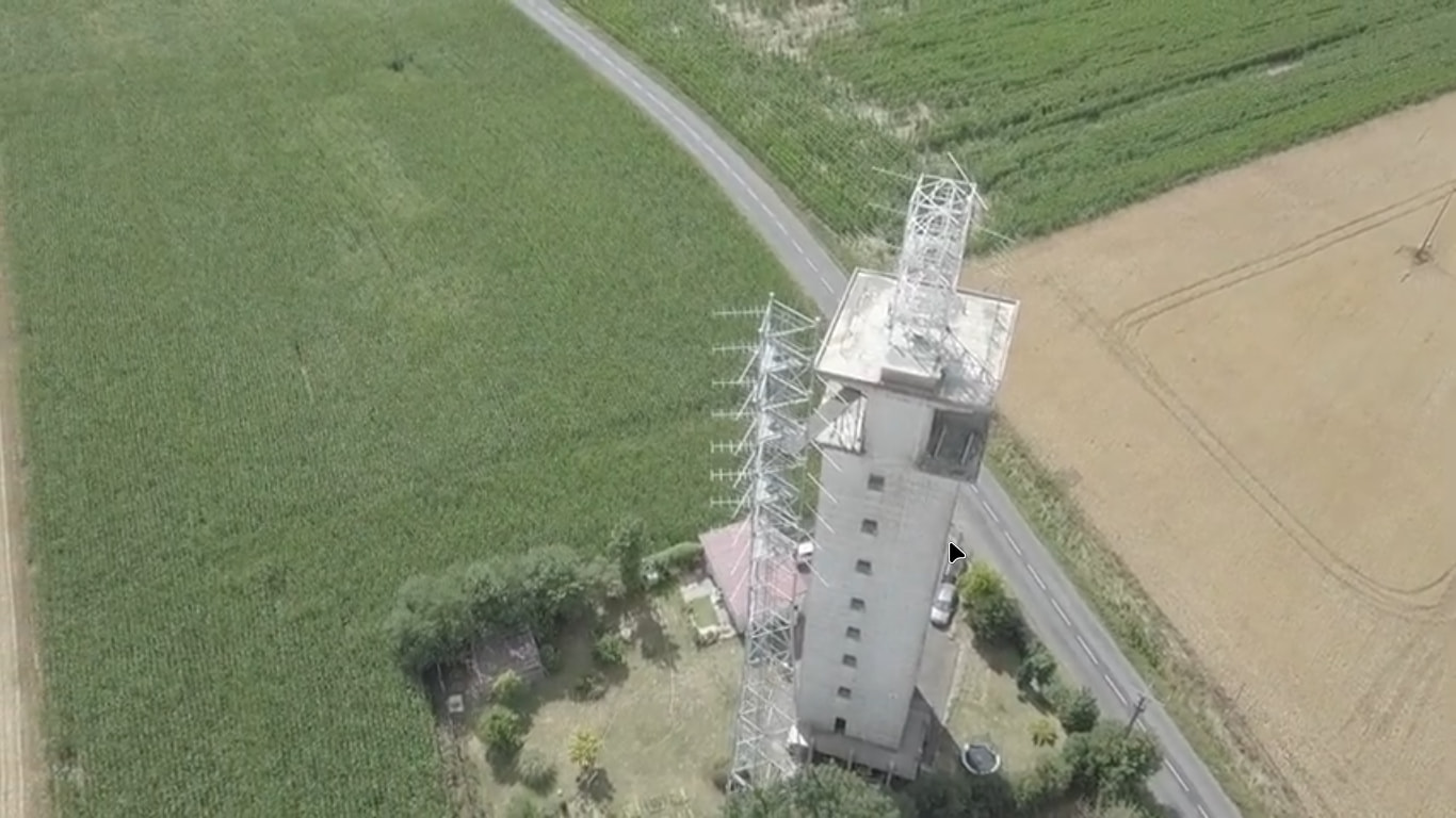

Richard, I suspect your French station to be F8KGU. It’s one of those professional amateur stations, no enhancement or aircraft needed.
To play on a line by Crocodile Dundee…
“That’s not an antenna… pulls tarp away THAT’S an antenna!”
