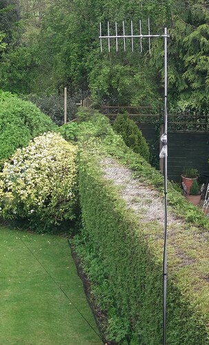

Next time, try leaving the iGate at home (connected to an outdoor antenna) and see how it covers you?
The problem is I don’t have a good antenna yet, I’m just using the little stubby thing it came with. I do have a Yagi which would work - I could try that then see how far away I can get before it loses me but that, being directional, is not much use for a fixed station. I will see if I have the bits to make a 1/4 wave ground plane vertical, which is the way to go I think. ![]()
I’ve also ordered a mag mount antenna which should be better for mobile use.
I’ve used a beam too John, with a masthead preamp (having disabled the Tx in the LoRa settings!)
That would be an interesting exercise - I could point it down towards say Cornwall and see if it can pick up me down there.
