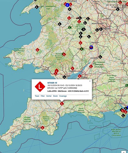

The current position is the igate is appearing on the aprs map.
But it isn’t receiving anything from the tracker Richard G3CWI built for me.
I’ll go through the configuration page again tomorrow and do a bit of trial and error if necessary but any suggestion or even screenshots of recommended configuration settings would be very welcome. For example, part of the configuration page covers beacons. Is the igate a beacon?
When I click on other gates on the map the window shows the frequency it is operating on.
But mine isn’t. ![]()
