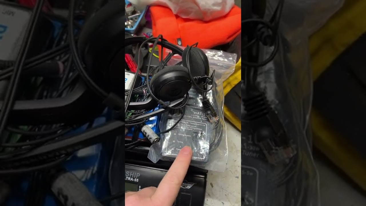

I just weighed my Kx2 setup and my 818 setup to compare weight.
Same microphones but 818 has external ATU, Compressor, lifepo4 3AH battery , cables etc.
KX2 setup was ~ 2.2 Lbs, 818 setup is about ~4.2 Lbs
With the KX2 being more fragile, and the 817/8 more robust, I’m thinking of taking the 818 out for winter activations that may have wet snow around (wet gloves) and leave the Kx2 at home.
Does anyone do similar?
My video of the setups below.
