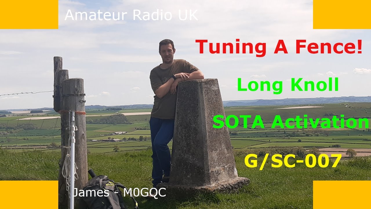

Strangest antenna for a SOTA activation?
I recently activated Long Knoll (G/SC-007) on 40m by tuning up the barbed wire fence which runs across the summit!
There was no particular reason……it was just a slightly random & childish experiment!
There is a video of the activation on my YouTube channel “Amateur Radio UK” (easier to find by searching for my callsign) if anyone particularly wants to see it.
This left me wondering what are the most strange & unusual antenna arrangements that people have ever used to activate a summit?

Did you make any contacts James with the barbed wire antenna? Surely on 40m you would have worked a few EU stations?

Only 5 stations on 40m. I wouldn’t call it a good performer but it would get you out of trouble if you left your main antenna behind.
The contacts on 20m & 2m were made using my “proper antennas”.
Here’s the log for the day

Did you try using another bit of the fence as the counter poise by any chance?
Nothing interesting to report here. But challenge accepted! I’m taking some croc clips with me when I go activating!
I used a single piece of wire laying on the ground as the counterpoise, roughly 10m long.
I did however run 20m on my normal vertical setup (7m Spiderbeam mast) & used the fence as a counterpoise for that with great results!
