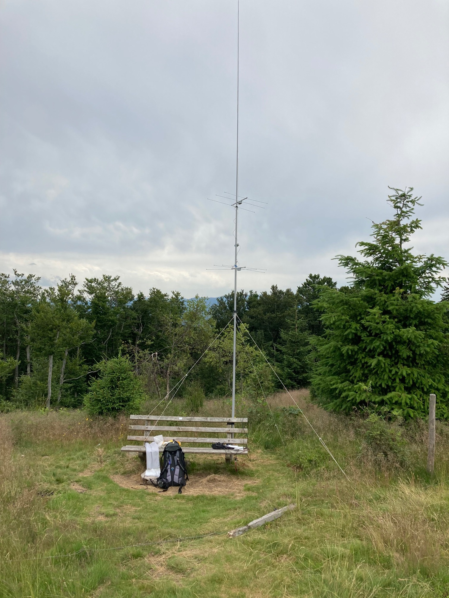

In the course of the morning the weather forecast became worse and worse… and so I always had an eye alternately on the rain radar of my app and on sotagoat.
Unfortunately I did not hear any signals from G or OE. There were only 4 qso … and here were also no dx.
Besides I have always still times cheated and have made a few S2S on HF.
At some point the rain radar looked threatening and I packed up. Until then it was a beautiful day.
I came home in time for cafe and cake - also not bad!
Meanwhile, a package had also come and on the table was my motivation for tomorrow. - After the many good reports (especially EA2LU) I could no longer hold back… First impression: it feels very good!..and yes: I intentionally ordered it all in gray.

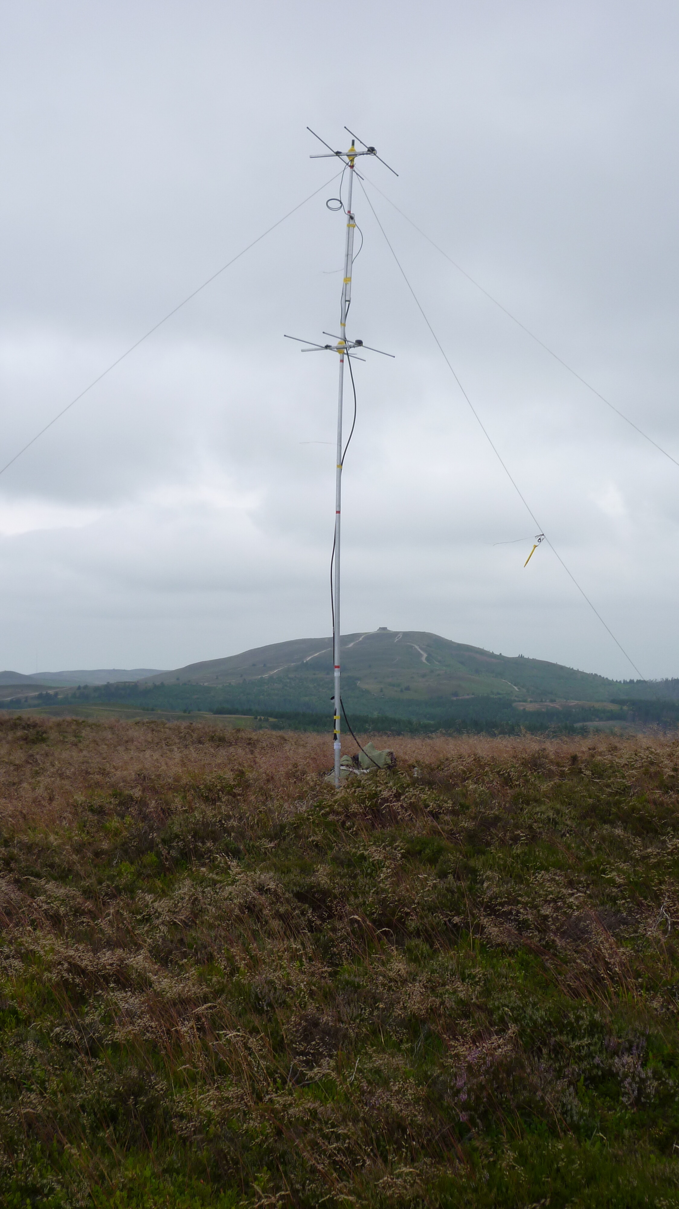

My activation was from GW/NW-051 Foel Fenlli near Ruthin. Easy, 30min access, good takeoff and few visitors.
The event (for me at least) was dry, but a fairly strong cold wind was blowing from the North East, I managed 3, S2S,14 CW QSO’s and 3 countries. Only continental station being DF0WD, 449 both ways.
Aerial system, 2 X HB9 CV’s, horizontaly polarised at 4 and 5.2m AGL fed with RG213 via power splitter, supported on a Roach pole.
Radio FT857 at 50W,
Battery 10Ah Lipo, useful capacity all used due to above average CQ calls and 2hr30m activation.
Observations:
I sent at 18WPM instead of my usual 21WPM.
I needed a handy list of worked stations.
Listened for spotted DL and F S2S, but nothing heard.
No further QSO’s after 10 GMT.
The aerial array was unnafected by the wind (not spinning round).
Perhaps afternoons would be better from a propagation perspective.
Thanks again and for those operating tomorrow, I hope the WX is good for you. Unfortunately I will be travelling North from Chester to Morpeth, life on the M6!
Regards
David
G0EVV
