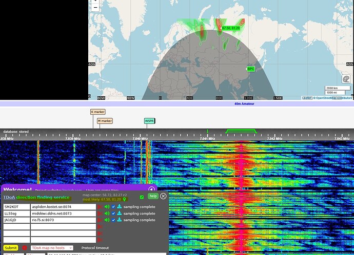

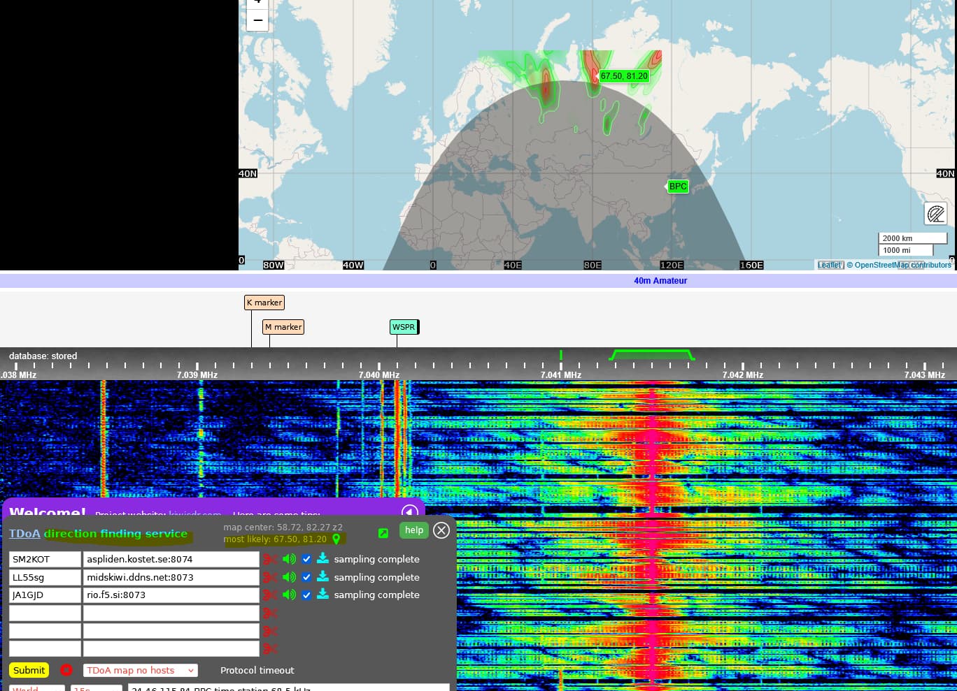

The KiwiSDR global triangulation service gets the origin from here… no surprise I guess:
So who know ?

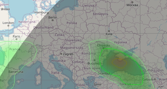

Tryed some other locations and got this
That would be a match
Yeah, 100%! Thanks Joe, now we in the know :slight_smile:
