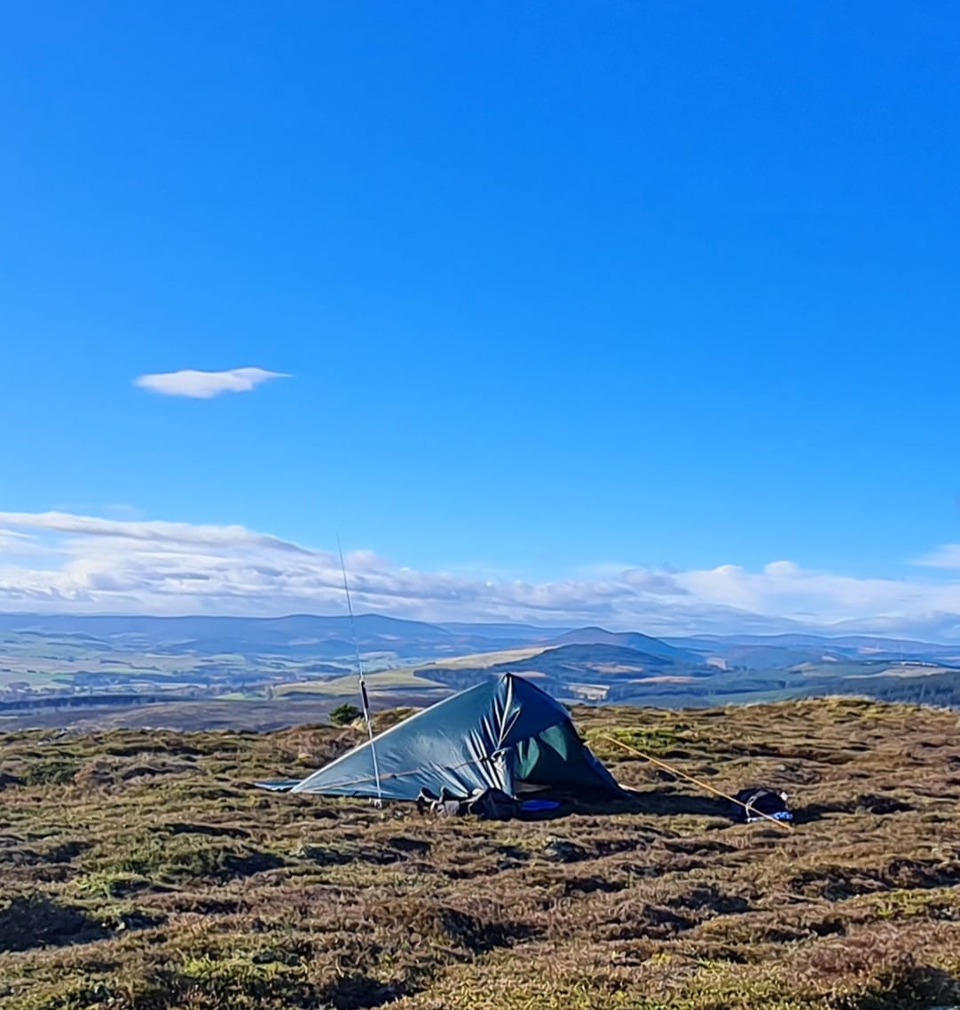

I usually carry a two-person bothy shelter with me or a tarp that can be erected as a simple cover or made into a small and discreet tent-like structure

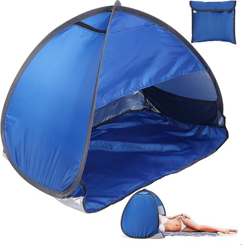

I also sometimes carry this small pop-up sun shelter to deal with passing rain showers. It is cheap and very light but the bikini-clad accessory is not included…:rofl:
I regularly carry a 2-person bothy for emergencies. I’ve used it once for an activation and didn’t particularly enjoy the experience. I’ve also ducked into a friend’s 4-person bothy after I finished my activation to wait for him to finish. We ended up with 3 people in it for a while and it was just as uncomfortable as the 2-person with single occupant. The same friend sometimes takes a beach shelter which is very comfortable (but I wouldn’t want to carry the weight!). I’ve used a tarp shelter once which worked ok, but tricky to erect on uneven ground in a wind. A tarp fastened against a fence works very well as a wind break.

I’ve tried tarps. Pretty good but difficult to erect in windy & wet conditions and not totally windproof if the ground you’re on is uneven.

A two or three man bothy bag (mine has/had no floor in it) is excellent but can be a bit noisy if you haven’t worked out how to keep it stretched out. To make mine more windproof I sewed into the end I sit on, a portion of parachute nylon covering much of the then end I sit on. to make a floor - but anything lightweight & thin will do. This I can sit on and it ensures that no wind can lift the bothy bag off the ground and no wind can get in from behind.
I have a a smaller sheet of nylon to cover the kit if it starts to drip inside the bothy bag.
I’ve also tried a golfing umbrella. You get some odd looks walking up the hills carrying one, but hey ho, its what we English do… :grinning: To ensure there is minimal wind getting through I removed one of the stays completely this means there’s a flat section which can sit against the ground. With a short bit of cord I peg the pointy end down and also the handle… I sometimes use the umbrella to hold the bothy bag taught/tight. Ok, it makes the bothy bag a bit cramped, but…
If I could find a small ‘pop up’ tent/shelter like MM7MWl, Mike pictures I might try one of those but they always seem to fold up far too big to stuff in a rucksack.
