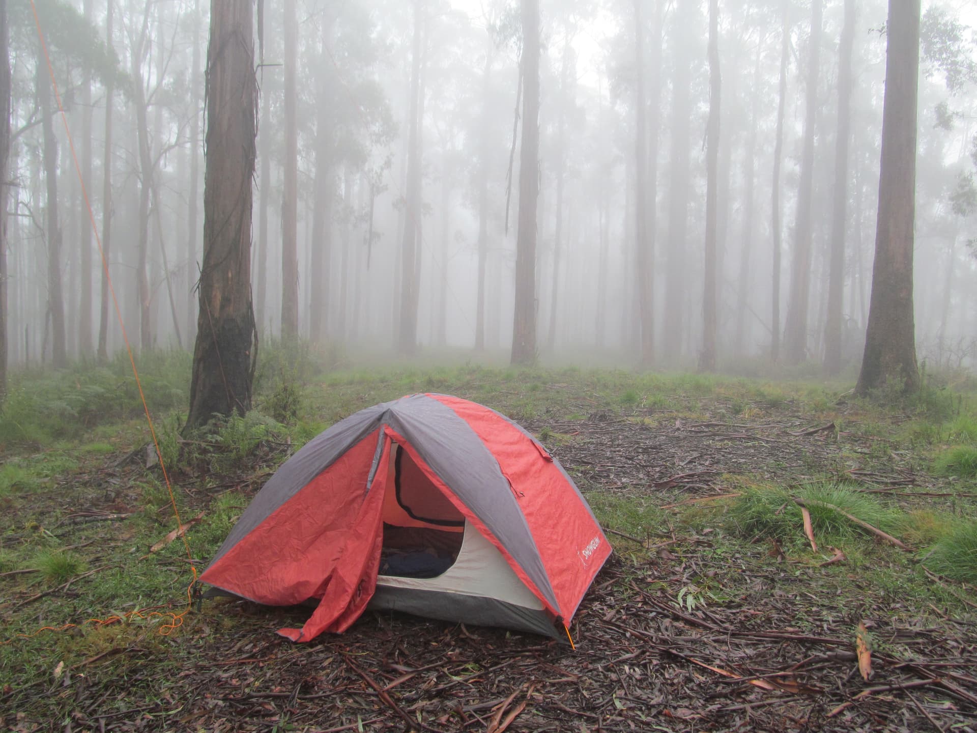

I have carried a 2 man tent to the summit, a short walk, and operated in light snow a couple of times but I am a few years older and perhaps a little wiser so that is no longer an option.

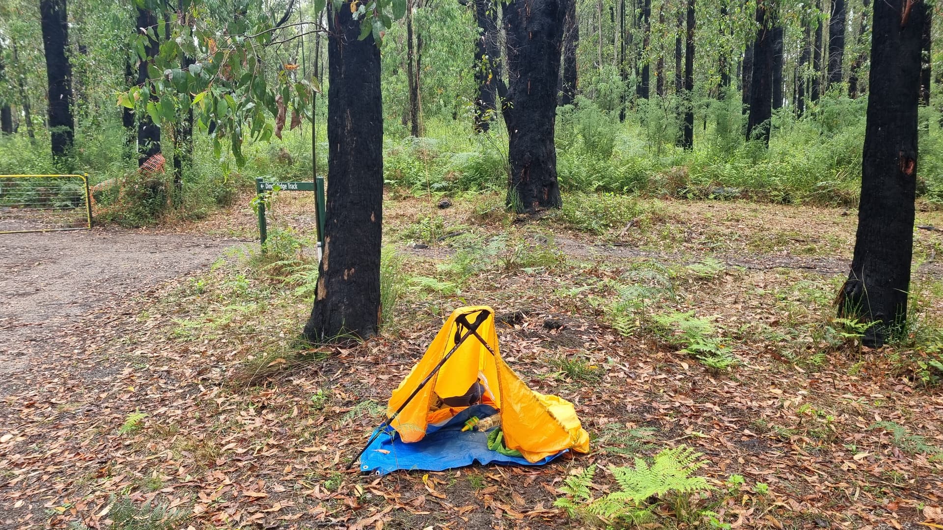

I have recently discovered that my Helinox ground chair fits nicely inside my Terra nova 2 Bothy bag. This enabled me to operate for over and hour from inside the bothy bag and eliminated the inelegant staggering around trying to get feeling back in my legs after sitting on the ground without a chair. Even with the chair I can’t pretend it was comfortable in the bothy bag. As others have said, they get hot, they drip condensation, they rustle and they flap in the wind. I find it disorientating sitting inside a small bag, not having a decent view. People have walked right up to me on a couple of occasions while I have been in my bothy bag without me being aware until they are right next to me.
Bothy bags are a life saver and super quick to deploy, but if it’s definitely going to rain and I’m going to spend a decent time on the summit, give me a shelter every time.

For sheer convenience and value for money it’s hard to beat the Decathlon, Quechua, Camping Shelter. Ever since I saw @G0WPO, Neil’s I have been a convert.

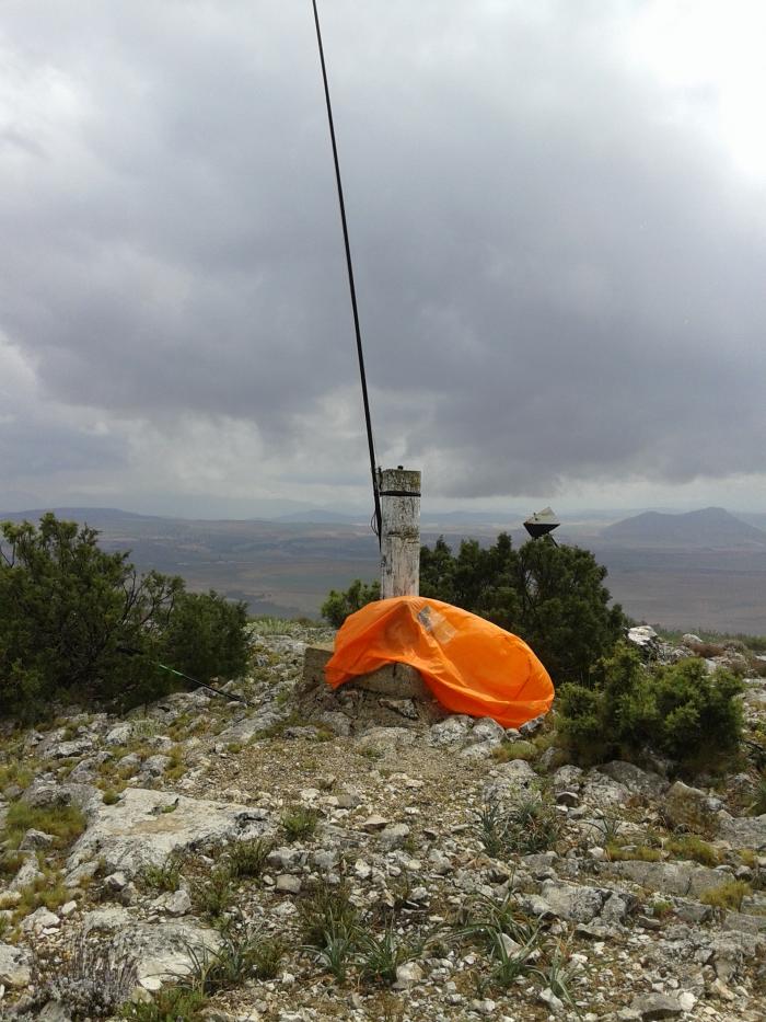

If there is a possibility of rain. He always goes with me;
bothy bag.
Dani EA5M.
