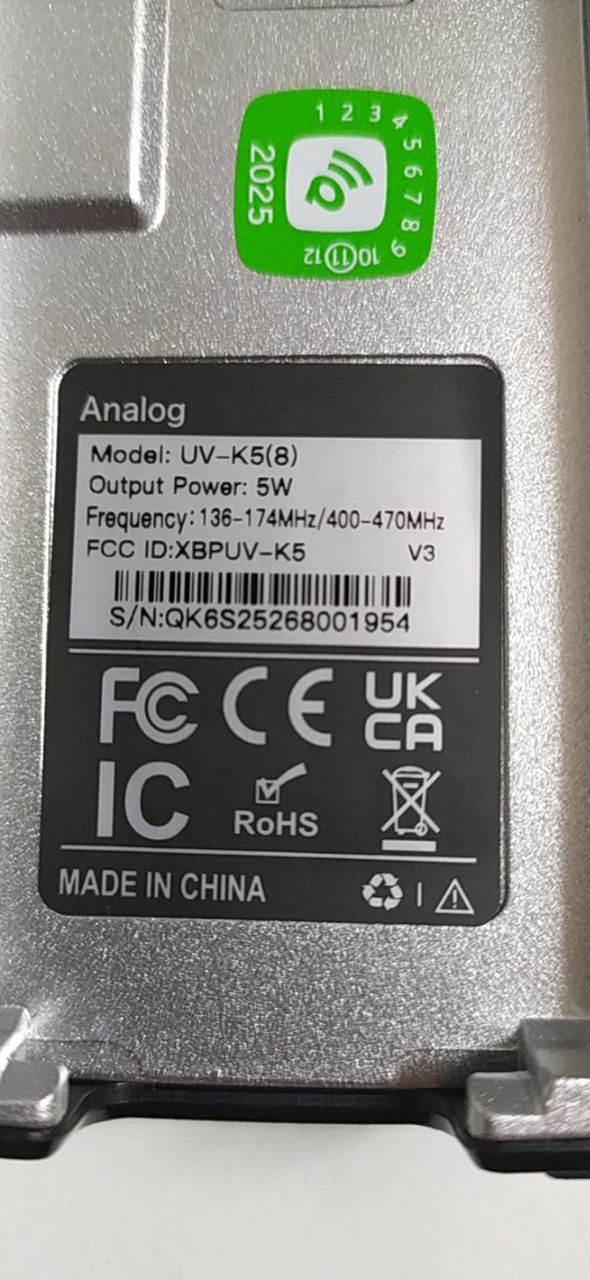

I received a Quansheng UV-K5 (8) v3.
I tried installing the IJV 2.9R5 firmware so I could work in CW mode. After installing it, the Quansheng stopped working. I managed to restore it with the original firmware. I’ve tried this several times, but the same thing always happens. Is it possible that the Quansheng UV-K5 (8) v3 isn’t compatible with the IJV firmware?
73 de Dani EA5M
@EA5M
No Dani, IJV does not work with V2 or V3, they use a different processor.
see my post above:
I had a V2 and could make it work with the F4HWN firmware, but it does not transmit in CW or SSB, just receive.
Also I don’t know if it works for V3.
I hope the IJV firmware will be ported to V2/V3 someday …
Luc ON7DQ

Damn I wish I had found this thread before purchasing.
I received a UV-K5(8) V3 recently, expressly to try out CW and SSB from summits as part of this year’s SOTA challenge.
After repeating @EA5M experience of a bricked radio, I found this fork of F4HWN that brought the radio back to life, info here on Reddit and flasher tool with link to f4hwn.k5v3.fusion.v4.3.bin – as others have said, no SSB/CW TX in the F4HWN firmware.
A final comment is that the UV-K5(8) V3 also runs the v5.1.0 too, which was the latest at the time of this post. However, still no SSB/CW.
Hopeful for a port of IJV’s firmware onto V3 hardware…
George, M1GEO.
