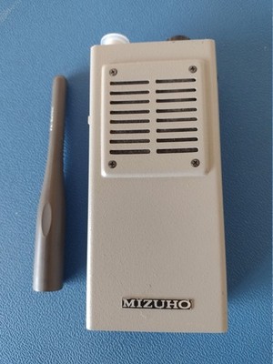

There is a 2m SSB/CW handheld for sale right now on The People’s Palace of Tat (eBay).
I’m missing something :joy: just looked again and can only find HT’s with SSB receive. What the model make?
Thanks
Paul.
Can’t be bothered to trawl through ebay, but the only ones I can think of is the Mizuhos, and they are as rare as hens teeth!
The search-fu is weak with this one Obi-Wan.
Don’t blame me if the price goes through the roof now I’ve posted a link to it. (Not my sale BTW).
:sweat_smile: :melting_face: Pls delete this one too. Tns
Thanks, as ever it’s all in the search term :joy:
