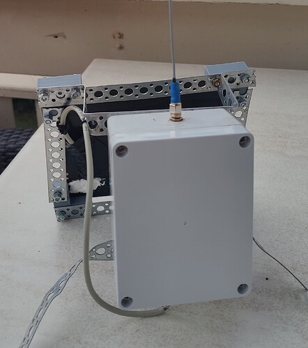

Having similar problems with the recent August build on two digipeaters, they seem to occasionally enter a boot loop which is difficulty to get out of. Cycling the power from the battery connection doesn’t always fix it.
Starting to think its an RFI issue
-Only occurs if digipeater is set to Tx
-Occurs at the Tx part of the boot cycle, when the unit sends a beacon
-There is no power supply issue that I can see, voltage remain stable at input to heltec.
-if I disconnect the antenna it stops happening
I’m thinking it is most prone if the battery wires to the heltec run adjacent to the antenna wire, but not sure.
Started to suspect RFI when the voltage readings on the power supply went up during Tx.!
Update a few minutes later:
Tested with a dummy load and the problem disappeared. When an antenna is reconnected the problem returns. Have repeated swapping dummy load and antenna several time and I can repeat the problem with the antenna connected, but never appears with dummy load.
Antenna and battery wire are faily well separated (see below).
