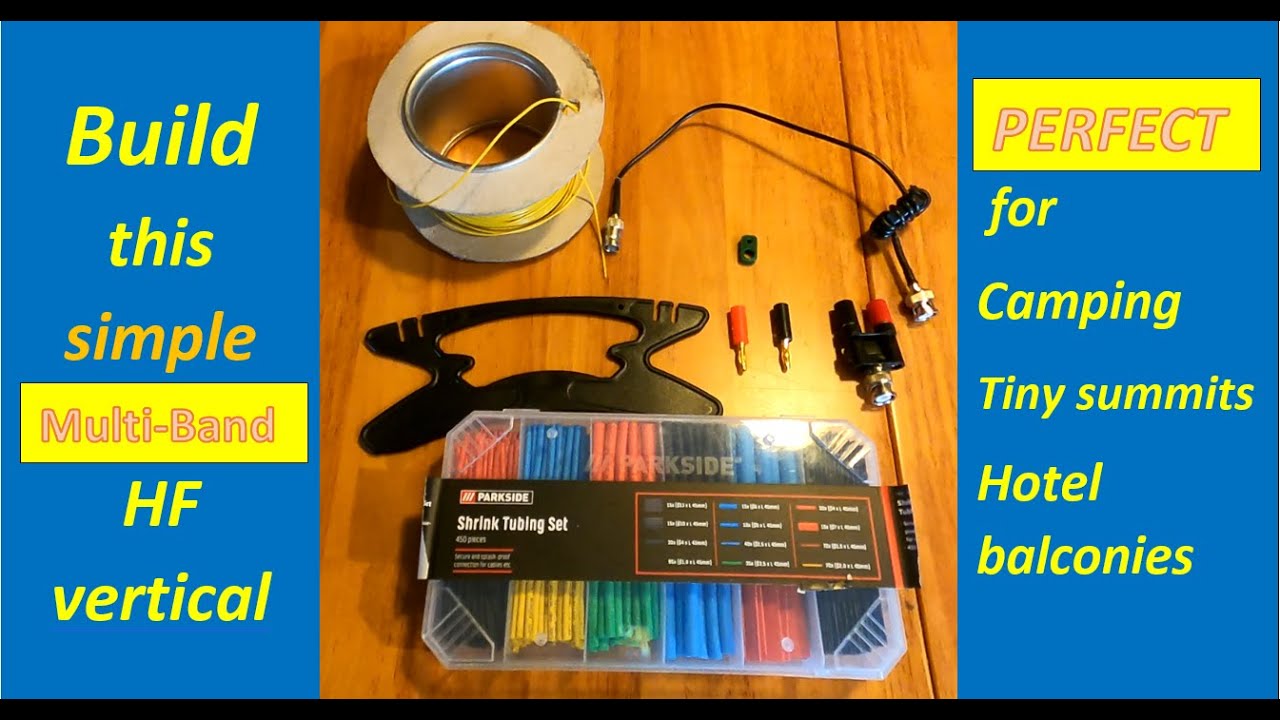

If you want even shorter there’s the 5.5m radiator and 2x 4.5m counterpoise, that matches 20m and higher frequencies with the KX2 tuner (a transformer is needed for 40m). The Xiegu G90 can match it on 40m and I have made many contacts with it on 40m even if it’s quite compromised.
It’s a nice length to put on a 6m pole and be a vertical - so no guying or pegging etc. of the antenna. Plus if you’re doing the PVC tube in rocks then even faster!
As seen on Fraser’s, @MM0EFI video - and he credits learning it from @GM3GAV Gavin.
