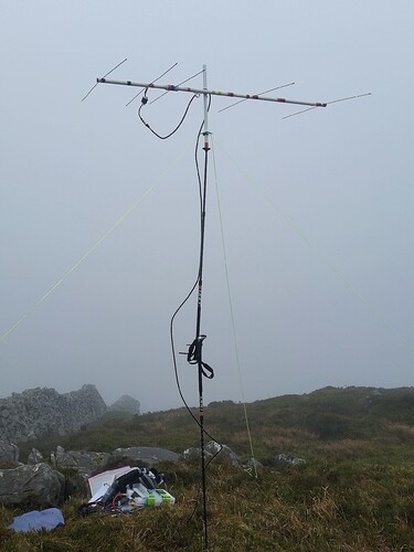

Steel? Steel? I now consider the swaged 25mm aluminium poles that I started with to be OTT. Some of us are making every effort to go the other way Omar. After Mullwharchar with Andy MM0FMF a couple of weeks back. I’ve decided to try leaving the poles in the car for the longer walks. My lightweight set up will be tested on HF soon. :grinning:
Walking poles with a homemade extension to support the beam at around 3m.
