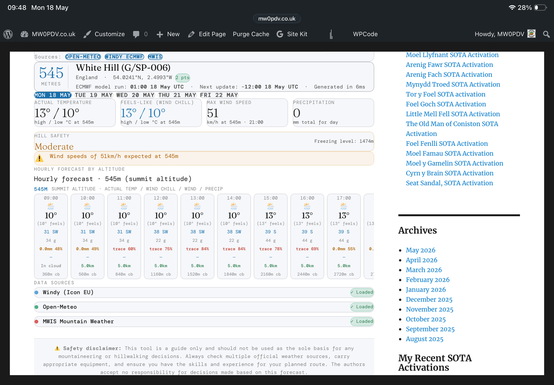

It’s predicting 15C dropping to 10C for the summit of G/SP-006. I’m parked up and it’s 7C. Also reckons virtually no rain today but it’s currently a little damp. So I’m not too sure about the weather models.
I messsed up the timestamps briefly when updating it to show toaday.
This is what it’s showing for today now
So thats now saying 10 deg c very fine rain I.e. Trace.
But its only a forecast :grinning_face: it would be interesting to know what the visibility is/was like.

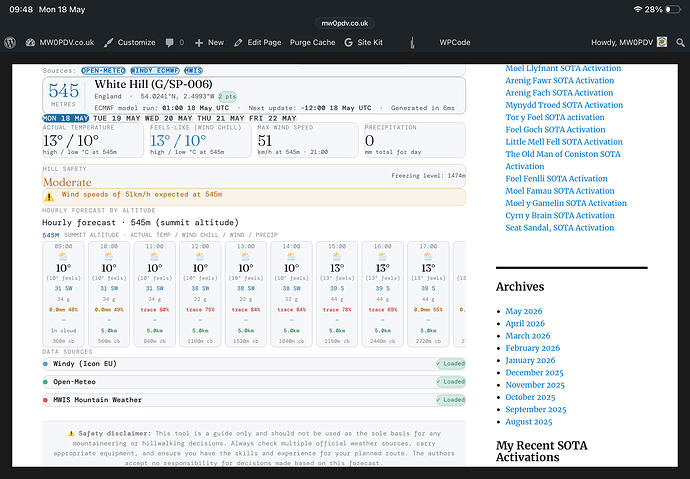

Here is a summary of how the weather data is derived, for anyone who maybe interested
SOTA Mountain Weather — How the Forecast is Derived

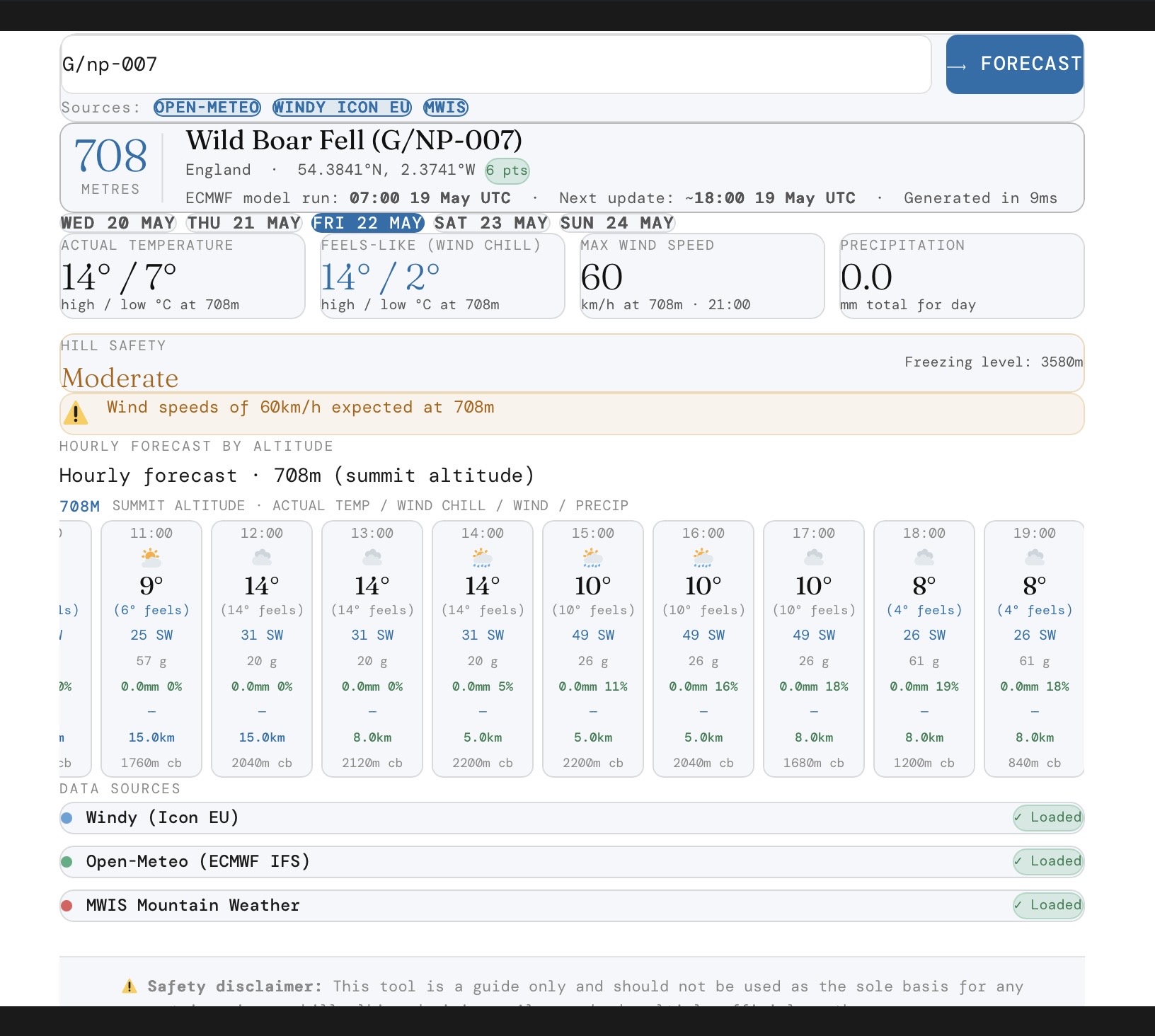

Still getting some weird forecasts. Looking at G/NP-007 for Friday the temperature jumps from 9C to 15C and then back to 8C. That seems unlikely. Plus the feels like temperature is 15C even though the wind is stronger.
The temperature jump does look odd, although a bit different on the latest model run, the wind chill seems similar to mountain weather.
I will keep a close eye over the next few days.

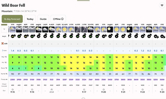

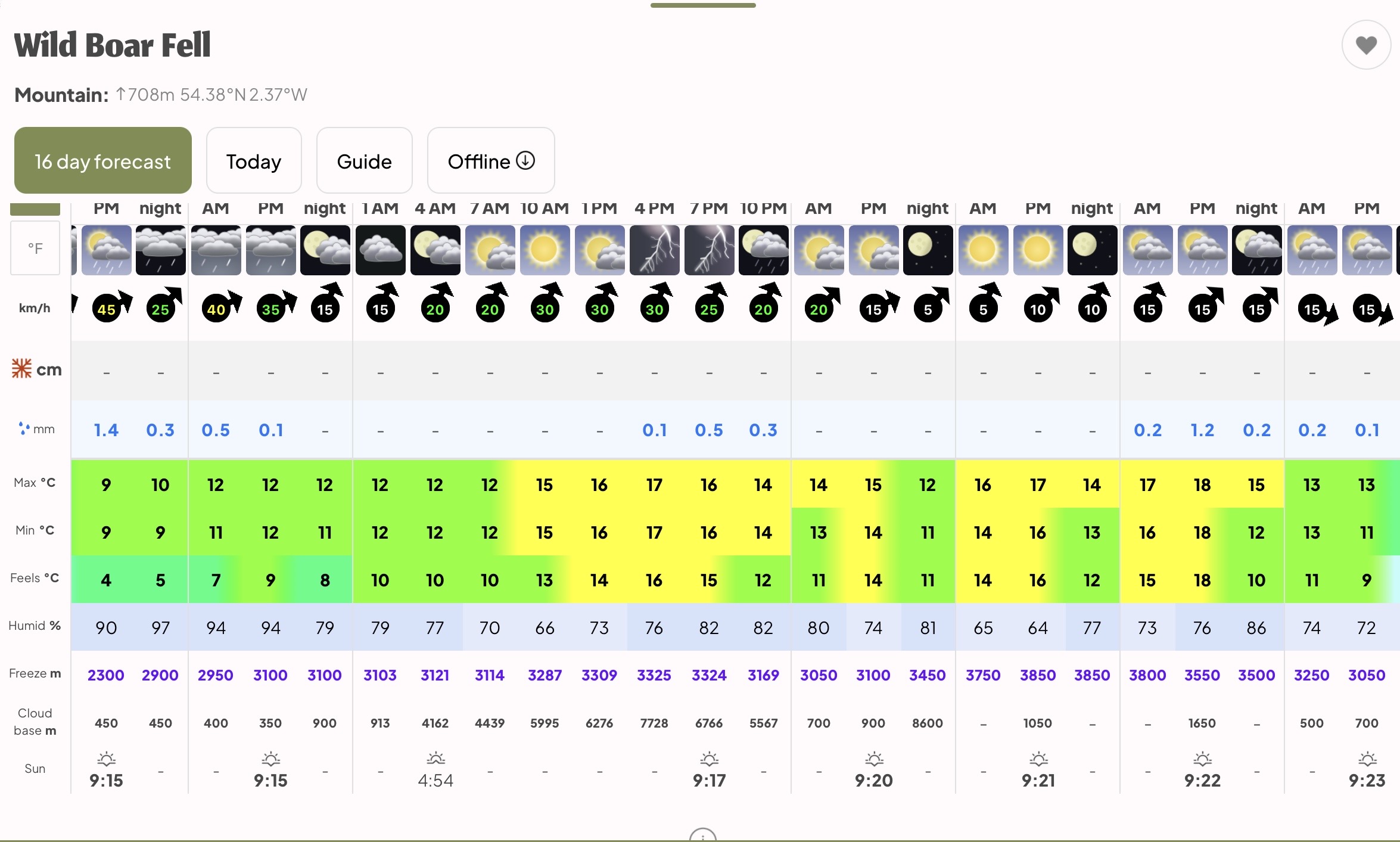

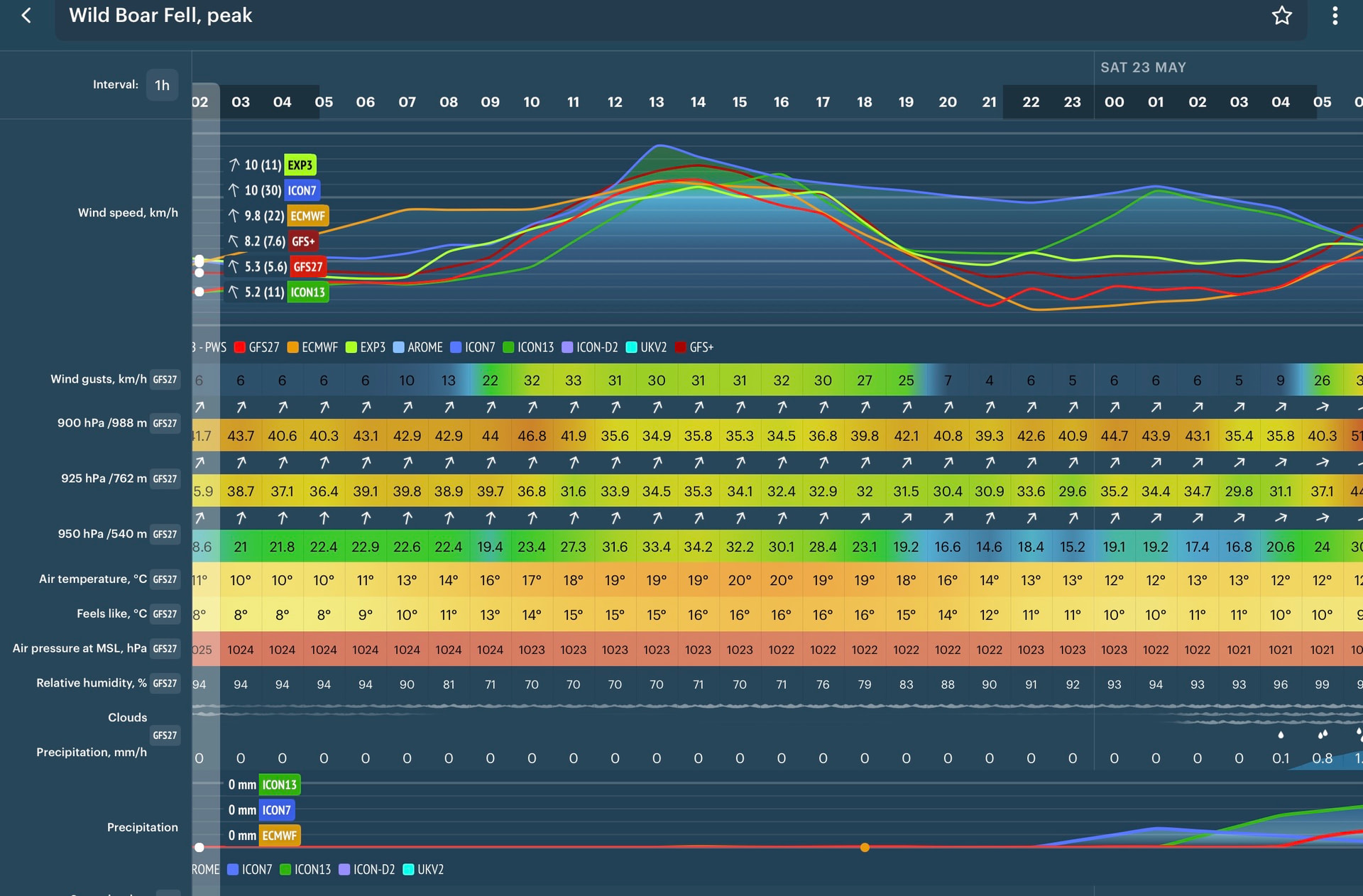

The following are from wind pro app and mountain weather.
Windy temperatures are at surface.

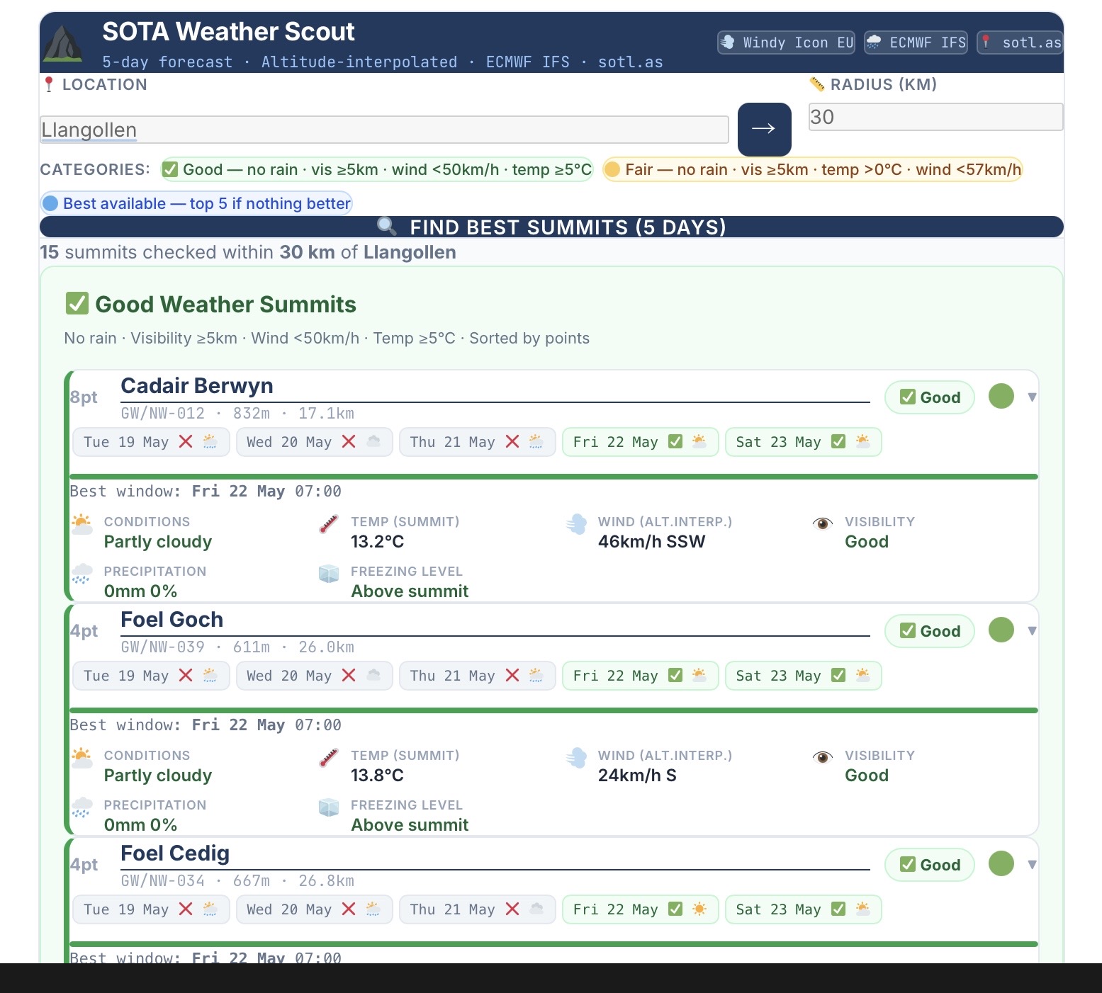

I have created another add on tool to the weather app, for a bit of fun only.
Inspired by this post while back by Paul G4IPB
Again designed really for the UK only. it’s only as good as the weather tool, so will likely have flaws.
It’s on the same page as the weather app, link above, if you scroll down the page.
It attempts to find the summits with the best weather over the next five days. It finds summits within a radius of a given place name, summit name or postcode. It’s sorted from highest to lowest points. It’s a busy screen so takes a big of getting used to.

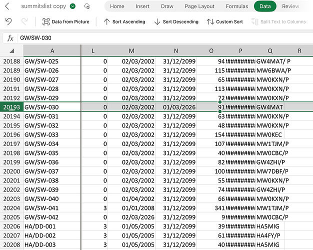

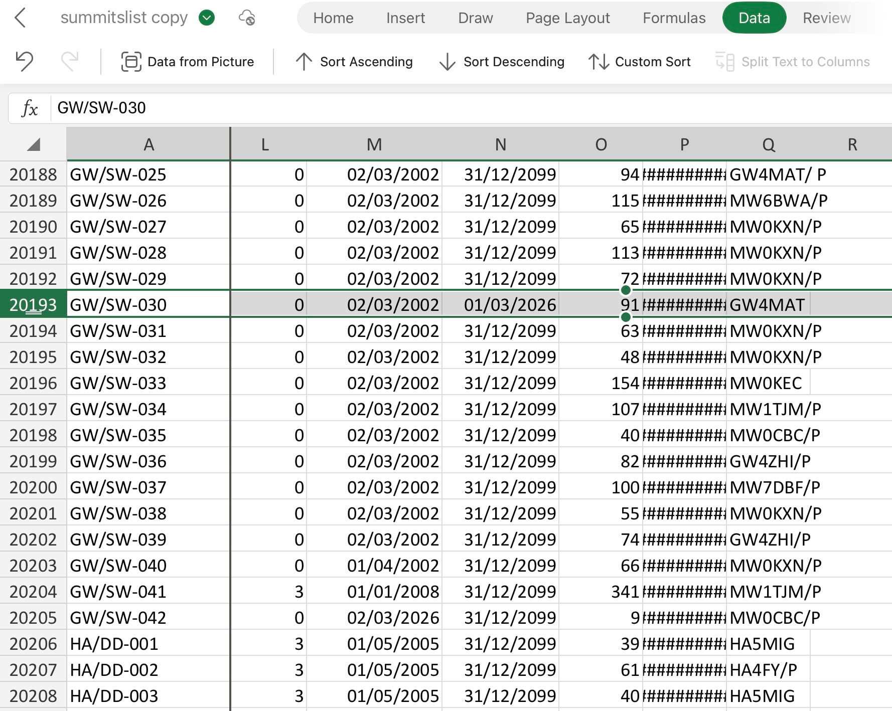

That’s neat but it’s showing deleted summits. Can these be filtered out?
Yes, I was being lazy, I just grabbed the full summit csv and stuck into a sqlite database. I never considered summits my not be active.
They may have been retired. i.e. end date < today’s date.
I must check (in the office today) I think summits added for new associations/regions etc. may be in the CSV and not yet active. i.e. start date > today’s date.
Had Claude fix it, should be working now
Thanks Andy
I can see recently retired GW/SW-030 and new GW/SW-042 with the respective dates. That the only ones I know from memory.
