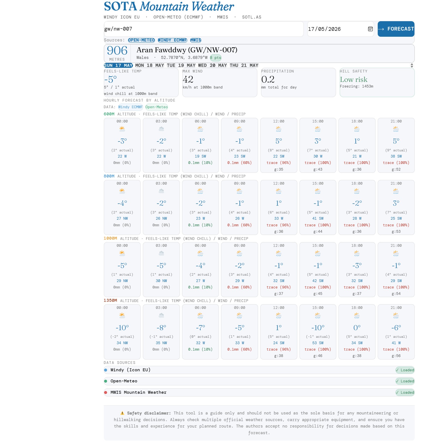

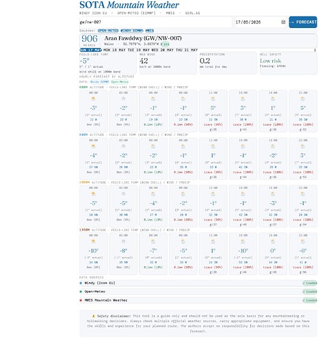

Now it’s experimental and only to be used for fun, but feel free to have a play with the SOTA weather tool. It’s only optimised for the UK and It is designed around what I want from a SOTA weather app. This may not suit your needs.
Spec Sumary
  • Summit lookup via sotl.as
  • Windy Icon EU for temperature and wind (pressure-level interpolated)
  • Open-Meteo ECMWF for precipitation, probability, weather codes, snowfall
  • MWIS for UK mountain area text forecasts
  • Wind chill as primary temperature with actual beneath
  • Freezing level calculated from pressure level temperature profile
  • Closest altitude band displayed (300m / 600m / 800m / 1000m / 1350m)
  • Hill safety rating based on your thresholds (48/70 km/h) plus freezing level
  • Precipitation probability colour-coded with “trace” for high prob/zero amount

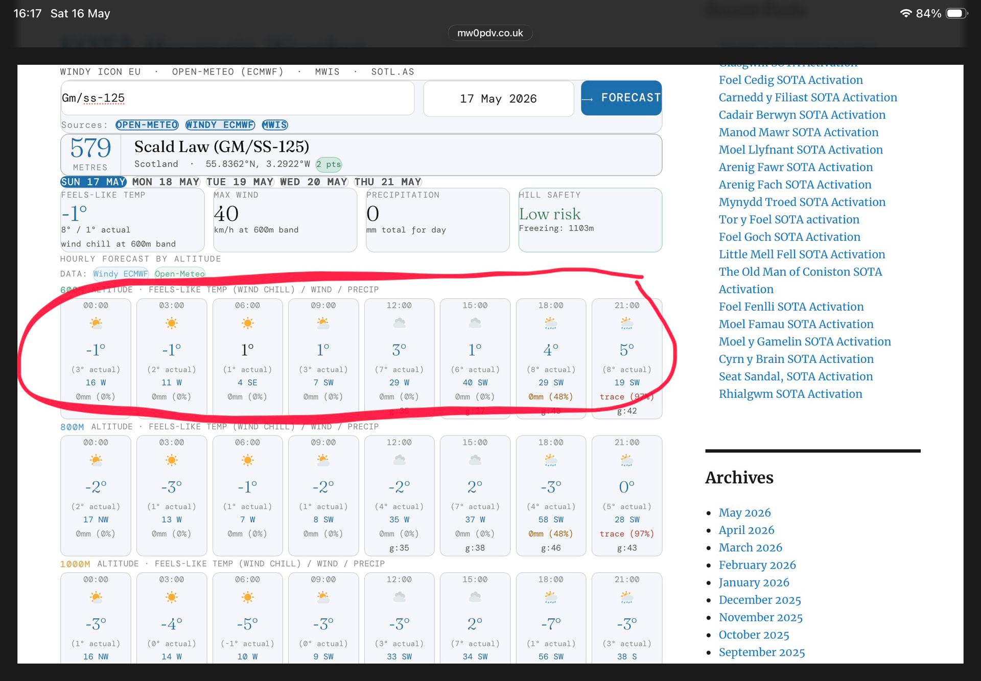

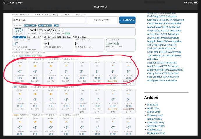

Is there an option to get lower ASL’s nearer to the summit ASL? Did I miss something?

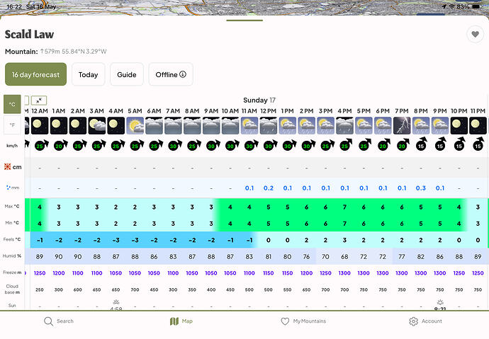

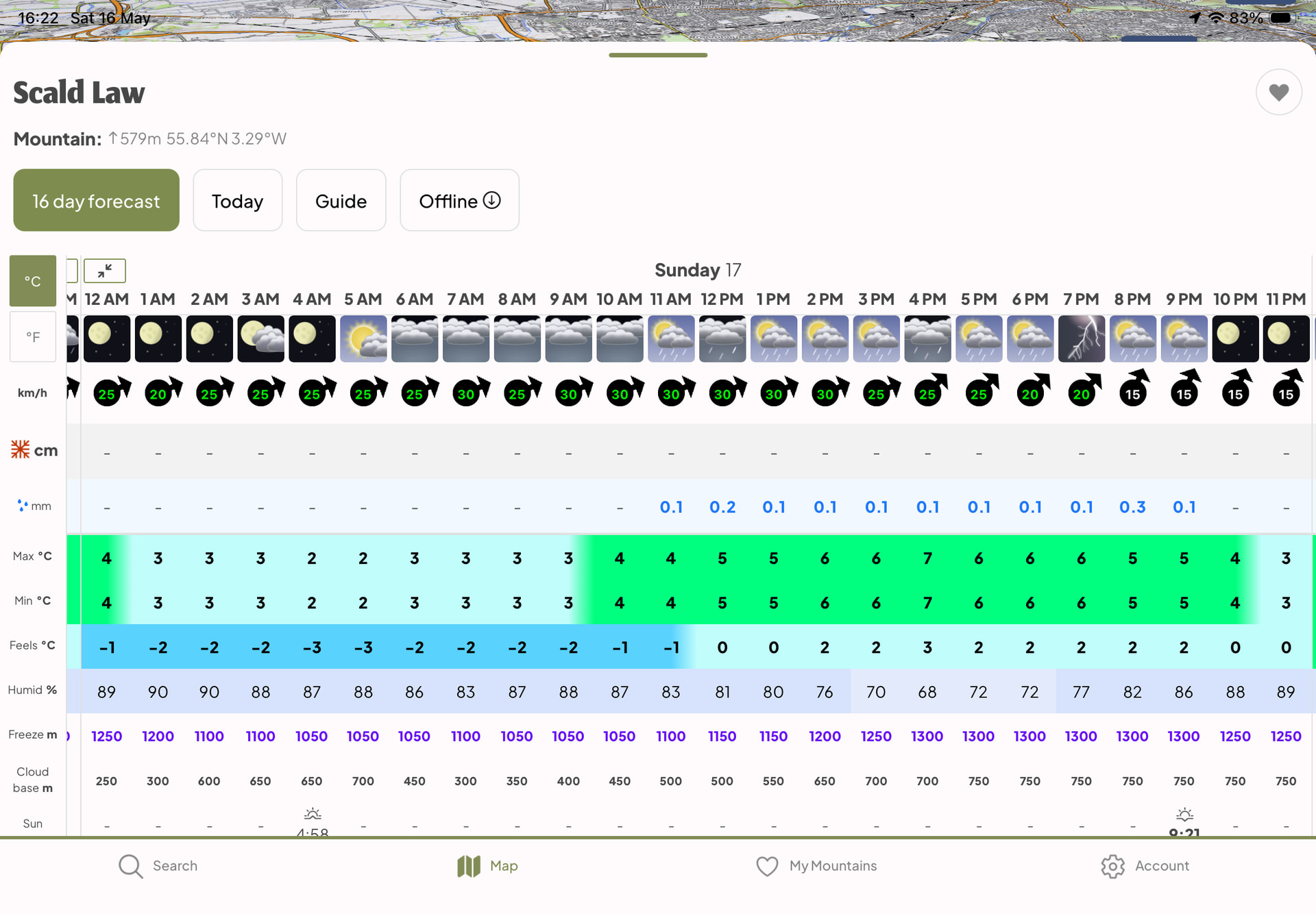

Claude would appear to be hallucinating. The forecast tomorrow for Scald Law tomorrow appears to be completely at odds to other forecasts. 50kmh stronger winds 15degs cooler temperatures.

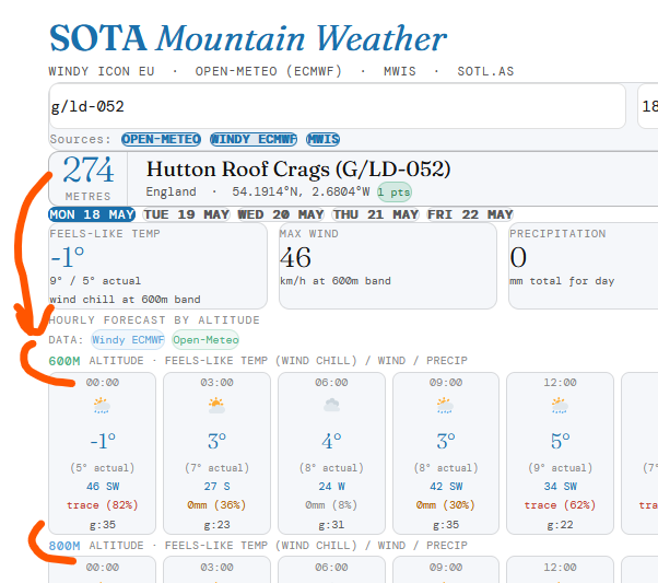

Currently I have set the lowest altitude as 600m, the summary uses the altitude band closest to the summit altitude. I can easily add a lower altitude band.
It not Claude :joy: it’s the old GIGO theory, the weather models I am using are the ones that I find most accurate. It’s pretty comparable to the Mountain weather forecast. This is exactly why I tend look at several apps and weather models.
The top summary are the extremes for the day, altitude band, in this case 600m is the useful row to look at.
It will be interesting to see how accurate this is. I looked at G/SP-006 for Monday and it reckons it won’t rain whereas the Met Office seems to think it might (although that’s for the area as they don’t have a summit forecast for White Hill.
Is there any need to give the weather at 1000m for a 545m summit?
I’d prefer the headline temperature to be the actual temperature rather than the feels like temperature. At the summit I will find shelter from the wind so the actual temperature is more useful.
For G/NP-028 the lowest weather it gives is for 600m but the hill is only 403m.

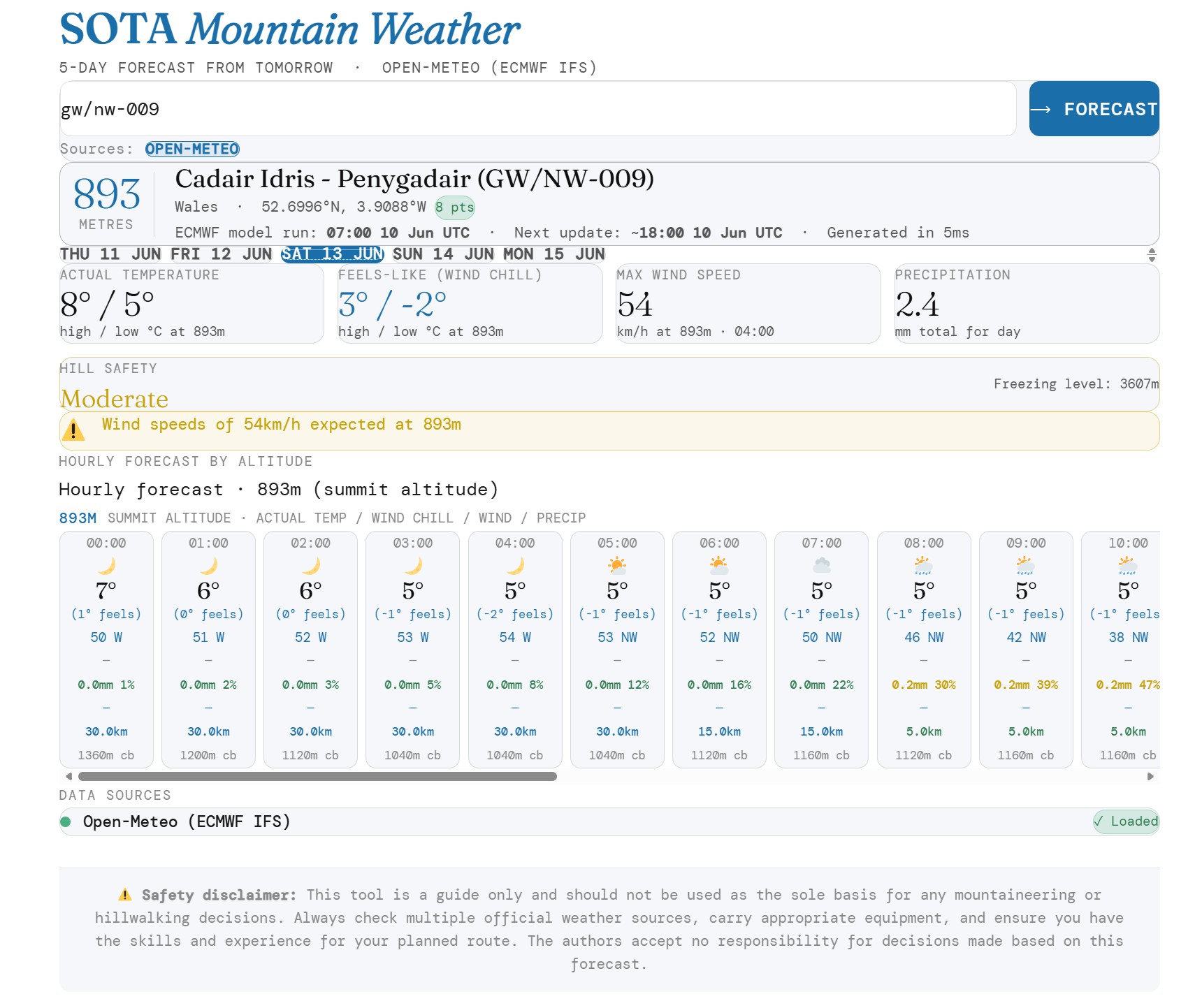

I have now added a 300m altitude.
I have now filtered the display to only show the altitude nearest the summit to avoid any confusion.
I.E no longer showing 1000m data for a 600m summit as its irrelevant

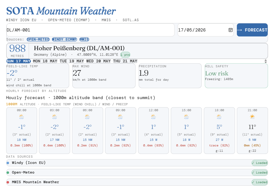

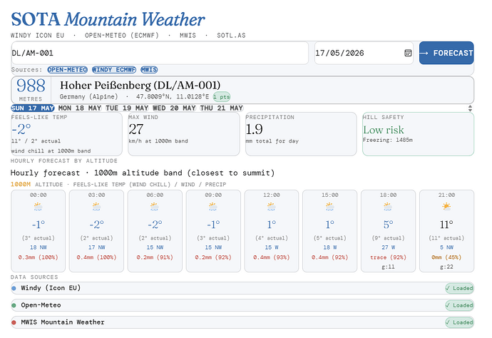

Yes working now thanks - actually I tried first a Lake District summit but then, even though, you said it was only optimised for the UK, I plugged in a German summit and it worked fine as well:
No, you are absolutely right, I have just removed the other rows. It was a bit confusing.

So for G/NP-006 I see a high probability for rain on Monday, but trace, this means, the amount is so small its rounded down to zero. So I interpret that as drizzle. Only time will tell, take an umbrella :smiley:
This was the AI explanation when I asked how can you have 0mm rain at 95% certainty of rain, hence opting a TRACE label instead of 0mm
That’s the same model disagreement issue as before but more extreme. A 95% probability with 0mm means Open-Meteo’s weather code and probability model is very confident it will rain, but the precipitation accumulation model is predicting less than 0.05mm — essentially a trace amount that rounds to zero.
This is a known quirk of how Open-Meteo blends its models. The probability comes from an ensemble model that votes “yes, rain likely” while the deterministic precipitation amount rounds down to zero. In reality if probability is 95% you should treat it as rain regardless of the 0mm figure.
