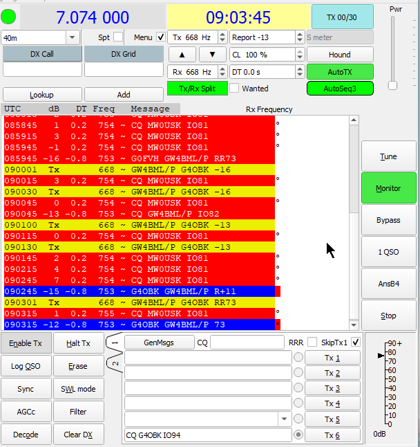

Struggled to decode Ben @GW4BML/P
I struggled to decode Ben @GW4BML/P on 7074 KHZ +753 HZ as MW0USK was much stronger with the same skip condx on +754 HZ but we completed in the end! Thanks Ben.

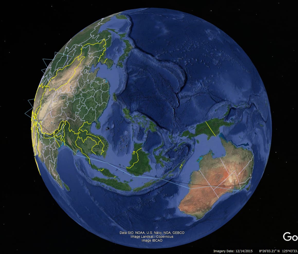

I worked several SOTA stations including yourself on 20 m FT4. I assumed that it would be short path but late in the session I turned the 2 ele beam and found I should have stuck with long path. I lost a few dB but fortunately (?) the beam has a poor F/B.

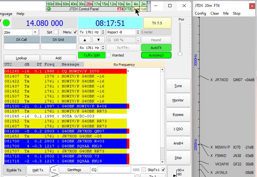

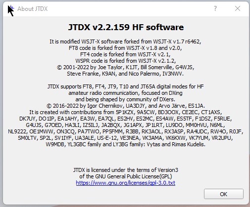

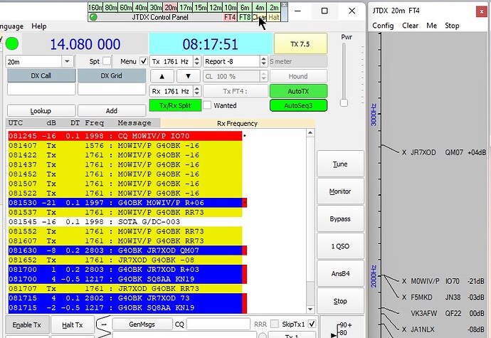

Hi Phil,
Just got JTDX installed and running - I was wondering how you get the RH side-window, the one showing a vertical strip of band activity, to show? Also the colored band buttons at the top of the window??
Using v2.2.159-32A.
Thanks, Rob

Hello Rob
The Band Map is generated from my fab logging program Logger 32 by K4CY. This makes any MGM programme WSJT-X or JTDX for example so much more effective by displaying wanted band contries and providing lots of other options. The band map isn’t available unless you use the UDP function in Logger 32 which links via software to the operators log. I think other logging software may also provide similar functionality, (Log4OM etc) so wonder what you use for logging Rob?
73 Phil
PS The version of JTDX I run is v2.2.259r6462

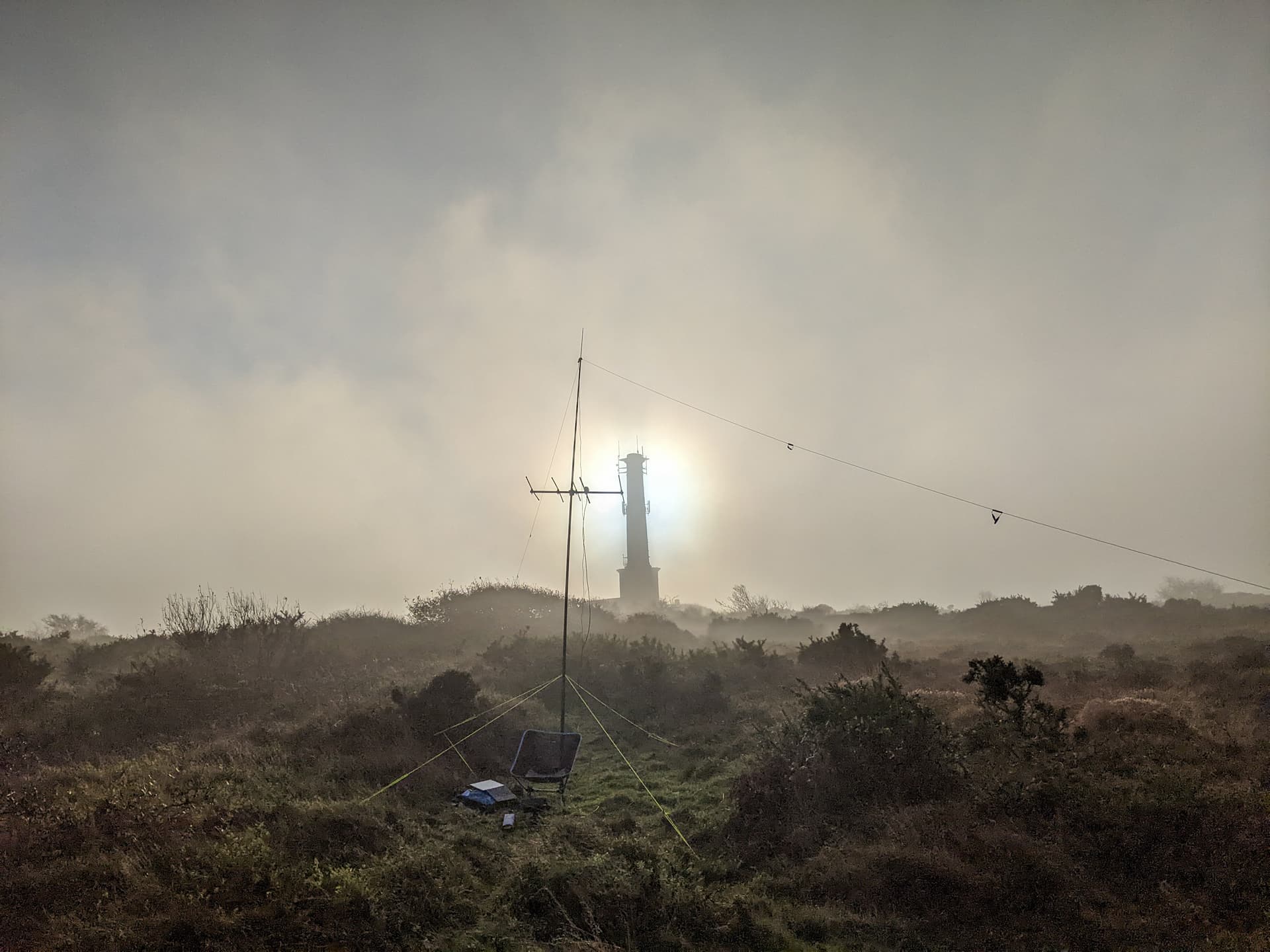

ScreenHunter 68
That was an interesting morning. I activated Kit Hill G/DC-003 which was covered in cloud when I arrived but the sun eventually burned it off. This photo shows the sun behind the old mining ventilation chimney which sits on the top of the summit.
A total of 29 QSOs were made in just over an hour including two S2S with DL6DBN/P and M1EYP/P. All but one of the QSOs made using FT4 with the exception of one on FT8, which I tried very briefly. Equipment was IC-705, SB linked dipole for 20/30/40m and an MS Surface Go 2 tablet (with BT keyboard) linked by WiFi to the 705.
20m was the most productive band with a QSO with Ron, VK3AFW at 0818 UTC the surprise of the morning. Later I discovered the QSO with R9GB was also DX as they are a long way east, just above Mongolia. I tried 30m FT4 without success but 40m FT4 was successful.
I had set a Tx Macro into WSJT-X with the SOTA reference. I tried using it once but the problem was it wasn’t sending 73 afterwards so the QSO was not being completed. Most of the QSOs were completed very quickly but my QSO with Tom M1EYP/P was very protracted and I must have sent RR73 7 or 8 times before he heard it and replied with a 73 to complete.
It was colder on the summit than I was expecting so I didn’t stay beyond 1000 UTC. In the last 20 minutes I tried 2m FT8 but unusually I couldn’t find any activity. I spent a little time on 2m SSB but without success. I was hoping to see a 2m SSB spot from Pom DG7ACF/P but his activation must have been delayed and with the cold starting to get to me I packed everything away.
Many thanks to Tom M1EYP both for the QSOs and suggesting this event.
As an aside, when I got home I used ADIFMaster to edit the adif file created by WSJT-X to add a new column with the S2S SOTA Reference. This seemed to upload to the SOTA database without problems.

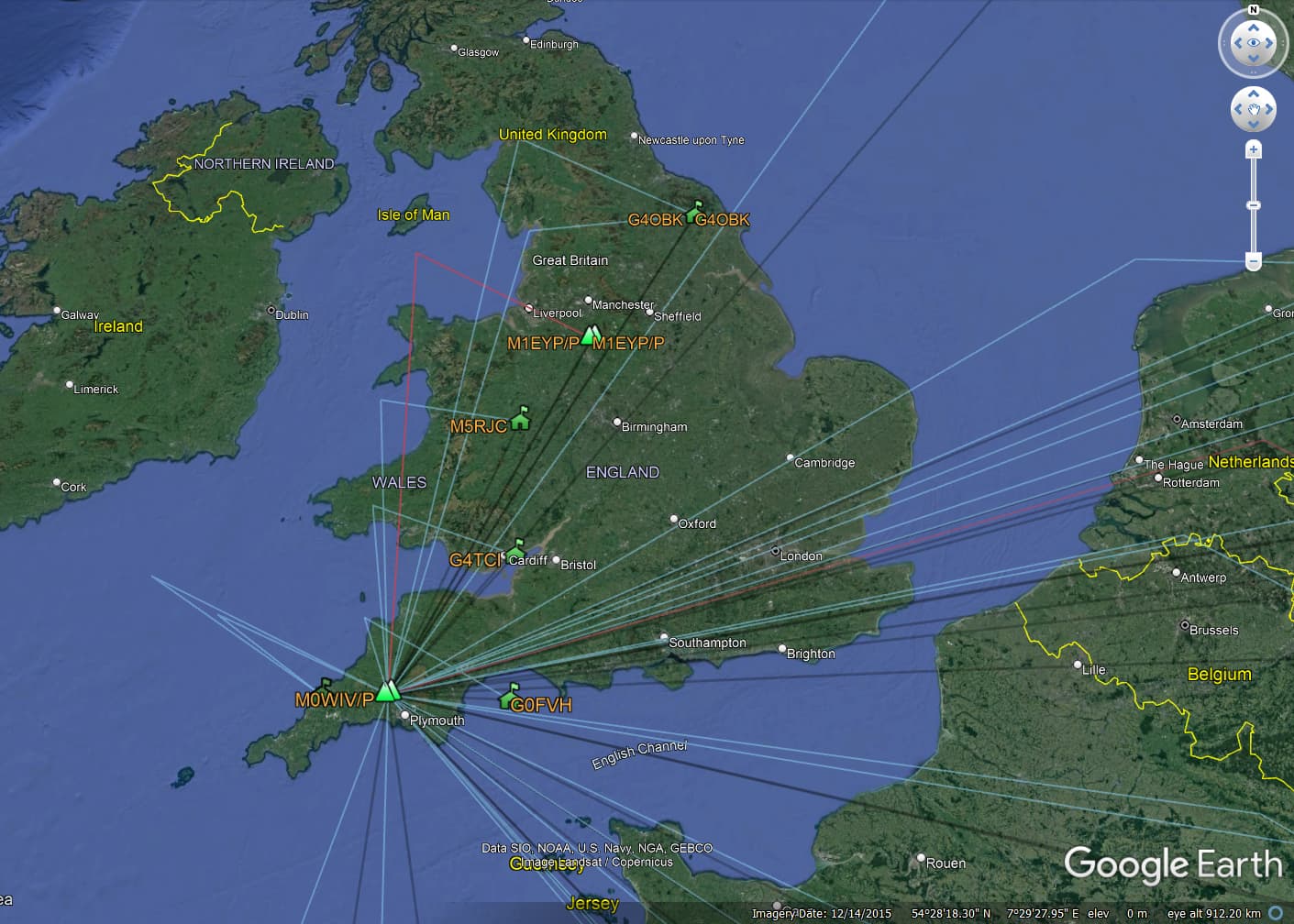

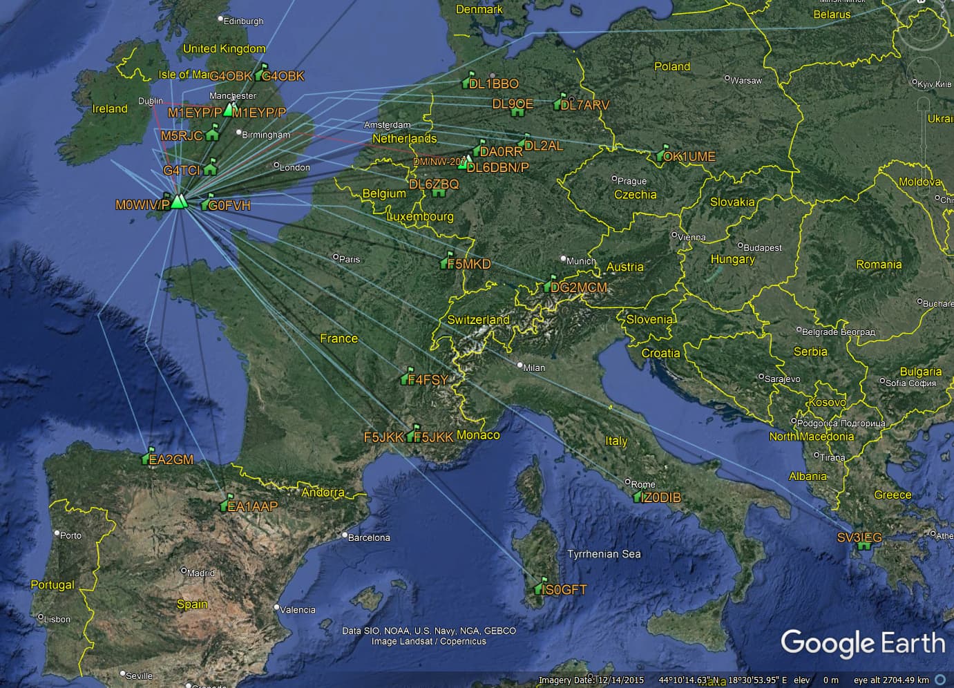

Maps of the QSOs.
Hi Phil,
Thanks for the tips - I had been using N1MM logger, but have not used it in some while. I’ve just now downloaded, installed and configured Logger32 and, after a few hiccups and very well guided by the excellent Logger32 help PDF, was able to get that band map working here also in tandem with JTDX. A really nice addition!
Thanks again, cheers, Rob
Great stuff Rob well done! I know you are a very IT literate guy (SOTAMaps was built by you as most of us know) but many people are put off by the initial complicated appearance of Logger32 when they first download it (Free of charge even better!) and give up on it. You have done well to get it working so quickly OM. It does all sorts of station management stuff, I think I must have been using it now for nigh on 20 years and have followed the changes on the Logger 32 reflector, which is well worth joining, for suggested solutions should you get stuck on anything, however most things can be got working by studying the 908 page PDF manual!
