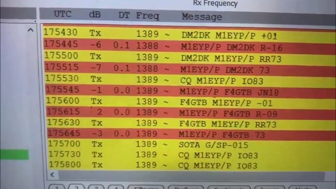

I’d love to see your attempt Fraser. I tried it back in 2021 & found that you need to be prepared for it.
i.e. Have several custom messages pre-programmed (such as the summit reference, maybe a couple of others such as “TU SOTA” etc).
Note also that your locator (sent when calling CQ) will be different…not sure how many people would be bothered about that.
I also got caught out with the callsign as I went over the border into Wales. The first couple of calls it sent out M0GQC (as if I was at home) as opposed to MW0GQC/P…I corrected that fairly quickly before it caused too much confusion!

That’s not an issue James.The locator can be set manually in the software, via a GPS dongle, or even read from your phones GPS.
I must have missed those videos when they were released. I consider myself comprehensively reprimanded!!!
Sending the locator grid is a problem in my experience when you have a “complex callsign”. For example, I’ve used the callsign M0WIV/P from a SOTA summit using FT8 but the system didn’t send my grid, only the callsign. To get the grid sent I had to use my basic callsign of M0WIV.
Sending the summit reference is also a challenge. In theory you can use a Tx macro but I’ve found this hard to do in an activation using a small screen.

No problem using /P and still sending the grid - again, see the video above.
