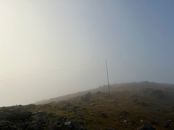

Moel Siabod? I would have loved to complete this summit completely on VHF! I activated it back in 2016 on 144 MHz FM.

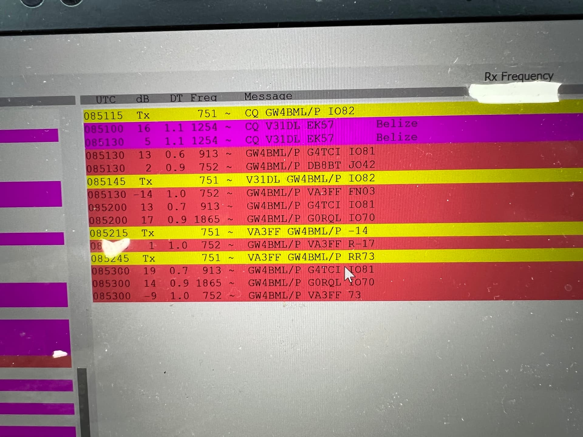

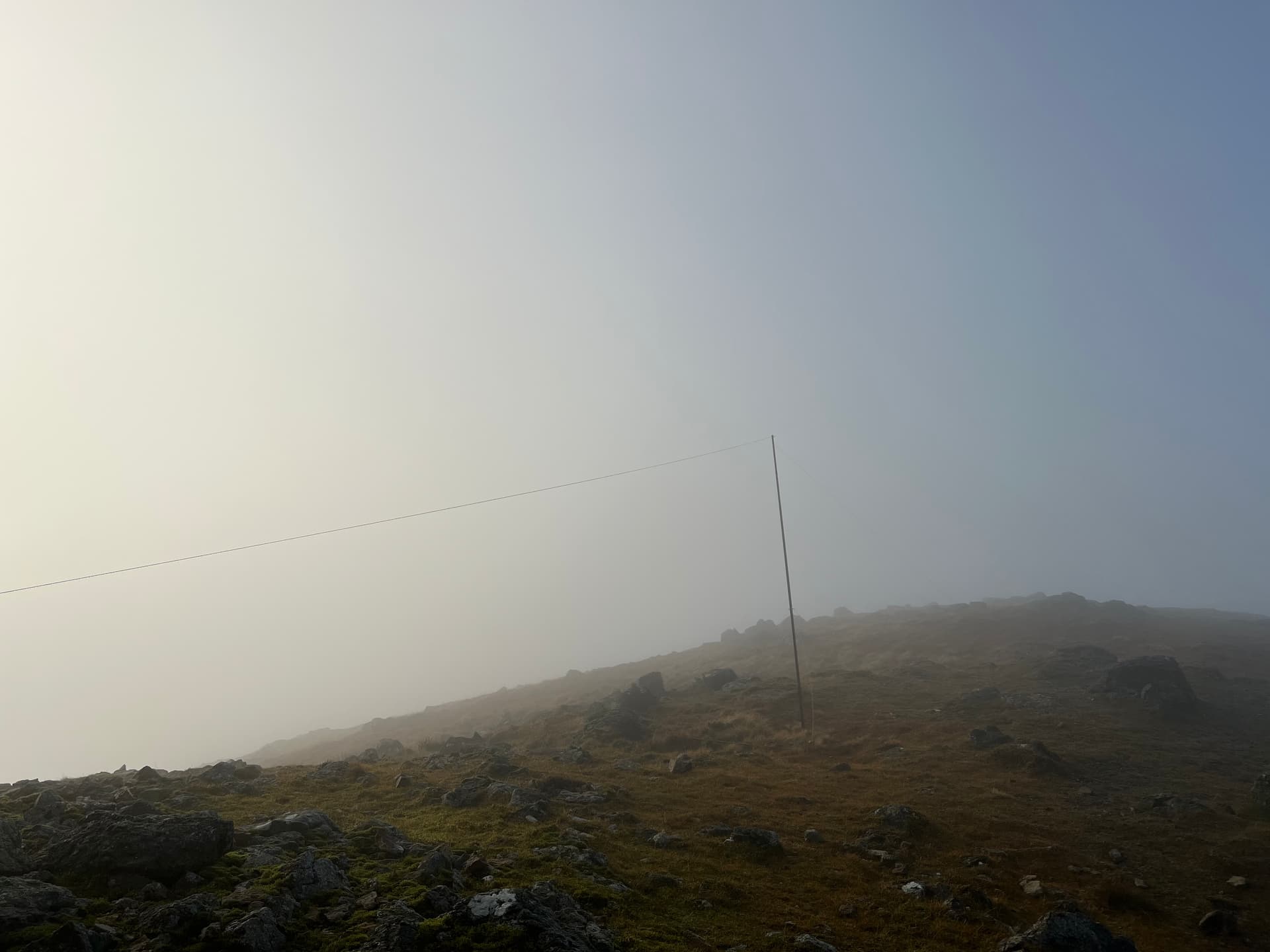

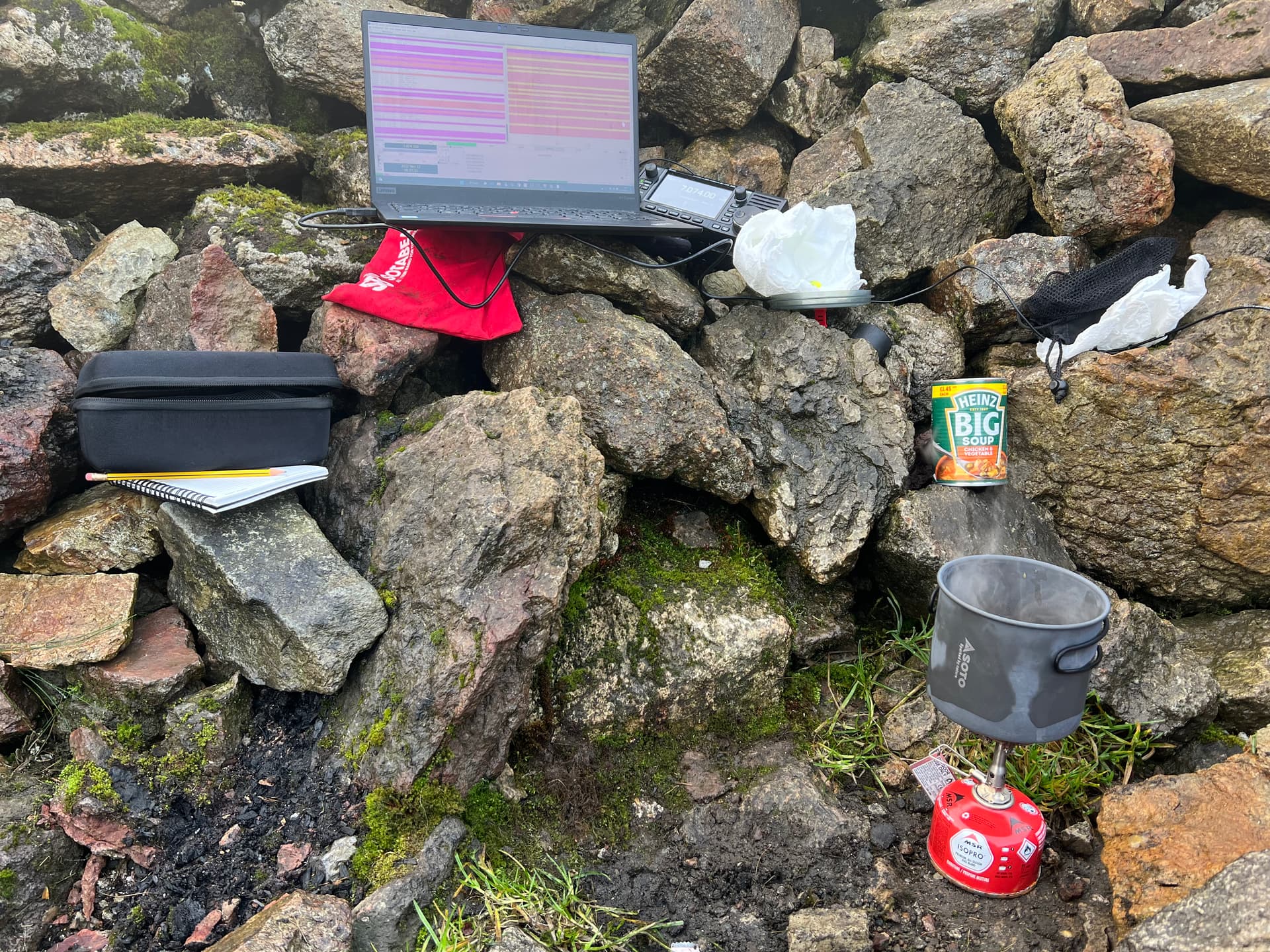

It was great to make contact on FT8 @G4OBK Phil. I packed my laptop, mini USB and icom 705 as well as the KX2 hoping I could configure this on summit - in the mist and freezing cold :rofl: I made great use of the Cairn to shade from the cold wind!
Once I’d sorted my snapped 6m pole out on summit due to the heavy wind, I worked 60/40/20m SSB on the KX2. I then started setting up my equipment on summit for data modes, and to my surprise it worked and my second contact was Canada :grinning: I then had a red screen of a major pile-up. It’s not my cup of tea, but I will deffo have another go because it resulted in me having no issues making my soup for breakfast! hi!

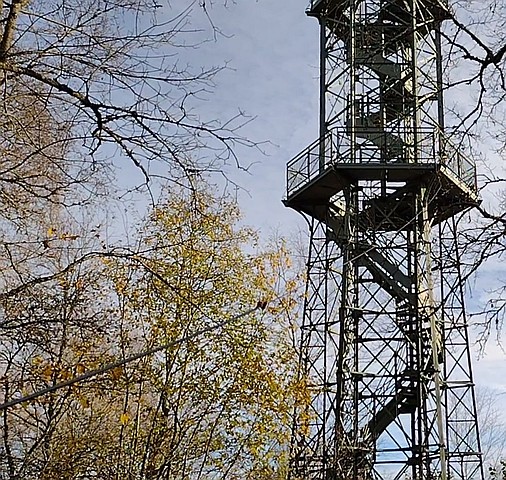

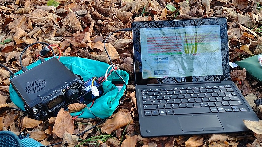

On top of the hill is a steel tower and I fixed one end of my EFHW in 9 m height, the other end was tied around a tree, so it became a sloper. As this wasn’t my first DATA SOTA activity, setting up the rig and calling was fast and no problem. Number 1 in the log became @M0WIV and the last of the 21 DATA contacts was @M1EYP who got me on SSB a few minutes before. FT4 was no problem on 20 and 30 m, but on 40 m the QRG was crowded by strong RTTY making it impossible to decode any of the faint signals I could see on the waterfall. So I gave FT8 a go on 40. When no more stations came back to my CQ I changed to SBB on 20 and 40 for half an hour, to give those chasers a chance for DM/NW-207 too. In the end I had a total of 42 QSOs in the log.
Conclusion: DATA FT4/FT8 is always worth to try, the 1.3 kg plus for the tablet with interface are managable. One can catch random contacts and real chasers, as it was this time too. As long as carrying DATA rig isn’t common, it might help to announce DATA activities on SOTAwatch an this reflector as well to animate others to pick the gear and get more DATA S2S. Thanks Tom for your idea and initiative.

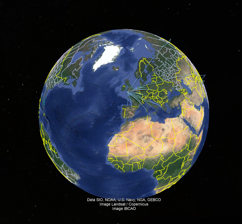

What path do you think the signals from Europe took to reach you? I was using a dipole orientated NE/SW and that seemed to work but is there a better orientation?
John
Hi John,
About 130 to 160 degrees, LP from here. It varies with where in EU the target is. So for a dipole it needs the wire to run NE SW roughly, as you did.

Apologies, I’ve just double-checked and my dipole was NW/SE not what I said above. I was getting disorientated. :slight_smile: However, this seems to make more sense as from what I’ve read the long path to VK from here is across the Atlantic via the Azores and over Brazil. This Google Earth image plots the short path to you going across Europe and over the horizon at about three o’clock. The opposite way is over the Atlantic and across the top of South America.

Hi John,
You are right to use a globe. The Cartesian maps are misleading. You want the Great Circle bearing. You can find a calculator on line or use a piece of string on a globe.
For LP UK I beam South South East and the signal goes over the southern part of South America and across the Atlantic. The path skirts by the South Magnetic Pole.
SP is pretty much the opposite bearing.
If your antenna is an inverted vee then the combined V and H pattern will be more symmetrical.
It seems that you may have more choice of wire orientation in the UK than in VK3. The gum trees and tracks can limit our options.
