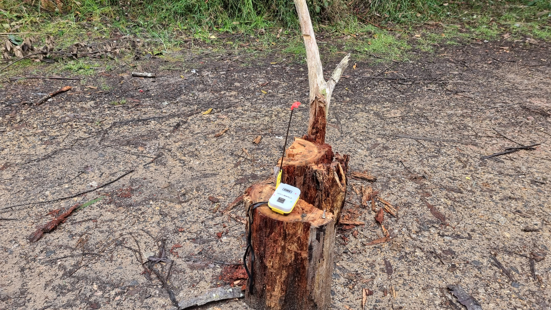

While waiting for the rain to clear I decided to test my Personal Locator Beacon, PLB. This is something I should do every couple of months, but I hadn’t done since I purchased my second PLB in August 2024. I downloaded the PLB manual to my phone and read the test procedure by which time the rain had stopped. Stepping away from the car I ran the full test, that includes RF and GPS testing, and the test failed. I re-read the instructions to be sure I had done it right which I had and, as detailed in the instructions, I repeated the test and it passed.
Comforted by the knowledge that if it all goes south, I can summon help, I packed my backpack with FT817, amplifier, batteries, tarpaulin, hourglass antenna and, for its first activation, a dual hourglass antenna.

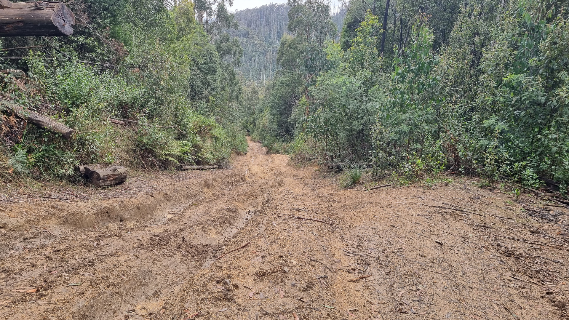

The summit is named Gentle Annie, but there is nothing gentle about accessing Gentle Annie.

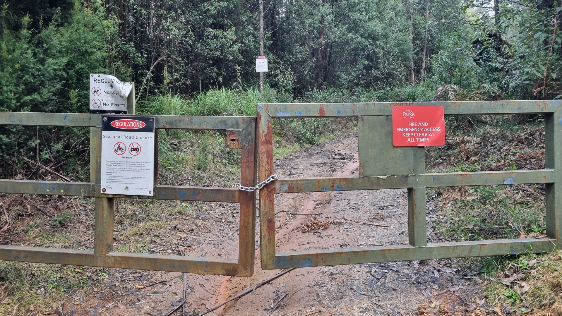

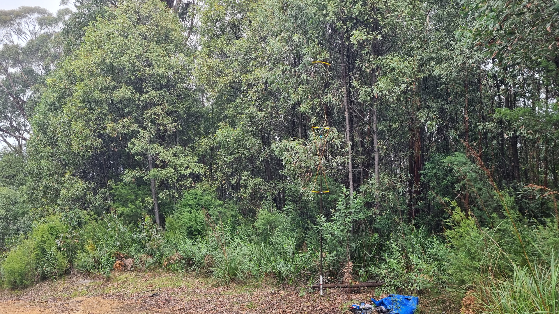

The journey to the summit starts at a seasonally closed gate. These gates are common in forest and park areas in Victoria and are locked from mid-June until early November. The idea of closing tracks through the winter and spring is to stop them being damaged.

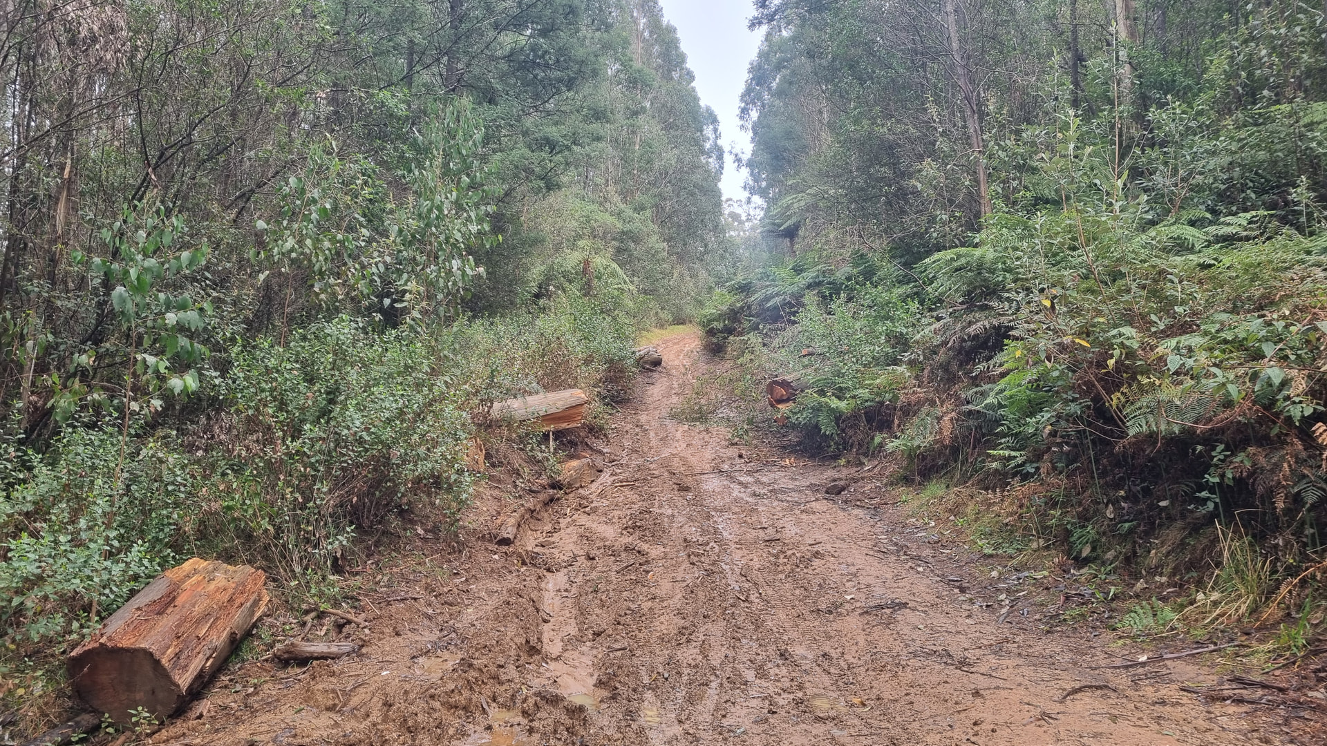

I have activated this summit seven times before and only once, in 2014, has the track up not been a rutted or churned-up mess. In 2014 I found the track had been repaired and graded a couple of months earlier, and I was able to drive my 2012 RAV4 AWD to the top. Today it was a challenge just to walk up the muddy track.
The track starts at about 450m ASL and rises to 687m ASL with some sections being steeper than others. With my hiking poles and new boots, I was able to make the climb, and descent, without slipping over in the mud.

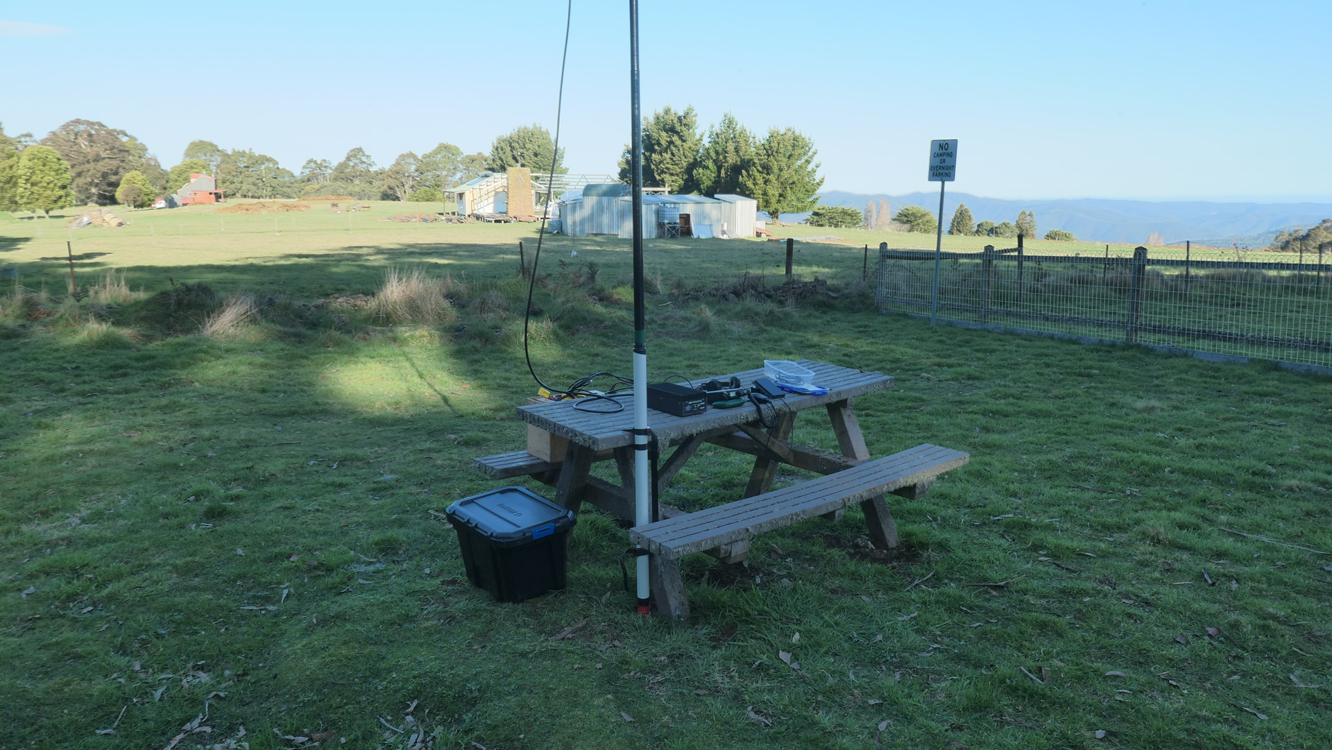

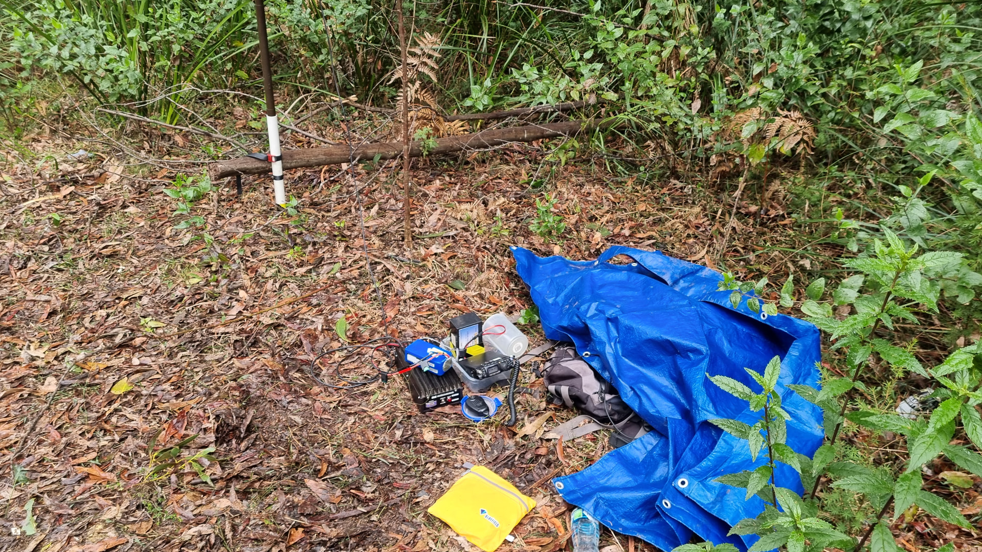

After reaching the activation zone, about 20 minutes before 0000 UTC, I set up my 6m pole with the dual hourglass antenna along with the FT817 and battery. Normally I lay a tarpaulin on the ground and then set my station on top, but today, I just set up on the grass and kept the tarpaulin for sheltering under.
I managed 6 QSOs before UTC rollover and 15 QSOs after rollover. Geoff @VK3SQ was keen to work me, so I added the amplifier and second battery to the setup, but we were unable to make the QSO.
While calling Geoff I noticed the FT817 was showing less than 12-volt input from the 7Ah LiFePO4 battery during heavy modulation. I haven’t seen this before with this battery that I have been using since August 2022. This raises two possibilities, the battery is staring to fail, or I had not charged fully after it was last used. I’ll load test it during the week and see how it performs.
The rain was intermittent and after about 1 hour on the hill I decided it was time to head back down to the car.
Due to the poor weather conditions, I was unable to compare the performance of the two hourglass antennas, however I did confirm that the dual hourglass antenna works.

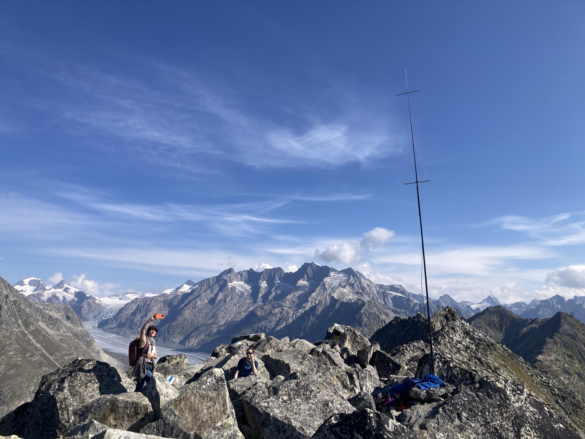

For 2 m I had brought the Single Hourglass Antenna. I wasn’t sure how much space would be available at the summit or how crowded it would be, so I wanted something that could be set up quickly, occupied little space and was not more conspicuous than necessary. Although, admittedly, even the SHA attracts enough attention on a busy summit.
I started the activation at around 08:00 UTC. The Global Mountain Activity Contest was in progress, so there was certainly no shortage of signals on the band. I could hear several stations, but calling them resulted in zero replies.
At nearly 2900 metres a.s.l. one might expect an excellent VHF location, but Bettmerhorn is surrounded by considerably higher mountains, so the take-off is not nearly as good as the altitude might suggest.
Eventually I found an Italian station and was able to work him - the only QSO on 2m SSB in the log. But hey, one was enough and it was across 318 km :slight_smile:
So not exactly a big log, but I was very happy with it. Carrying the VHF equipment to the summit had definitely been worthwhile.

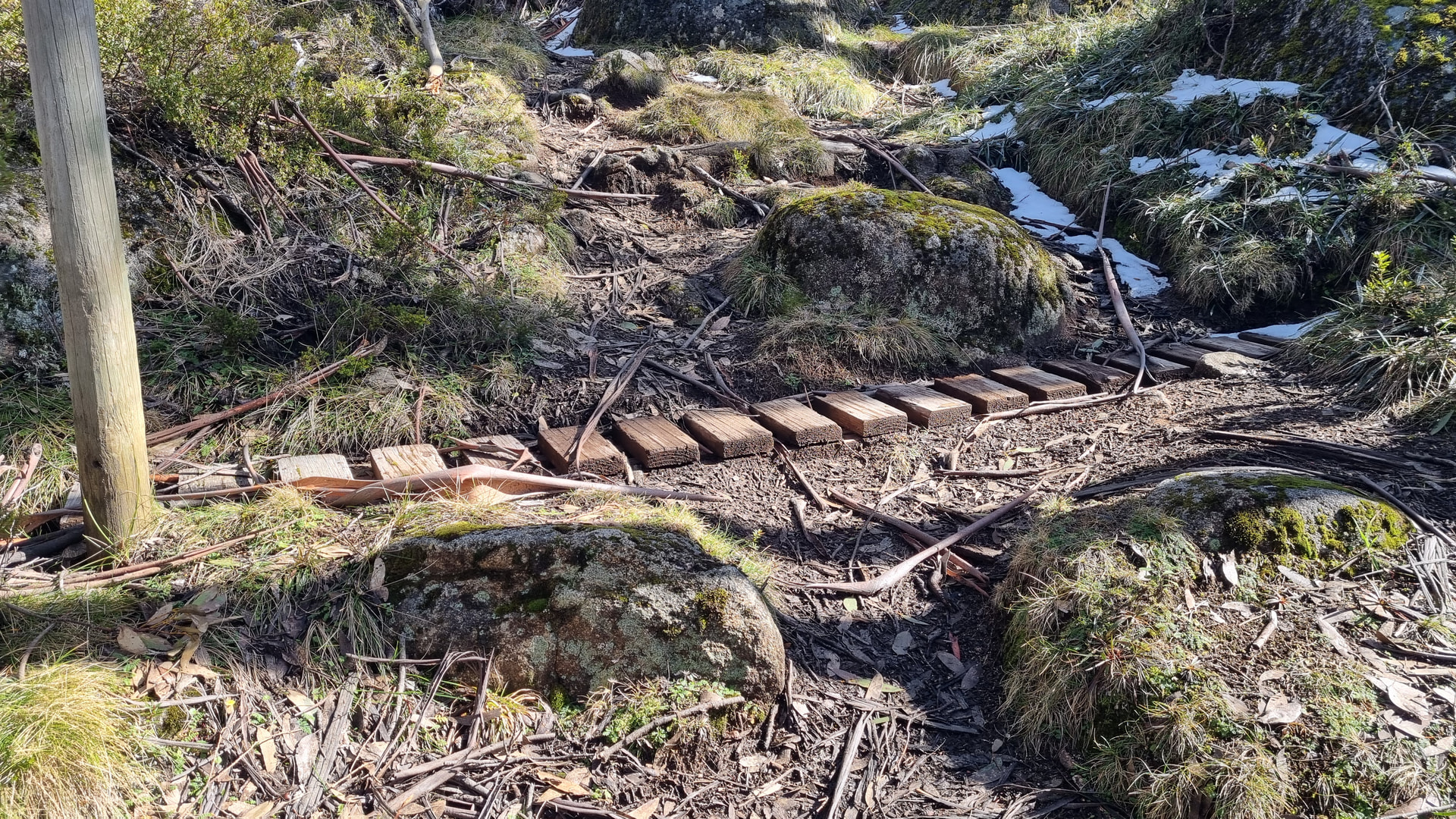

Along the trail are many wooden drains placed across the track to trap water running down the track and divert it to the side to reduce erosion of the track.

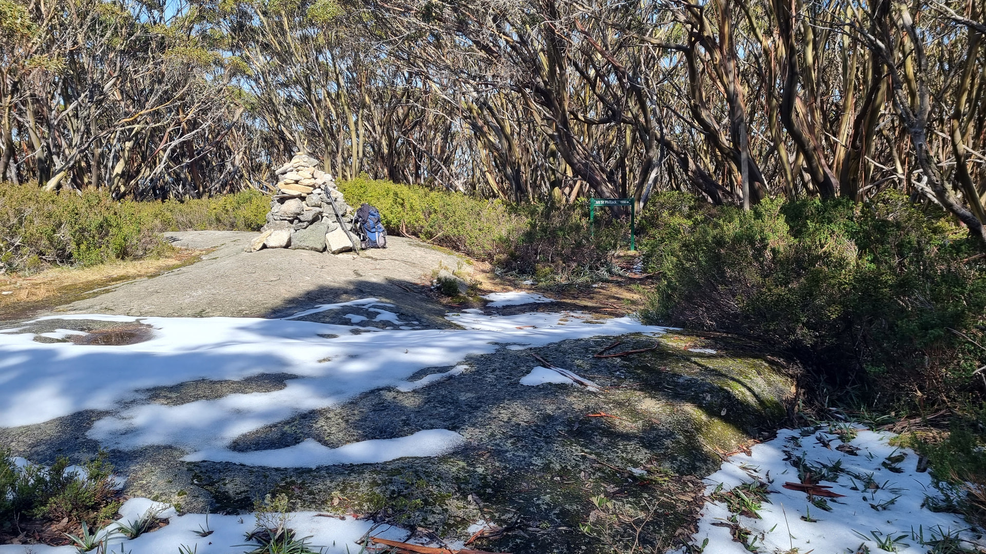

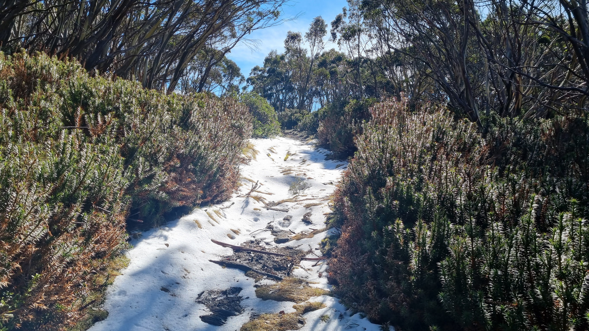

As I hiked up to Mt Saint Phillack there was more snow appearing on and beside the track and my arrival at the summit revealed a large patch of snow.
This was good to see as it fulfilled one of my SOTA goals for 2026 Your SOTA Goals for 2026! to activate one summit with snow in the AZ.
The hike from the car park to the summit took 1 hour 54 minutes. Back in 2013 it was 1 hour 24 minutes. In 2025, starting at Baw Baw Village, Glenn and I made the journey to the summit in 1 hour 35 minutes.

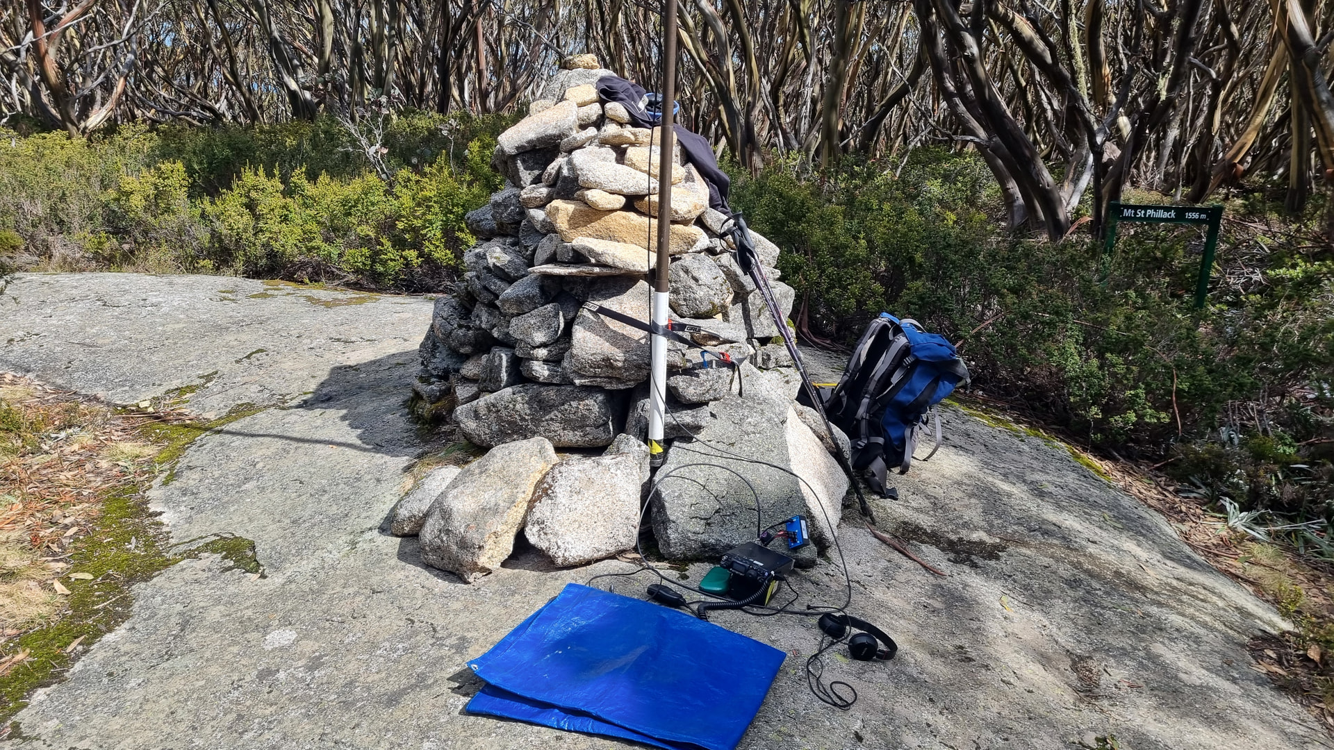

Today I only worked on 2m SSB. The station was FT817ND and the antenna was a double hourglass supported by a 6m pole. I posted my first spot to SOTAwatch at 0046z and logged Geoff @VK3SQ, 162 km away almost immediately. A steady flow of QSOs followed for 20 minutes including David @VK7DC, 364 km away in Tasmania.
After about 1 hour, when my CQ calls were going unanswered, I tuned some of the beacons and changed the antenna to a single hourglass to make an unscientific comparison between the two antennas.
Based only on perceived audio improvement both the VK3RGI Mt Carrajung and VK3RED Donald’s Knob beacons sounded stronger on the double hourglass.

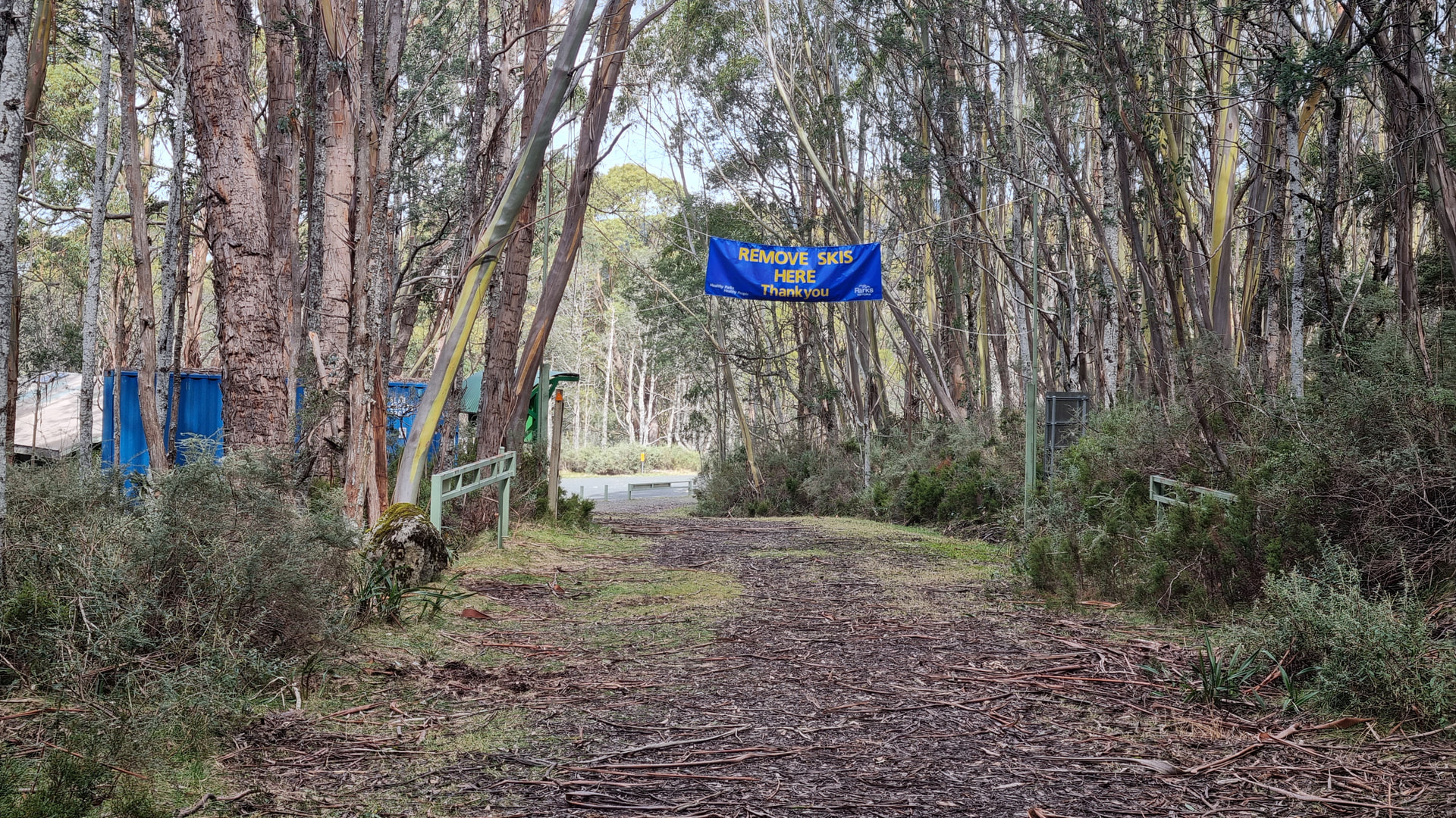

On the hike back to the car park, I took a detour, walking a different track to the side of Mt St Gwinear, rather than rising up and back down 60 metres of elevation over the peak. On this detour there was a clear view to the Northeast with VK3/VT–016 Mt Useful and other summits visible.
My expedition finished back at the car park where I was cheerfully advised to remove my skis. The trip from Mt St Phillack to the car park took 75 minutes, ten minutes quicker than in 2013.

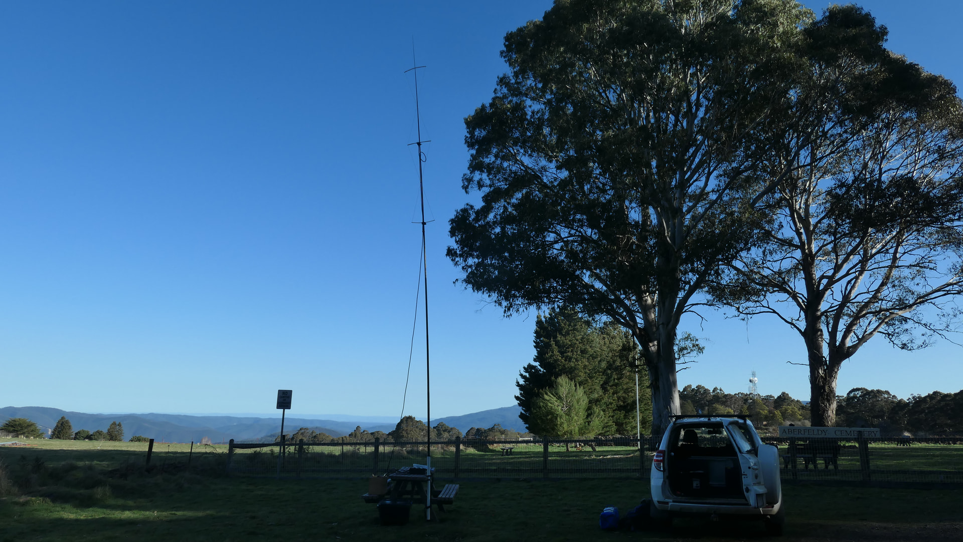

Saturday 19 and Sunday 20 September 2026 were the dates for the VK VHF UHF spring field day, a 24 hour contest focusing on portable operation on bands above 30 MHz.
The VHF UHF Spring Field Day sees a few clubs and individuals make their way to the hills. This also presents an excellent opportunity for SOTA operators to get more contacts on the higher bands than normal. Not only does the field day bring more field stations onto VHF and UHF, but there are also more home stations trying to contact those stations.
I had planned three drive up summits on the Saturday staring with VK3/VC-001, Mt Matlock, a summit I have activated five times before. Leaving home at 6:30am I arrived at Mt Matlock at 9:30am.

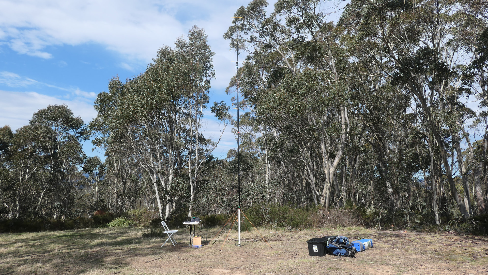

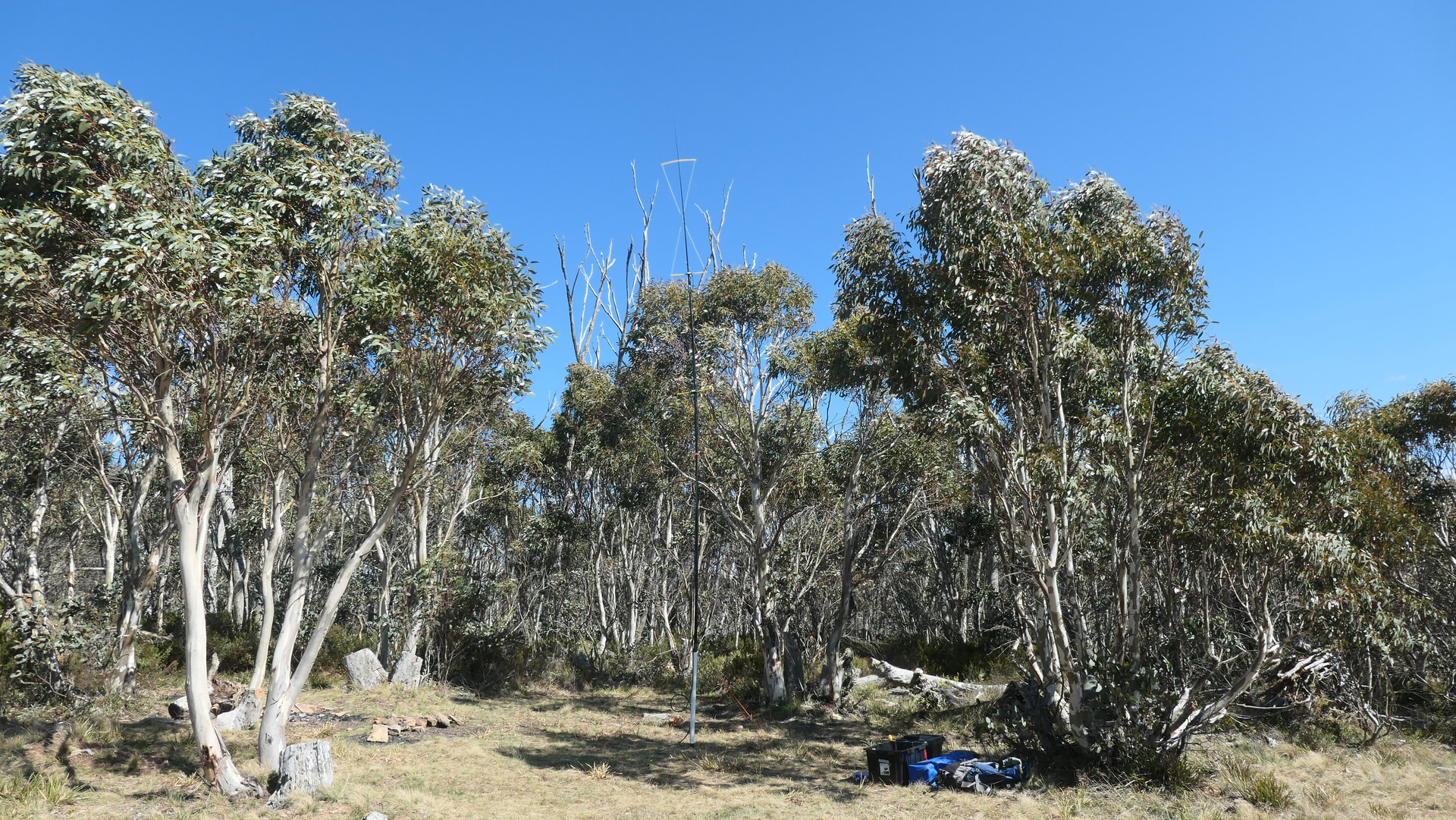

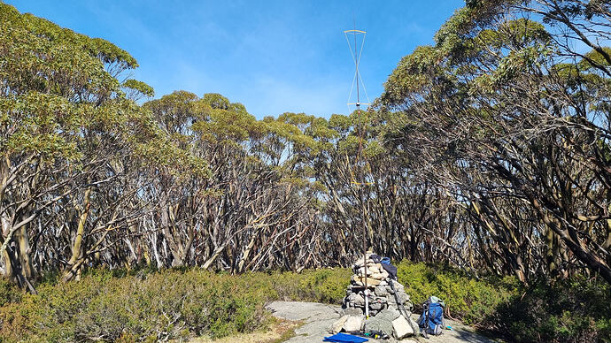

I set up a 9-metre squid pole with the double hourglass antenna in a clearing slightly off the top of the hill. I was using RG213 coax today as I needed extra length to achieve the full height of the mast.
First in the log was Peter @VK3PF S2S at VK3/VT-083, 34 km away. Peter has written about his SOTA day here. I then worked a steady flow of regular chasers over the next 45 minutes including S2S with @VK3HRX at VK3/VS-018, 262 km away. The field day activity started at 11:00 am, and I continued, only working on 2m, until 11:30 am. I finished the activation with two contest stations in the log making a total of 21 QSOs with the closest, 34 km, and the furthest, 262 km, both being S2S contacts.

I kept the second to last section of the pole down to minimise the movement of the antenna, https://youtu.be/s02DFNTykvU, although there was noticeable QSB on most signals as the antenna moved about in the wind.
My first QSO was again S2S with Peter @VK3PF who was activating VK3/VT-016, Mt Useful, about 10 km away. Peter packed up shortly after our QSO and later arrived at my summit as I was about to close down.

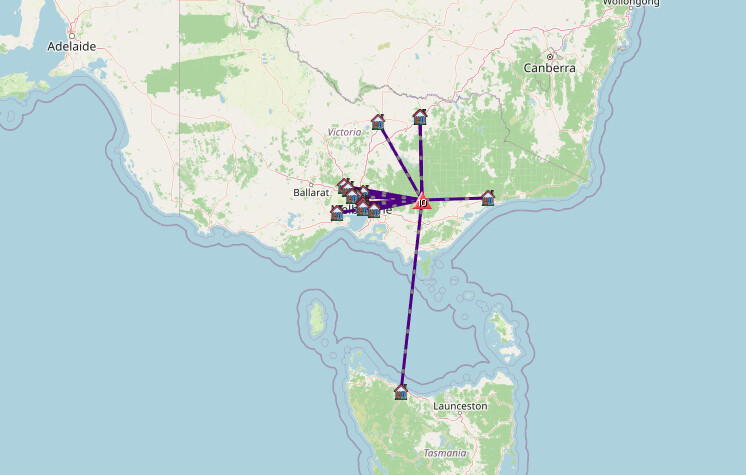

The most distant QSO was with @VK7DW 419 km south in Tasmania, and the closest QSO was S2S with @VK3PF who had now moved to VK3/VT-022, Conners Plain, 19 km away. After 45 minutes I had logged nine QSOs, including one contest station.
At about 5:00 pm I packed up and headed home, looking back on the 47 QSOs I had made and considering what to do on Sunday. I arrived home just after 8:00 pm having covered about 370 km for the day.

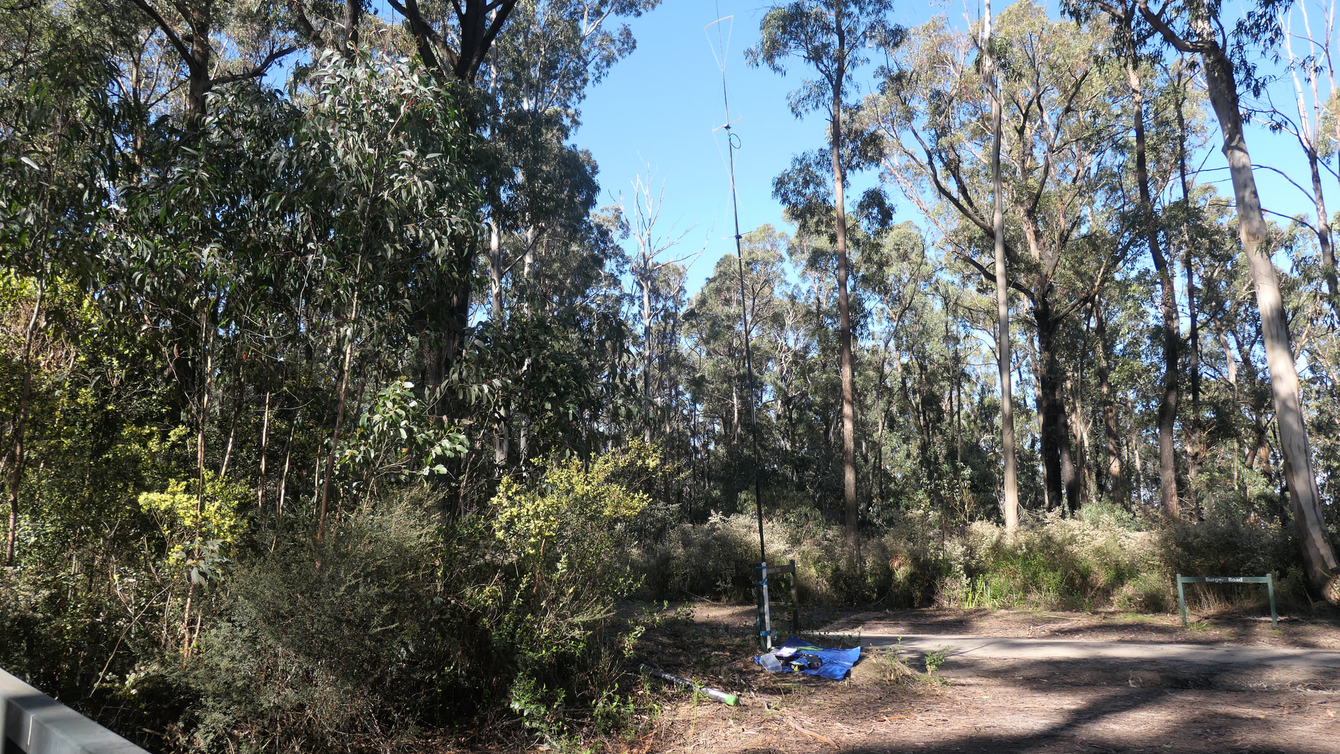

On Sunday morning I thought an unplanned activation somewhere near home may be a good way to further build up my score for the 2m/70cm challenge. The closest summit to home is an unnamed summit, VK3/VC-037, located about 40 km by road. Although I had already activated this summit twice this year, I was keen to work some of the contest stations who were not normally on 2m on the weekends.

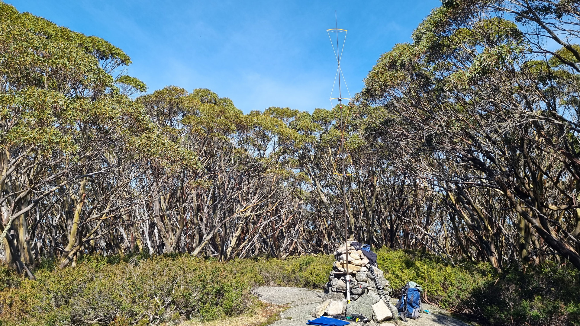

Arriving at VK3/VC-037 at 7:40 am I set up the double hourglass on the 9m pole, anchoring it to a convenient post.
I was on air at 8:00 am, 2200 UTC, and logged 24 QSOs in just over one hour, between 35 and 250 km away. Unfortunately, there was no S2S QSOs from this summit, but I did log @VK3PF who was back home.
The double hourglass performed well at all locations, although the wind loading at the first two summits was a concern.
At each summit I was using FT817ND and a 1980s style linear amplifier giving me about 40 Watts to the coax.
