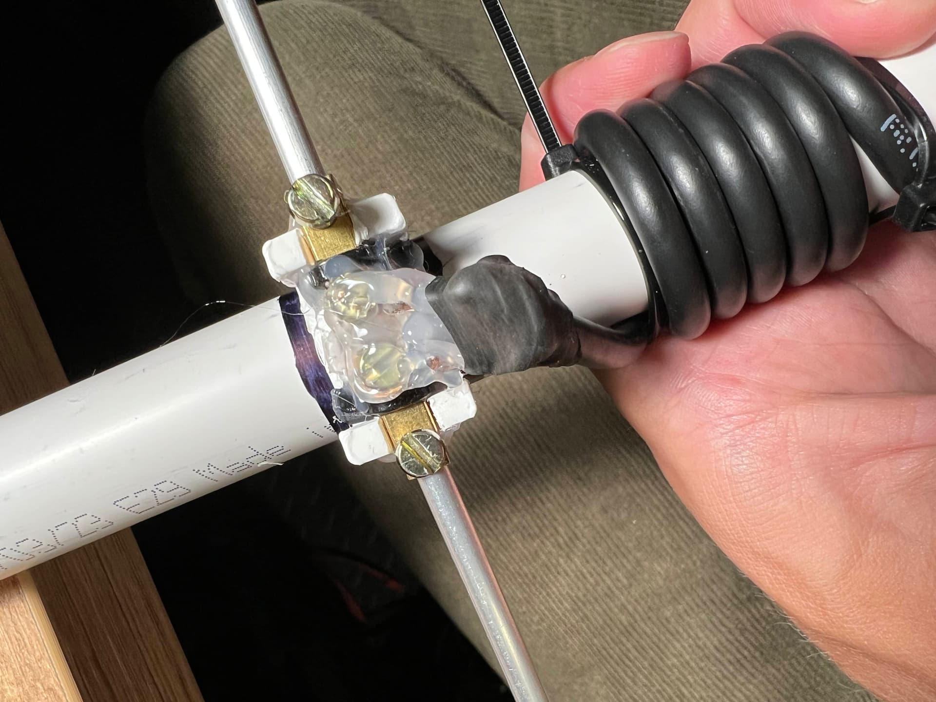

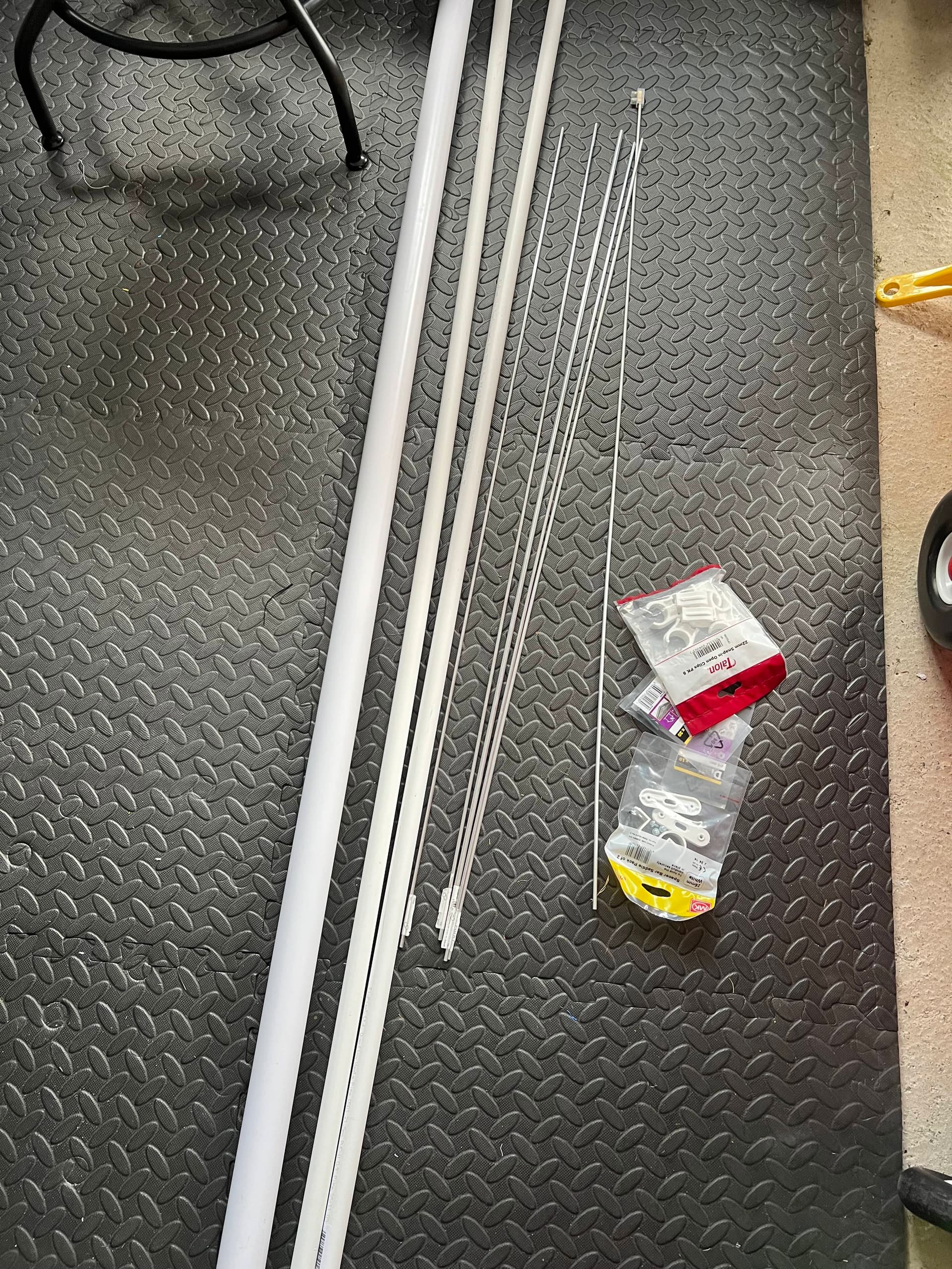

B&Q in Swords is your best bet for parts, Ian. You get there 1m uniform aluminium tubes of 6/8mm, for your elements. 15mm tube for a boom and white plastic clips to keep everything together. A junction box can be found there too or in Radionics.
I’ve built my 2/70 beams with the same parts. Running strong for almost 5 years with no service :slight_smile:

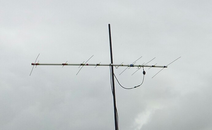

A B&Q yagi:
Better builds exist but did the job.

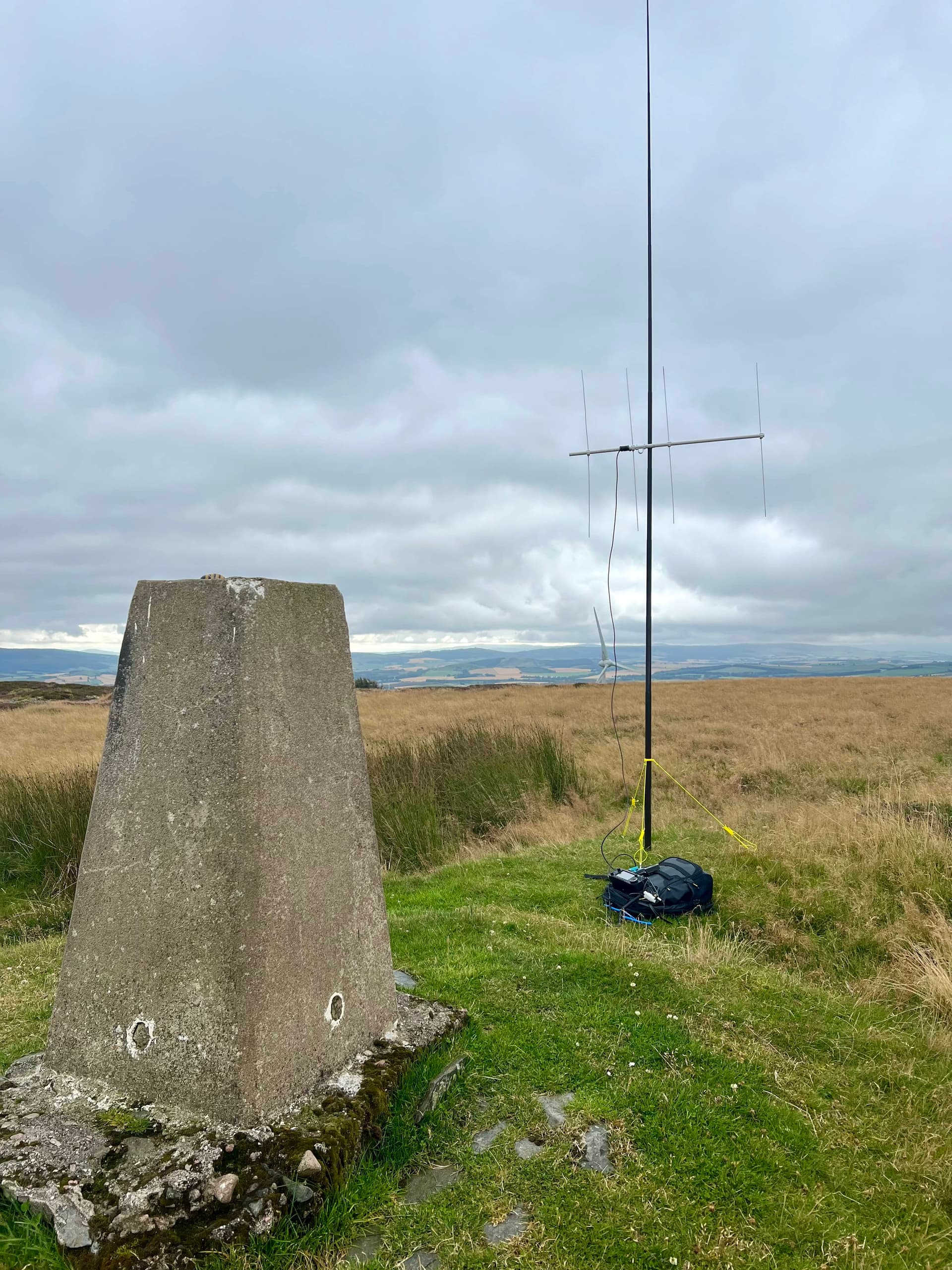

Great idea Alex! I’ve built a bit bulkier setup and only 3 el for 2m Using same boom for both 2 and 70 though.

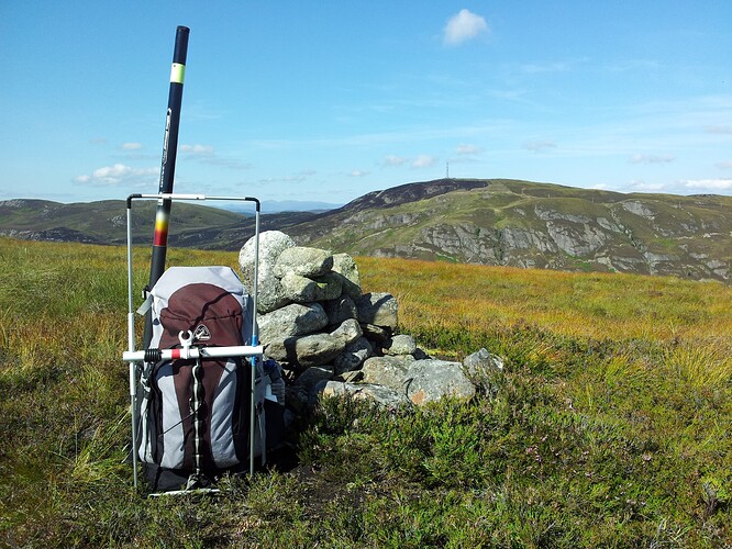

I’ve thought about making @G5OLD Tim’s yagi next, or maybe a moxon. See if I can make something a bit more convenient to carry…and doesn’t use screws on a hill!
Works fairly well when I’ve used it. :+1:
Can I say the old mantra about cable dressing and Yagis. But the other old joke saying first…
“The difference between theory and practice is often much greater in practice than the difference between theory and practice in theory.”
The feeder dropping vertically close to the driven element will affect the match and the radiation pattern. Is the effect important or undesirable? Well the answer is it depends. i.e. it’s not black or white but some shade of grey.
You may find the directivity when horizontal is much better than when vertical because the feeder falling away normal to the elements. You may find the vertical version has it’s maximum radiation pointing more upwards because of the feeder. Or it may be the proximity to the ground has much more effect on the performance than the feeder position here. But… you should aim to have the feeder run away from the driven element 1/2wave before it runs by the elements. This is not always easy and is left as an exercise for the activator. You should at least experiment a bit to see if there is any noticeable and repeatable effect.
A lot of commercial vertically polarised yagis are normally mounted behind the reflector to keep feeders and the mounting pole out of the way of the elements for these reasons.

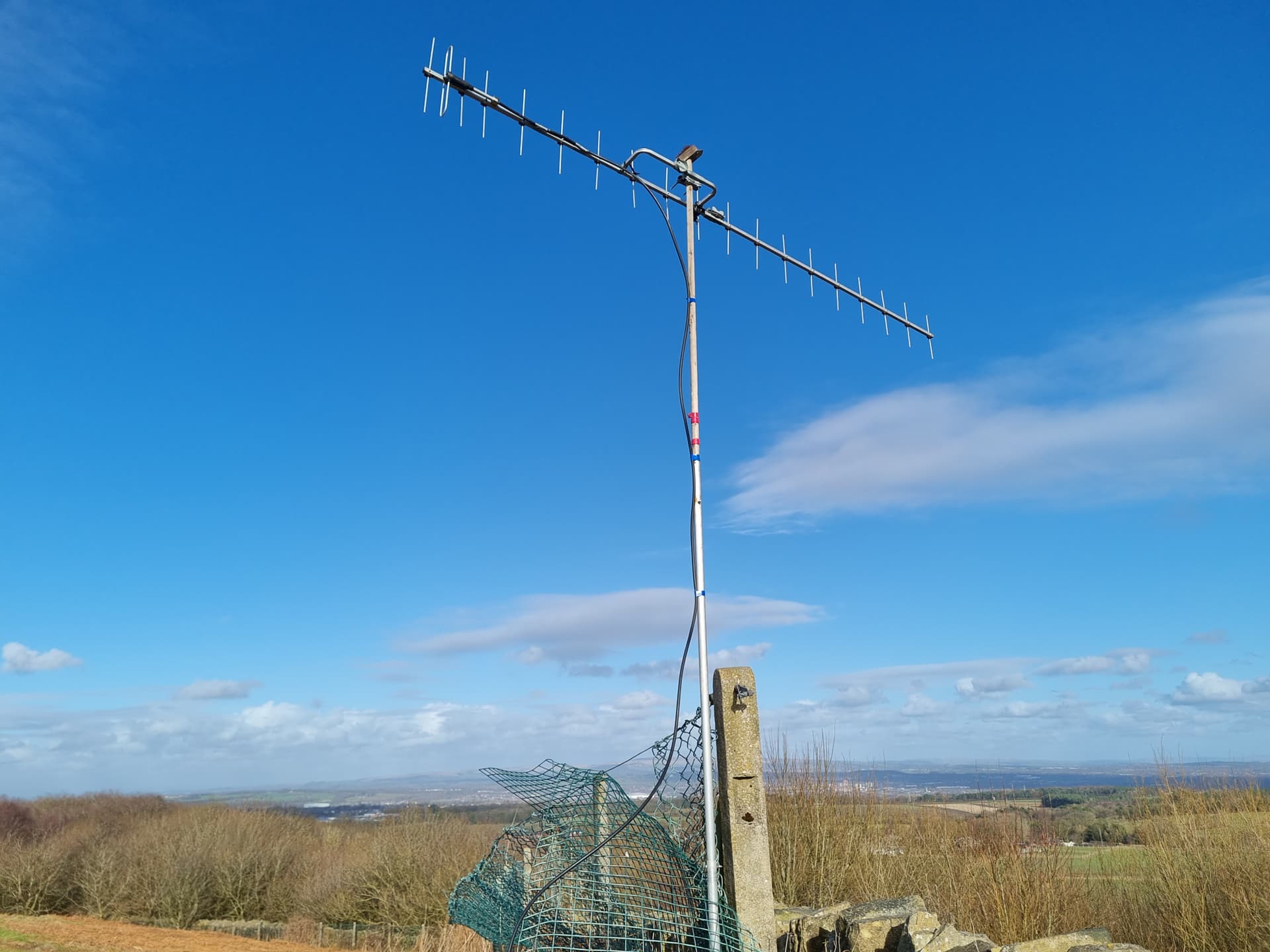

Because on 70cm you can take things like this :slight_smile: :-
From a 433alive event in the summer
Is that another one of those bands you have in Ireland that we don’t have in the UK?
The boom for that 70cm Yagi looks like a single piece of metal. How the heck do you carry that up to a SOTA summit especially if a solo activator? Even my portable 4-element 2m Yagi (with removable elements) has to be carried in a separate (and inconvenient) shoulder bag.
It is actually 2 piece boom and when taped together the mounting bracket makes it pretty well balanced for carrying. It isn’t that heavy either. It helps when its G/SP-017 Billinge Hill which is a pretty short and mostly flat walk from the car. I think its definately something suitable only for selected summits.
The most difficult part is the 2 swagged poles and wooden brush handle as the upper mast section (necessary when vertically polarised) and then actually erecting the thing can be tricky.
I have done it solo, but normally Peter M1BZJ comes along and he plays on other bands while I’m on 70cm. That makes it all a lot easier.
With 35w of FM from the ft-8900 and allowing for about 3db loss in the feeder it works out at about 400W of erp. Maybe I should take an amplifier :slight_smile:
