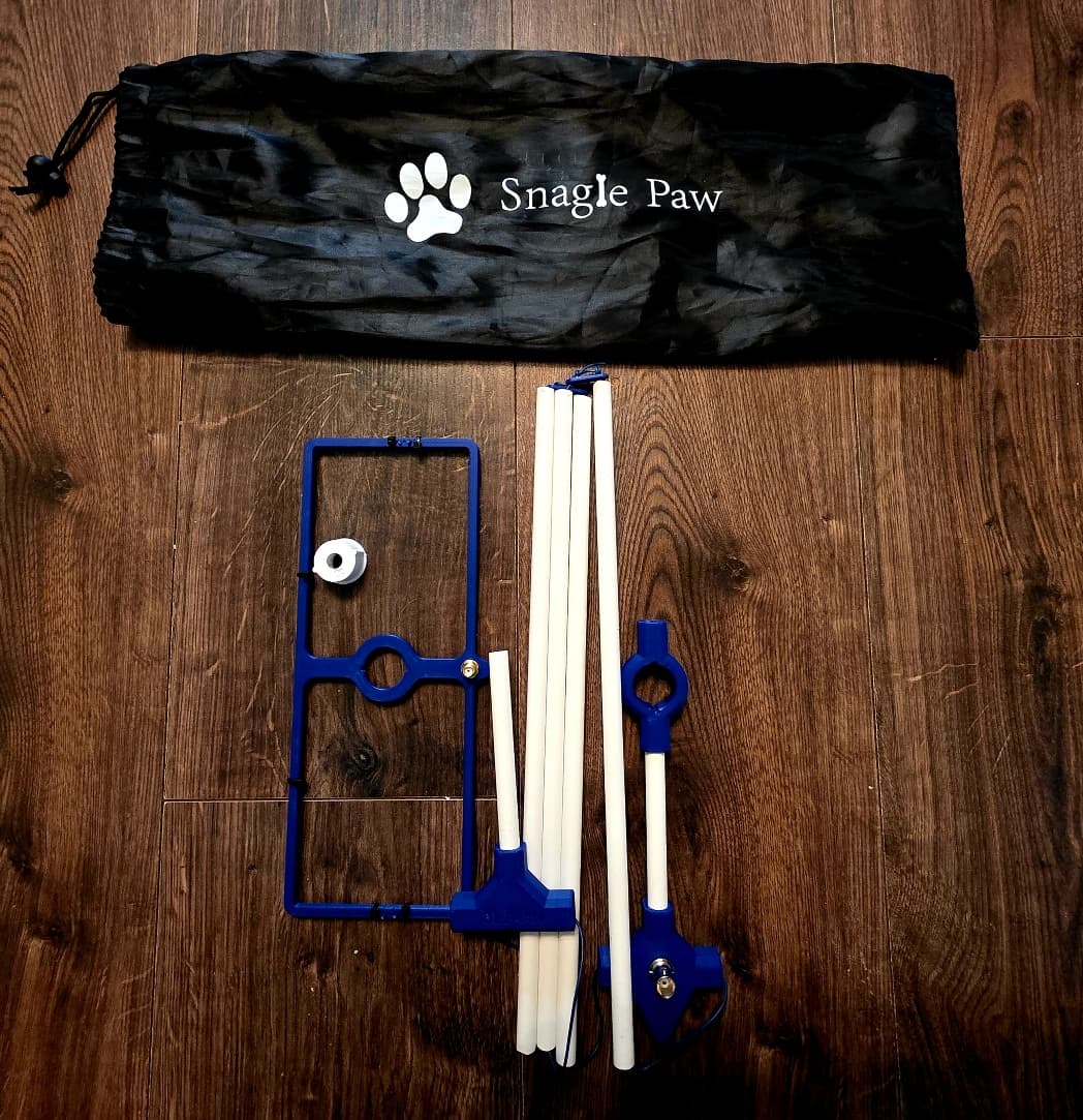

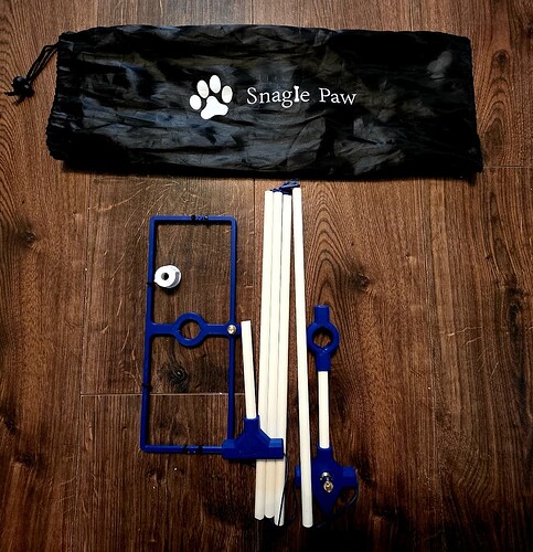

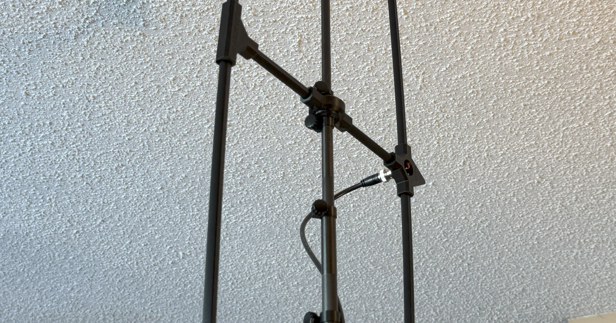

Here is my DL2MAN 270 Moxon folded up. I found an old pouch containing one of those corkscrew dog leash posts - I bought one to use for a kite antenna project I still haven’t gotten round to - the kite is still new in the box unopened!

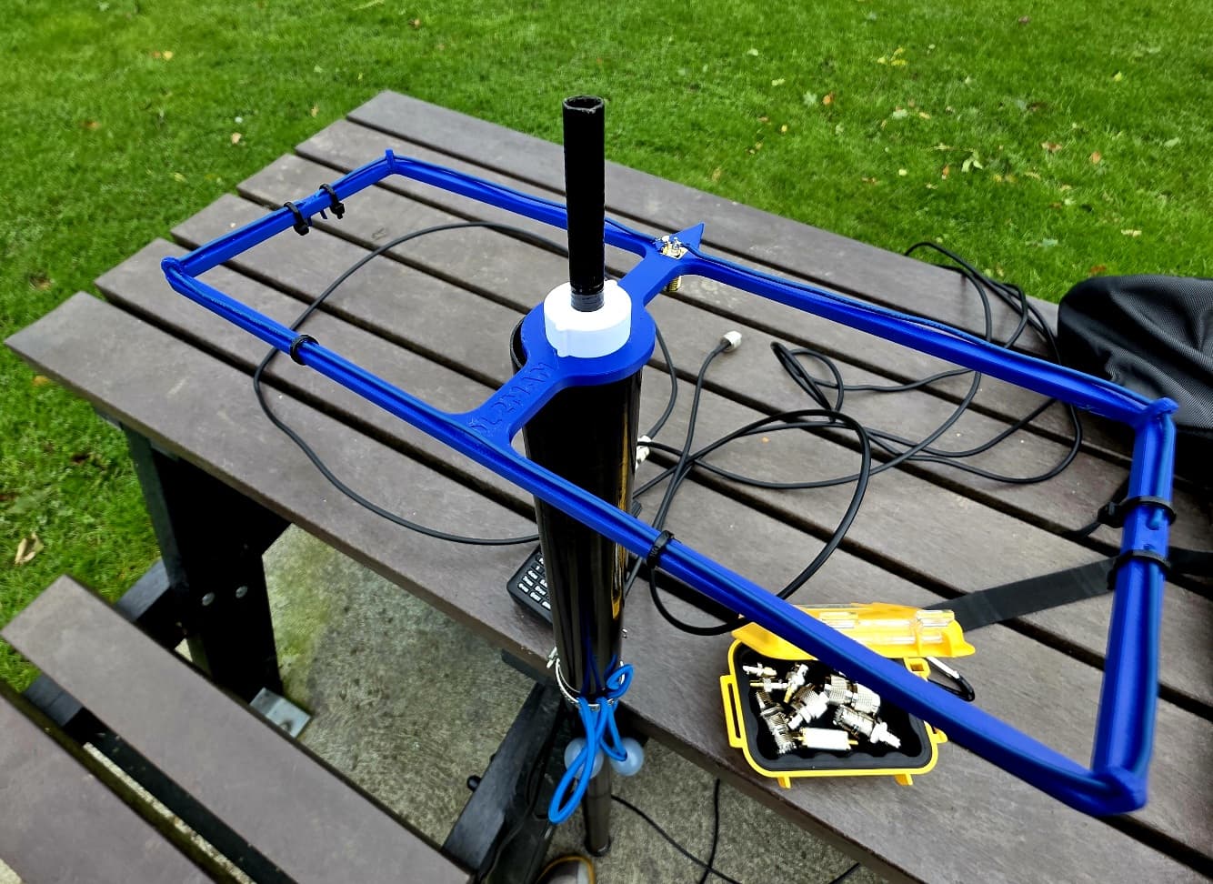

The antenna is super lightweight and fits on to my 7m Wimo mast no problem. The antenna adaptor I found separately on Printables which saved me using DL2MAN’s template to make my own.
I took the mast, the 270 Moxon and my FT65 (I forgot to bring my FT60) to my favourite POTA spot IE-0136 and tried calling for a signal report on the 2m Dublin City repeater…
** drumroll **
I broke squelch (a good start) and after my over I got a signal report straight back. Amazingly it was from someone I knew offline, a very good friend, who was enjoying using his new handheld he bought recently. What a coincidence!
599++ all copied both ways. Fantastic for both of us!
I did try a QSY to 145.500 but nothing heard. The Moxon is directional so I tried a mast rotate but nothing alas. Not to worry. I then tried 70cm but I couldn’t even break squelch on my usual repeater which I can break squelch on with the Diamond RH770. Note in the photo only the 2 meter part is shown and with the mast not put up yet, it’s just to demonstrate how it looks mounted on it.

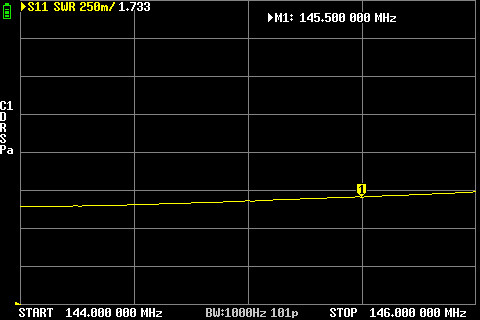

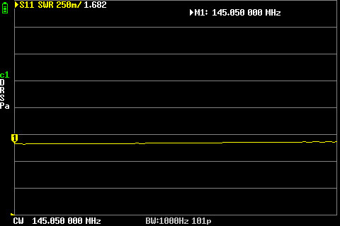

I think there is a problem with the 70cm part of the antenna. When I tested it on Nano VNA (my Rigexpert doesn’t go as high as VHF or UHF alas but the Nano does a great job so saved a few quid there), the SWR was reading about 3.1 which is far too high. I have read in some places that the 70cm SWR is an issue but I’m not quite sure how to rectify it. Snip some wire off and tighten it up more? I’m unsure.
I did take a couple of (point in time) screenshots(see below) of the 2 meter SWR which is pretty nice. Nothing serious, just put it up the living room to do a quick SWR check. Getting around 1.5 to 1.7 SWR and fairly broad across the 2 meter band as a whole, particularly on 2 meter CW which is where I want to use this primarily. Good news!

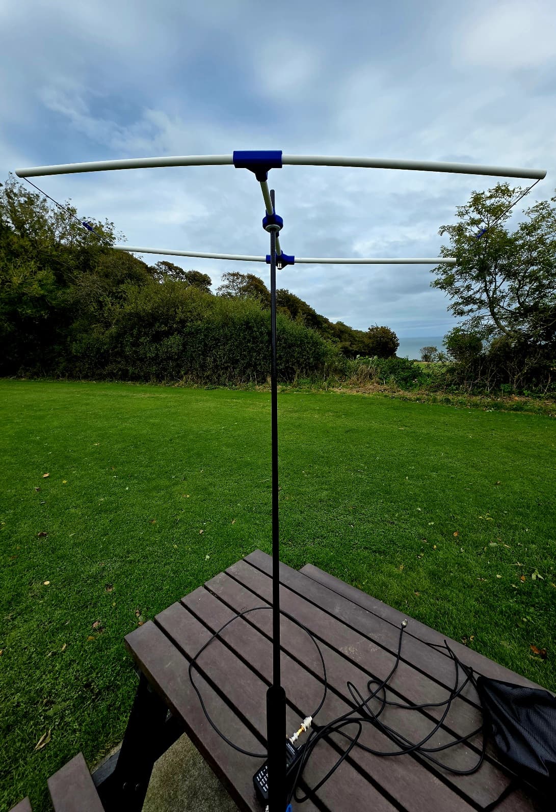

Would I take this on a SOTA? I’m not so sure. I had some adapters weighing the front end down which didn’t help and it felt a smidge precarious. With a single cable between HT/Radio and antenna it should be fine, it just means you’ll have to make one up or spend a few quid on a prefab. I just used what I had for now to see if the antenna actually worked.
For POTA, BOTA (Beaches) and so on, so long as it is mast-friendly weather I’d say go for it. Or better yet, stick it on some sort of tripod setup of sorts? For 2 meters, I think this antenna is a winner. For 70cm I think work needs doing, but it should hopefully be an easy enough fix to get the SWR down.

For 2m FM rotate it for vertical polarity. Might yield better results if you want to give it a try again. And thanks for the report.
73 Joe
Hmm, so maybe a right angle adapter or a T Connector of some sort could work for that?
Thanks for the advice. I will have a think and see could I design an adapter in TinkerCAD perhaps?
Can’t your rotate it like shown here?
That will give you max gain for chaser using vertical antennas, mobile stations and others using handhelds on summit or portable
That’s brilliant, thank you Joe I hadn’t seen that design. I’ll print it out and test it soon!
I think the part linked is just the tubes. I just wanted to show how it should be aligned for vertical use. Pretty sure you can make a small part to give you a 90° rotation on the fishing pole.
I reckon a slight modification of the centre piece for the 2 meter mount, to make it jut out away from the mast a little, should work. I’ll see can I remix that specific part.
Don’t forget the feeder needs to be orthogonal to the radiator and should be like that for 1/4wavelength. i.e. 50cm on 2m. That’s not easy to do at all. If it isn’t then to varying degrees it will affect the performance. Does it matter? Yes and no. The pattern will be squint or not what you expect. You may find when testing an awkward 1/4wave hang out that there is an observable difference but even compromised, the antenna will work so much better than other antennas. Try it and see if you can measure a difference so you know.
