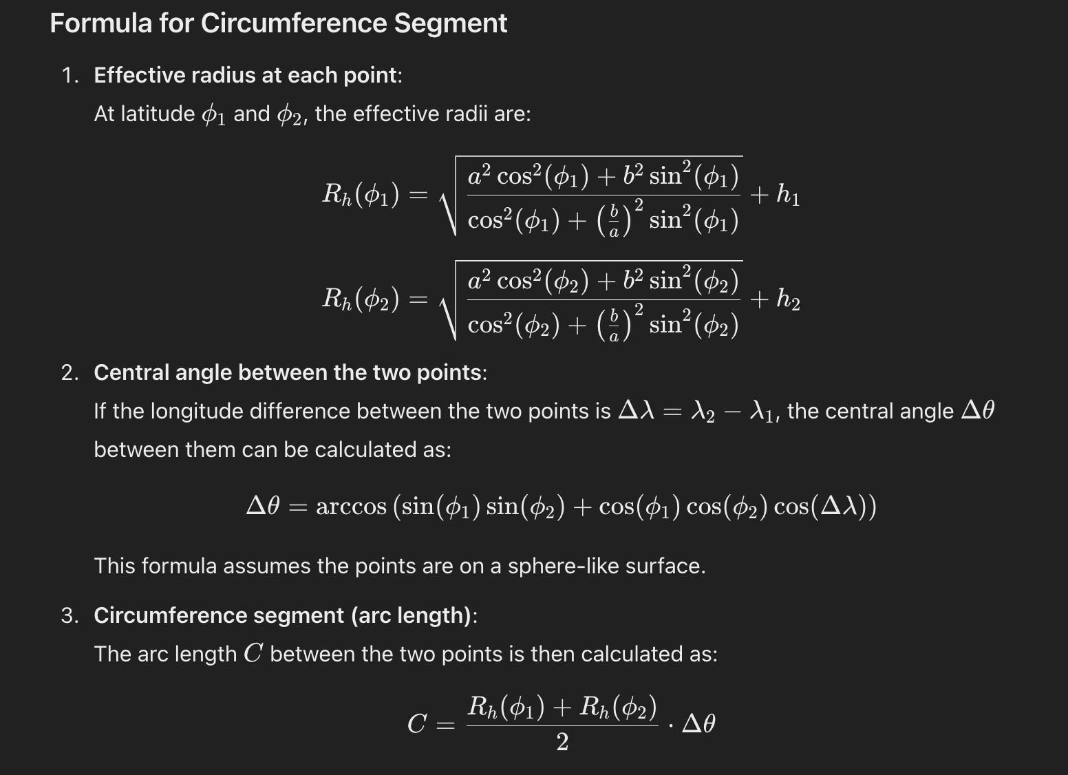

I was thinking a useful output, digestible by all (and not a 300+GB file), would be the summitslist.csv with some extra columns for the top 10 furthest summits and distance. So people could look up their summits and see what’s far away…if such thoughts occur to them…or if nothing else then a least something to show for all the brain and computing processing!
@GM5ALX’s python looks just the business and based on the formula below:
The beautiful thing about this, it will look at the distance from operator to operator.
Having looked at the top 1000 antipodean summits calculated by Alex @GM5ALX both the altitude and bulge of the earth make a difference to almost all summits !

Yes, absolutely there are better ways. (I’m also comparing it to Tim’s screenshot of the formula and I’m not sure it’s right…)

def calculate_arc_length(lat1, lon1, alt1, lat2, lon2, alt2):
    Calculate the circumference segment (arc length) between two mountain summits.
    Parameters:
        lat1, lon1: Latitude and Longitude of the first summit in degrees.
        alt1: Altitude of the first summit in meters.
        lat2, lon2: Latitude and Longitude of the second summit in degrees.
        alt2: Altitude of the second summit in meters.
    Returns:
        Arc length in meters.
    # Earth's equatorial and polar radii in meters
    a = 6378137.0
    b = 6356752.3
    # Convert latitudes and longitudes from degrees to radians
    lat1_rad = math.radians(lat1)
    lon1_rad = math.radians(lon1)
    lat2_rad = math.radians(lat2)
    lon2_rad = math.radians(lon2)
    # Calculate the radius of the Earth at a given latitude using the formula for an ellipsoid
    def earth_radius_at_latitude(lat):
        cos_lat = math.cos(lat)
        sin_lat = math.sin(lat)
        numerator = ((a**2) * (cos_lat)**2 + (b**2) * (sin_lat)**2)
        denominator = (cos_lat)**2 + ((b / a)**2) * (sin_lat)**2
        return math.sqrt(numerator / denominator)
    # Calculate the radii at the two latitudes
    radius1 = earth_radius_at_latitude(lat1_rad) + alt1
    radius2 = earth_radius_at_latitude(lat2_rad) + alt2
    # Calculate the central angle
    delta_lon = lon2_rad - lon1_rad
    central_angle = math.acos(math.sin(lat1_rad) * math.sin(lat2_rad) + math.cos(lat1_rad) * math.cos(lat2_rad) * math.cos(delta_lon))
    # Calculate the arc length
    arc_length = ((radius1 + radius2) / 2) * central_angle
    return arc_length
