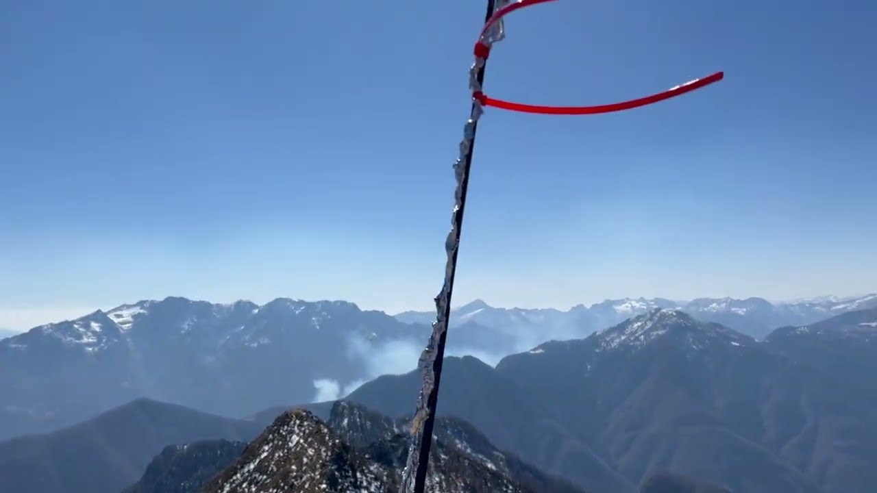

At first I contemplated ripping up the earphone cable to make two pieces, but it was tightly “woven” and I wasn’t sure whether I could extract two strands – and also I didn’t really want to ruin it. So I decided to try fashioning the aluminium foil into a radiator first. I succeeded at making an approx. 2 m long piece, but had to be very careful not to rip it. I then connected it to the KX2 via the BNC/banana socket adapter that I luckily had brought, and attached the earphone cable as a counterpoise:

Here’s a short video showing the setup and the signal received from my last caller:
