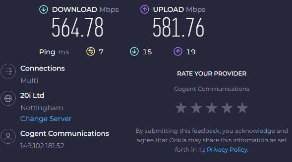

Late reply, here, Rod but I’m on ZZooMM and recommend them. I get 500M symmetrical for £24.95 per month. I also switched the phone to VoIP (but not with ZZooMM as their offering was a bit pricey.
I could send you a referral code and we both get £100 if you sign up. Maybe they are a bit desparate !
Edit : actually only £50 each if the 500M is ordered :frowning:

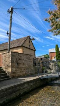

There are some pretty crazy cats’ cradles round this neck o’t’woods. My wife snapped this beaut (complete with entangled dead pigeon) in Nailsworth earlier in the week:
NailsworthPhonePole
