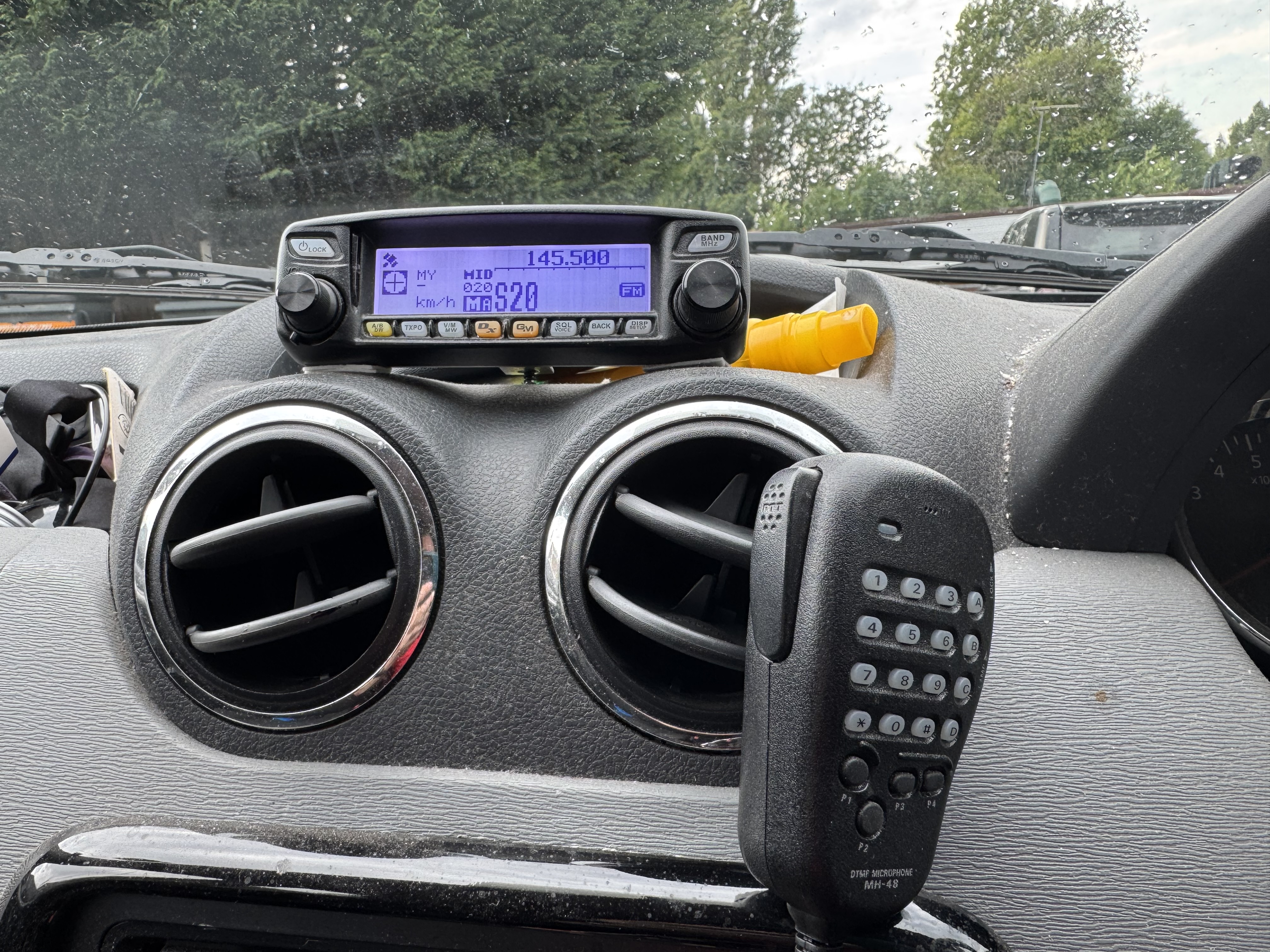

I’ve had the FTM100D (pictured several posts above) monitoring S20 while driving up to GM this morning. At Tebay, and so far just two weak CQ calls heard. I’ve got all the repeaters and gateways programmed in so maybe I should have it memory scanning on the next part of the journey.
