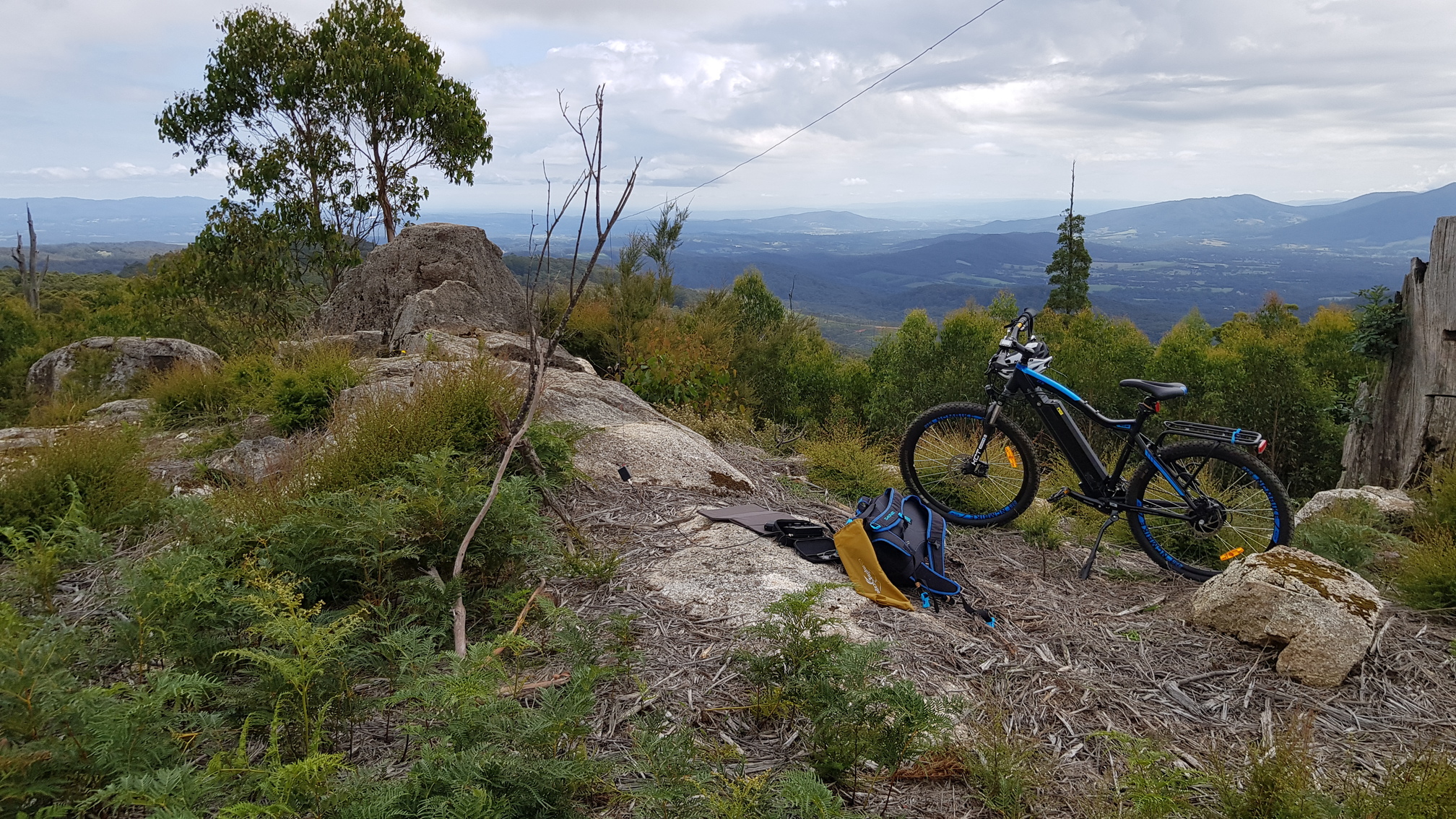

Did my first ebike SOTA activation today, VK3-VC-038, Archer Lookout. It was a lot of fun. I would not have been able to get my car up the tracks but the bike ate it up. Did get a bit shaken around though.

Another ebike activation, Mt Beenak, VK3/VC-016.

Hi Glenn, an interesting E bike which appears to be a NCM ?? What model is it and notice it has a rear pannier rack which would be handy.
I have some pannier bags about.
How long does the battery last and does it have low gears for really slow work. Like trickling along at a walking pace on pretty rough badly made tracks.
Thanks for any information.
Wal VK2WP
Hi Wal,
Yes, it’s an NCM Moscow from Leoncycles. It has a 48Volt 13 Ah battery and it lasts for ages. I did 40km around the burbs and it still said half charge on the gauge. Of course, it depends heavily on the terrain you are cycling on. It has 6 power levels and a walk mode. I have been surprised on the torque for a hub motor. A recent activation had a 2km stretch with an average 1 in 9 grade (higher peaks) and some pedalling effort was required, but all good fun.
Have been thinking about a linear to run from the battery (disconnected from the bike), wonder if that would be in the rules???
Cheers,
Glenn VK3YY
