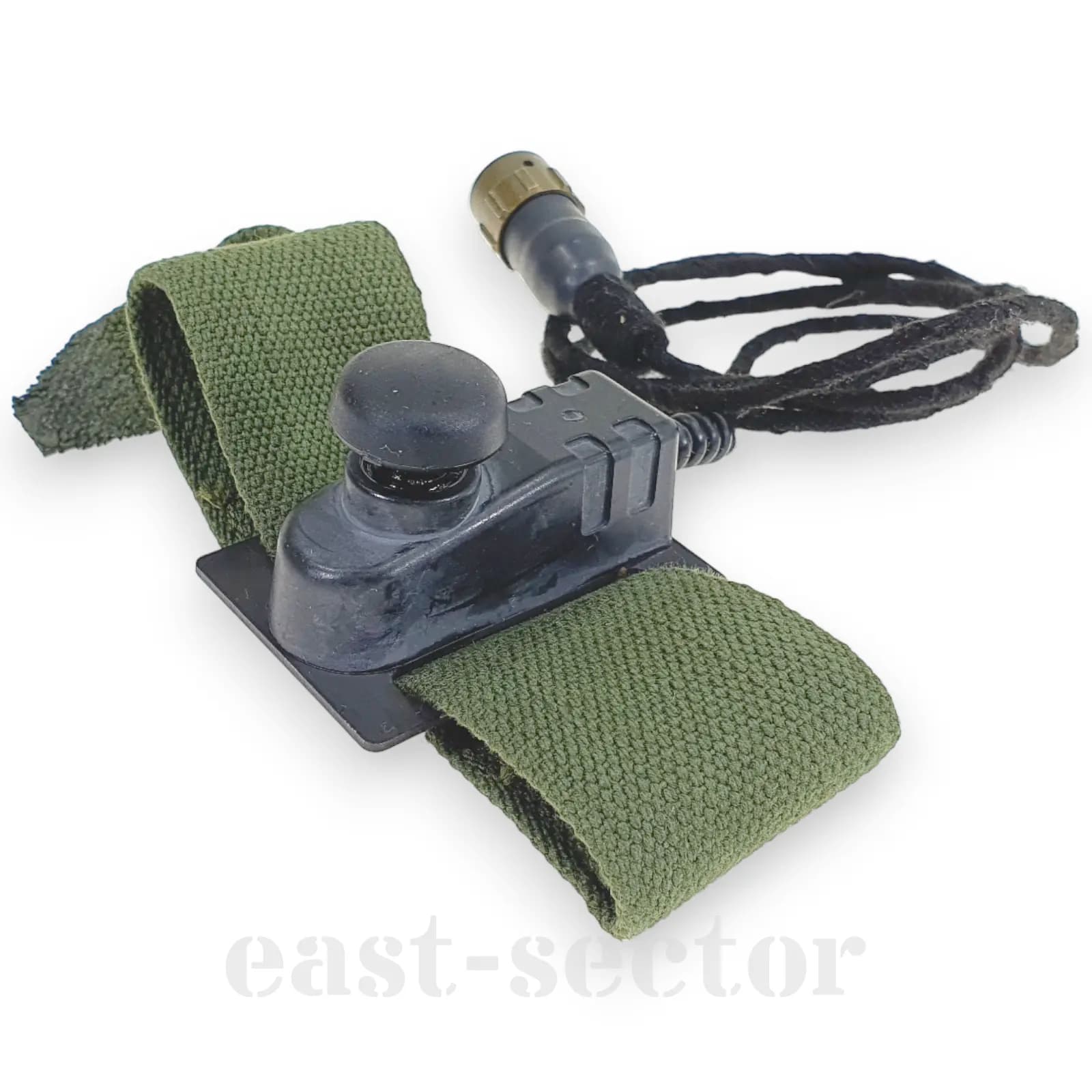

Searching some more for morse keys I found a listing for a RACAL morse key that looks pretty weather proof, designed to operate from the knee but without the adjustment screws of the Clansman key:
I’ve not used one, but an ex MN RO has a collection of morse keys and told me those keys were not very nice to use.
Also one issue with the leg strap is you’ve got to remove it if you :-
a) decide to stretch your legs
b) decide to have a leak.
c) Or, in your case forget to undo it if you get off the bike :wink:
Ron, in all fairness I’ve only once used one for a few minutes. An Ex-MN op had one in his collection…(He thought it was rubbish too , in terms of use).

I’m very late to the party to reply to your Racal straight key post, but here I am. I used mine extensively. It actually does have adjustment screws - they’re underneath. Great key to use.
I re-cabled mine has the existing cable with the clansman plug was badly deteriorated, so disassembled and installed new cable with 3.5 mm jack.
HOWEVER, the rubber enclosure has now completely deteriorated as well, and so it’s dead.
