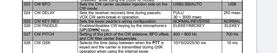

The FT817 can be set to use the “DWN” and “UP” buttons as an iambic key, and so wiring this additional switch is relatively simple. I’m not sure whether the other Yaesu radios have the same option…

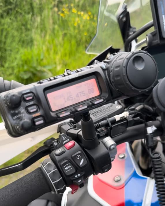

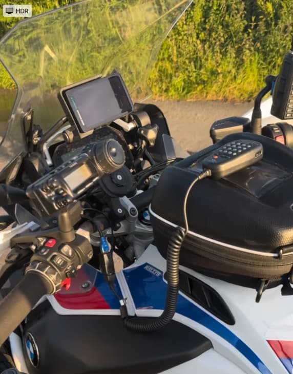

Nice! Hadn’t thought of adding it to the microphone, and didn’t know about the button option. I suspect it will be the same on the 857. ATM I have a 3.5" stereo jack mounted on the handlebars that allows connection of a key.

A couple of photos for those interested:
Excerpt from the FT-857D manual:
