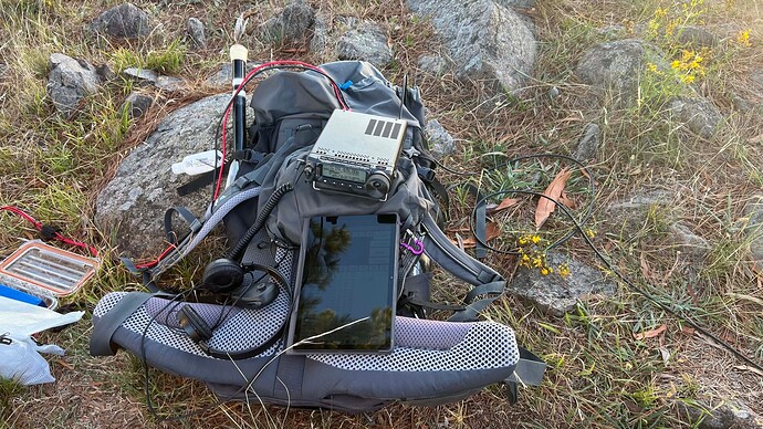

Equipment: FT-891 @ 20 watts, linked Inverted V dipole with the apex at 7m and an 8Ah LifePO4.

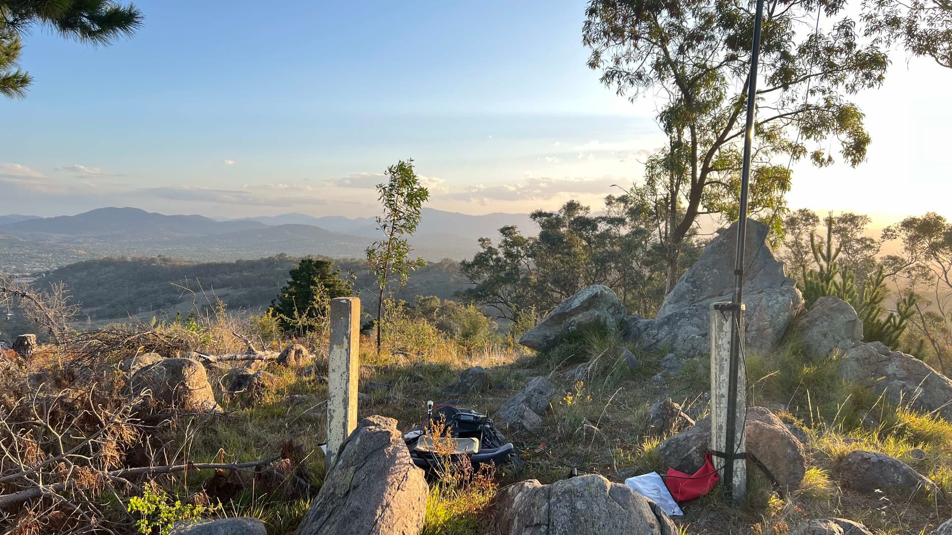

This evening I activate Mt Taylor VK1/AC-037 while my SOTA buddy Andrew VK1DA activated Mt Ainslie VK1/AC-040. Mt Taylor ascent is a 30 min walk over 1.5 km and very steep.
20m LP propagation conditions were not even close to yesterday’s example. 20m was open at 0800 UTC and well and truly closed 35 minutes later at 0835 UTC, 25 minutes earlier than the previous day.
On 20m I worked: VK6LK, IK1GPG, F4WBN, UT5PI, SP7MW, VK2LDJ, VK6JK, ZL1TZP, KH7AL/KH9 Wake Island in the Pacific and 9A/IZ3NVR.
17m offered three contacts in New Zealand and one in Western Australia (VK6). 17m is definitely underutilised, I will make a pledge to use 17m more often.
40m was the place to be with 17 QSOs, of which two were out to 2000 km.
Thanks Andrew VK1DA/P for the S2S contacts on 17 and 20m and Ian VK5CZ for the VKFF P2P. :slight_smile:

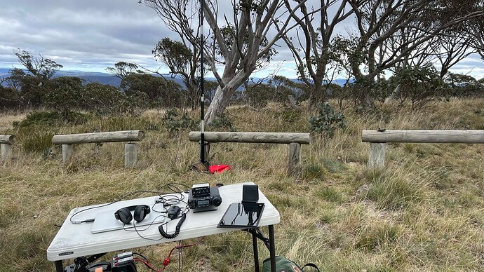

Equipment: FT-857D at 20 watts, Inverted V linked dipole with the appex at 9m.
Mount Gingera VK1/AC-002
Thanks all for an excellent activation! At sunset 0725 UTC the ambient temperature at Mt Ginini fell to 2 degrees C (feels like -1), my finger tips were in pain :slight_smile:
73, Andrew VK1AD
