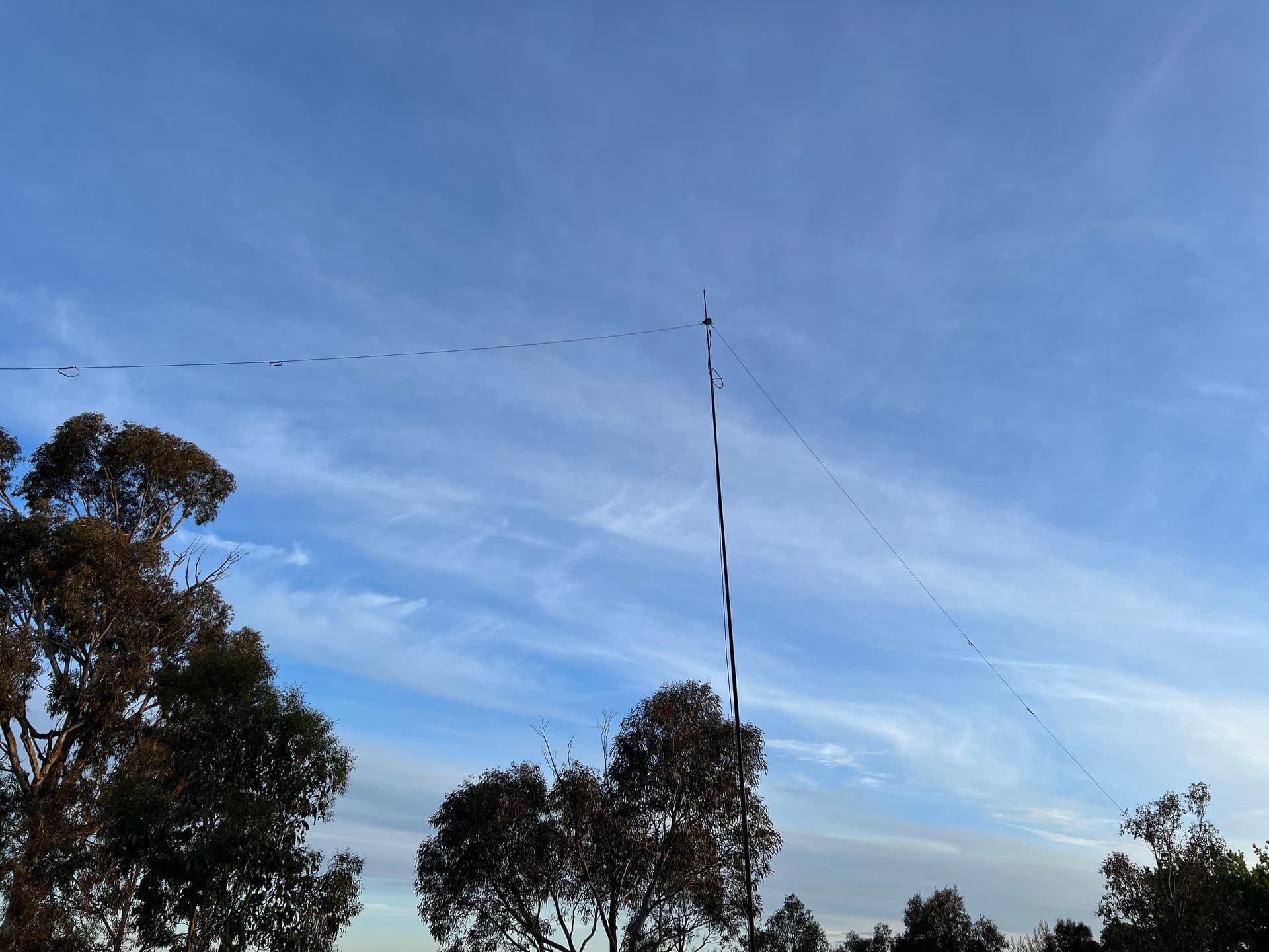

Equipment: FT-891 at 20 watts, Inverted V linked dipole and an 8Ah LifePO4.

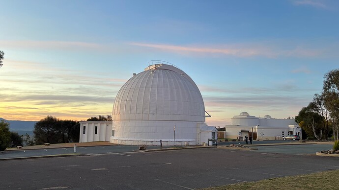

Former Mt Stromlo observatory destroyed in the 2003 firestorm

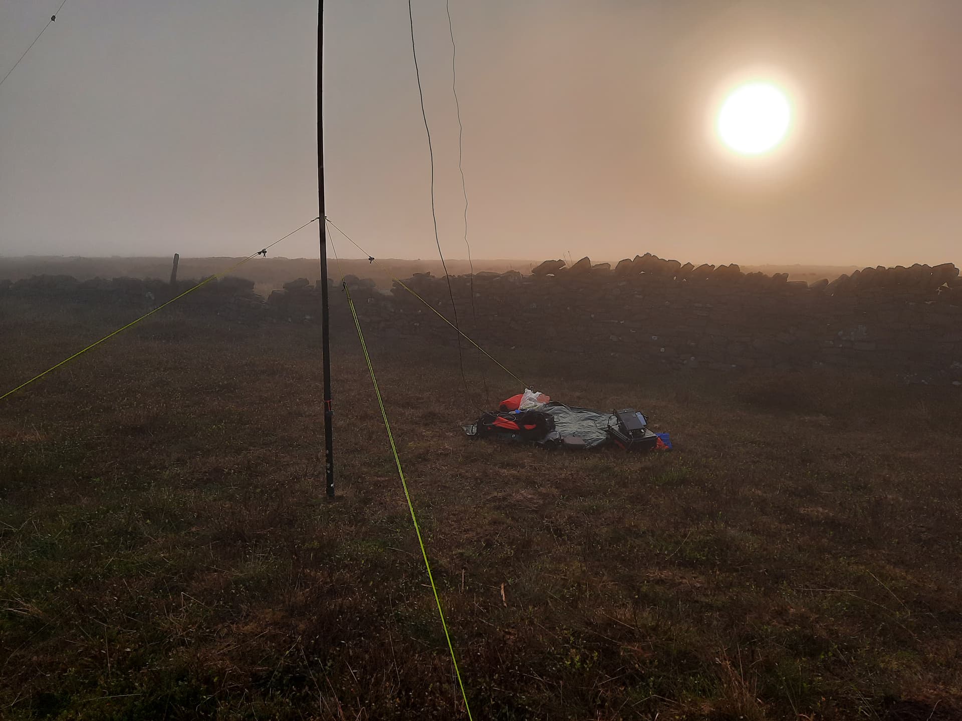

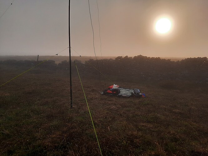

Dragging myself out of bed at 4:30 was a bit of a challenge. I set out on the drive to G/SP-004 (a summit I have activated a few times). Arriving at 6, it was dark and there was thick mist. I was set up by 6:30. On 20m I could hear a few VK stations, but couldn’t break through the pile ups, so I posted a spot. Within minutes Andrew @VK1AD called from VK1/AC-043 he was very clear at 52.
I managed three other VKs @VK2IO @VK2SD @VK2ON a bit later on I got Ben @GW4BML on GM/SI-192 so a good day was had by all!
Not a Kangaroo in sight!
I was using a switched Dipole 15/20/40 and a Xiegu G90 on 20w
Martin 2E0BIA

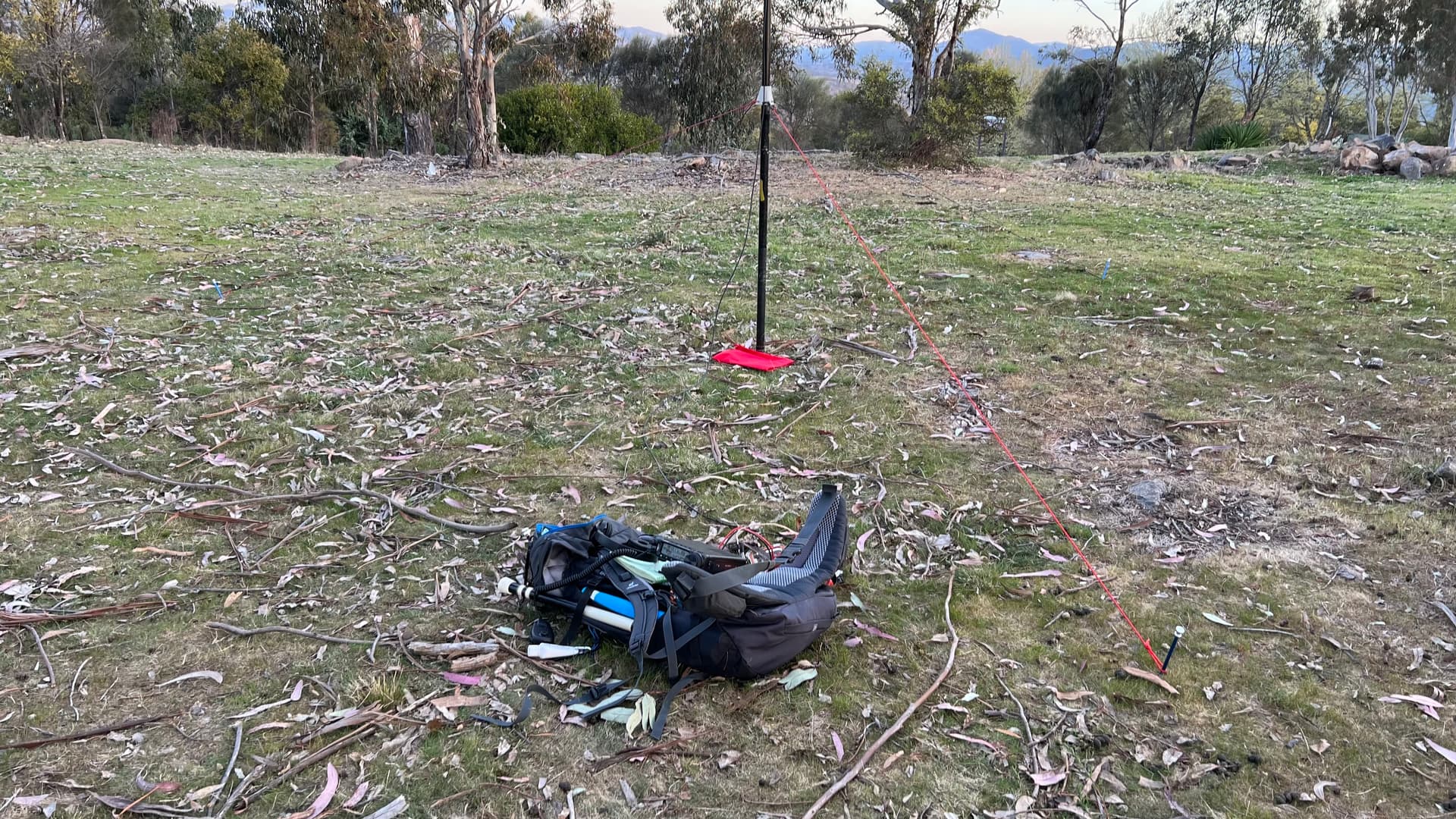

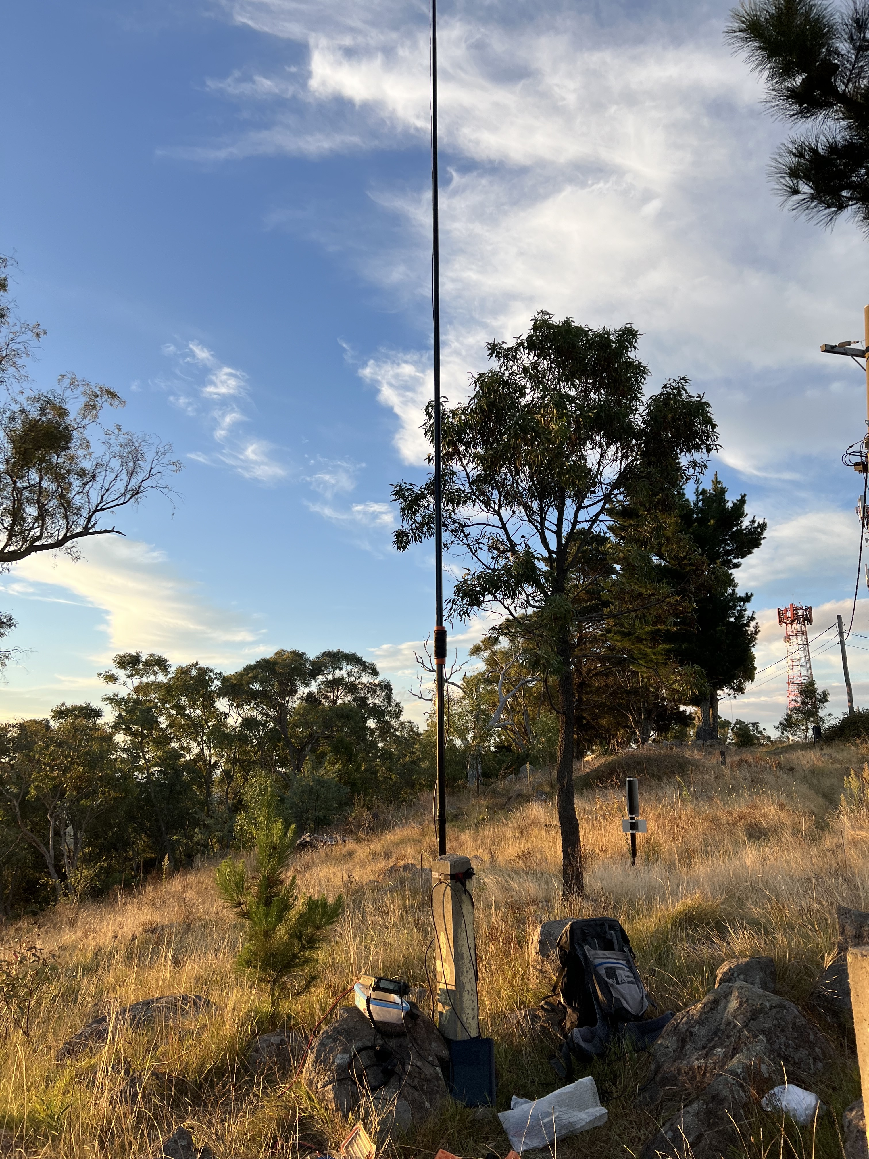

I worked Chris @F4WBN on 10m 28.340 MHz with a FT-891 and a flowerpot antenna and a weak signal S2S with Stephan @HB9EAJ on 20m 14.315 MHz.
73, Andrew VK1AD
