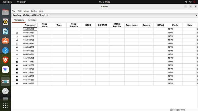

Got it working Hooooooray ! After much swearing and threats of violence and even stooping to threatening the Laptop with Microsoft Windows ( I think that broke it’s resistance !) I have it working. I have programmed channel 1 as GB3RR but as I’m 15ish miles away ( and the extreme rain + a hill ) I cannot get in on the fixed short none removable antenna. I activated it with the main radio and could hear it quite clearly. So tomorrow I will take it to work ( in Dudley) and see if I can get in. This will now open up the use of the cheap radios with a removable antenna to be used, I did lots of things but in all honesty haven’t a clue what made it work ?

This is the Website to what I actually did but I’m not one hundred percent sure it was this as I did so much and didn’t get anything working. I also tried three versions of Chirp which are listed on the Ubuntu Software repository . With one version I could enter the radio type and port but then had no Ok button to press so couldn’t get anywhere. That said I had tried all Chirp versions before
