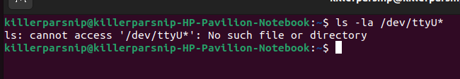

Using that comand I get ls: cannot access ‘/dev/ttyu*’: No such file or directory
killerparsnip@killerparsnip-HP-Pavilion-Notebook:~$
Check that in the command you are using capital ‘U’, your response suggested otherwise.
$ sudo ls -la /dev/ttyU*
killerparsnip@killerparsnip-HP-Pavilion-Notebook:~$ sudo ls -la /dev/ttyU*
[sudo] password for killerparsnip:
ls: cannot access ‘/dev/ttyU*’: No such file or directory
I’m not sure how I got the lower case U as I copied and pasted the command but the above now shows the output with the capital

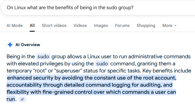

When doing SysAdmin ‘stuff’ my long experience is that it helps if you are in the sudo group.
The AI man presents a succinct explanation (see below) of why; something to think about / try …

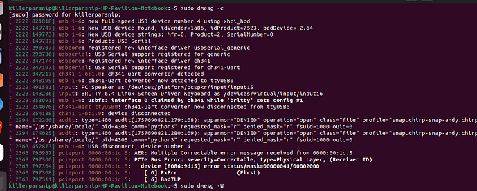

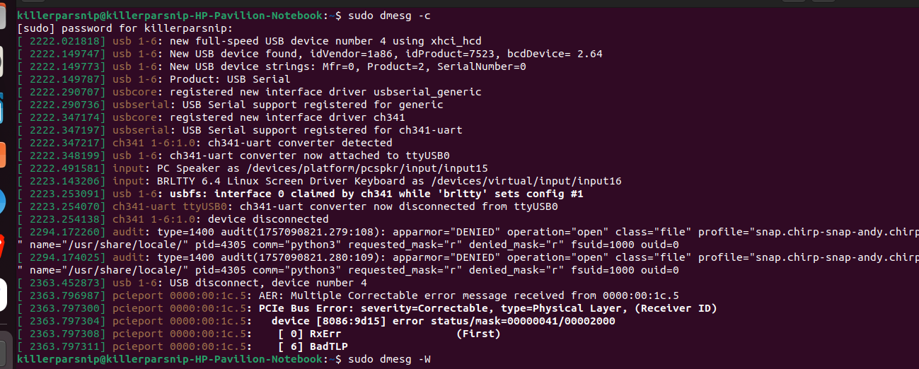

Unplug serial dongle then
sudo dmesg -c
sudo dmesg -w
Doing this gives this output
I should point out my machine is 10 years Old and quite battered I brought another about a year ago which mysteriously got broken ( never found out who or how) so I had to revert to the poor long suffering old one.
There doesn’t seem to be any output when you plugged it back in. You did unplug and plug it back in?
Anyway brltty is the culprit. You can see brltty trying to take over the UART causing the device to disconnect from the bus. Classic problem, disable brltty and /dev/ttyUSB0 will return and should work FB. The AER message is to do with Active State Power Management not working/being supported. It’s separate problem you can fix later on.
