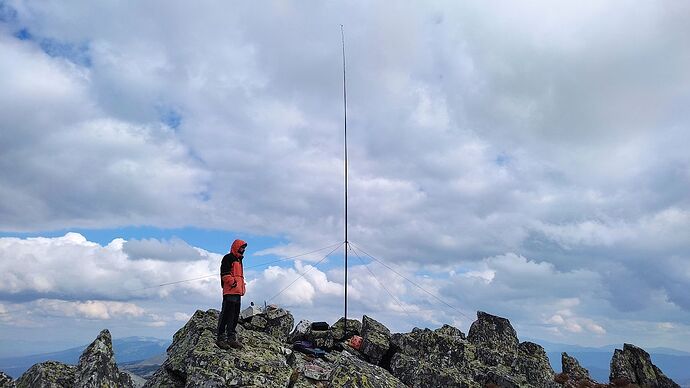

Finally, we reached the rocky ridge at the summit of Malyy Shelom Mountain (R9U/SO-009).
The wind was cold, but the sun warmed and dried my soaked boots, despite the useless “Gore-Tex” material. I should have worn simple rubber boots!
This time, I had a “Discovery TX-500” transceiver in my backpack instead of my homemade “SOTA-transceiver.” I had left my trusty homemade transceiver in the Altai Mountains, where it became a gift for a local ham, Ed, UA9ZR.
The GP antenna and 10 watts were enough to meet the requirements. 79 QSOs in one hour and 15 minutes of summit activity, including 2 S2S QSOs. The farthest contacts were with Japan. I noticed the receiver’s sound was a bit odd when chaser signals were especially strong, but I didn’t think much of it, assuming it was just an AGC misconfiguration.
I wanted to stay on the summit longer, as propagation on the HF bands was improving, and there were many signals on the 10-meter band. However, we needed to return to base camp before nightfall. We quickly packed up the antenna and radio, had tea with sandwiches, and hurried back. The first activation of summit SO-009 was a success!
