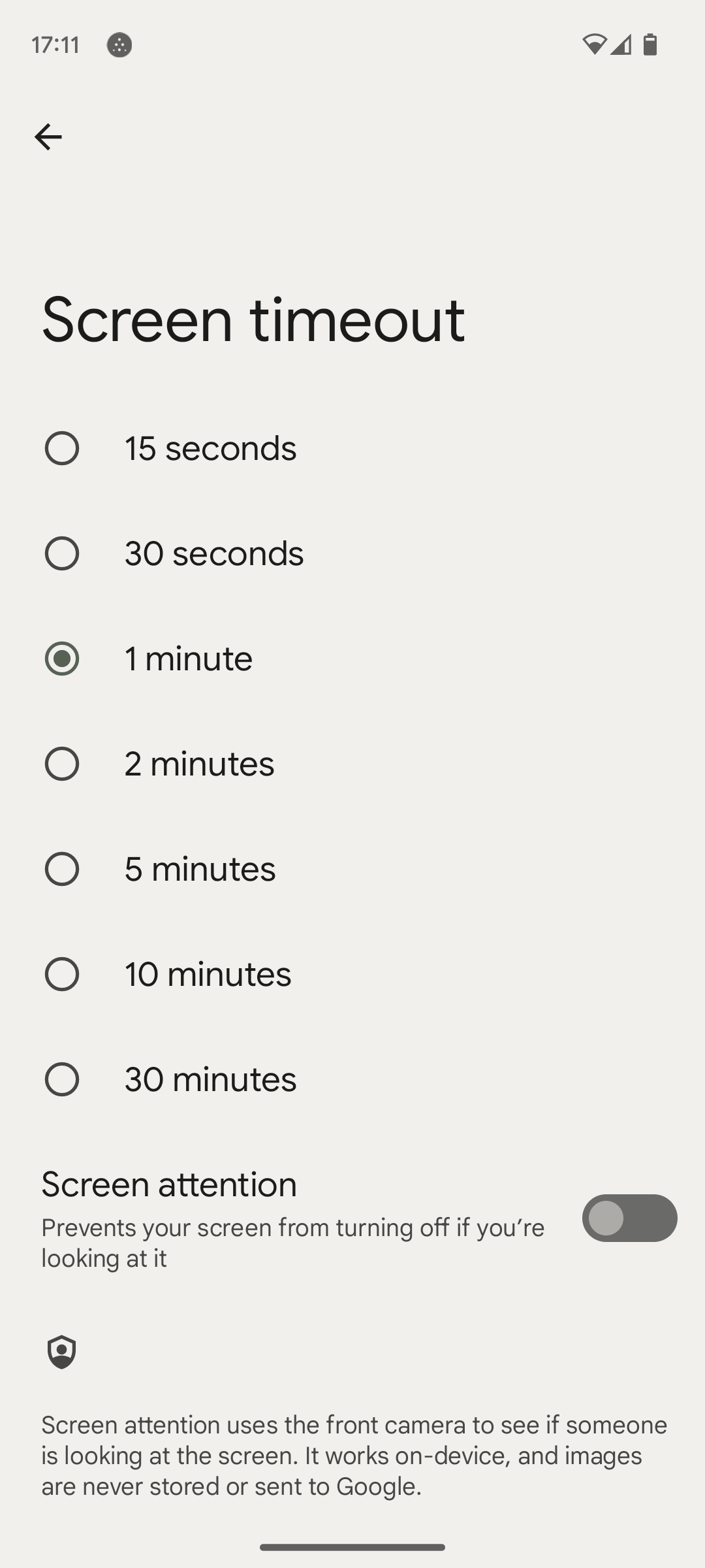

Android 13 has a keep screen alive function with preset values and even has a ‘staring contest’ function which is a bit freaky. All under the Display settings

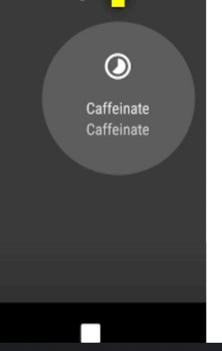

I had a function like “caffine function” on my old phone but on here on OxyGen13 with my OnePlus 9Pro the function is gone. And I think a lot of other Android users are having the same trouble as I have.
This was the function
And yes I could go every time in my settings change the screen time and change it then back. But I will miss is for sure every time at the beginning.
like @HB9HNT said I had the same feature in Lineage OS :wink:

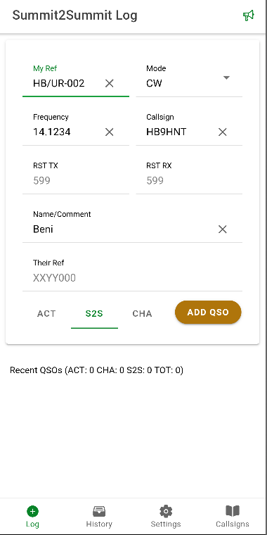

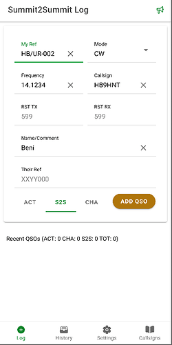

I started implementing this suggestion but ran into a problem where I need your opinion (or that of others):
If I implement this as you suggest, the palceholder values “RST TX” and “RST RX” disappear and it’s not clear anymore which field is TX/RX. The approach I took is to redesign the whole form to introduce labels for the fields. The upside of this is that the form design is more consistent with the rest of the app. The downside is that the form uses a lot more space:
This is a screenshot of the larges possible form including the S2S field. What do you think, is this feasible? Other options?

got u. Difficult question, I can only answer for myself I’m using a “normal smartphone” with 6,7" an I think it should not be a problem for myself.
I’m also curious of other opinions.
How are you feeling with that change?
Julian
IMHO the larger form should not be a problem. I like the fact that it will become more consistent with the design of the other forms within the app.
