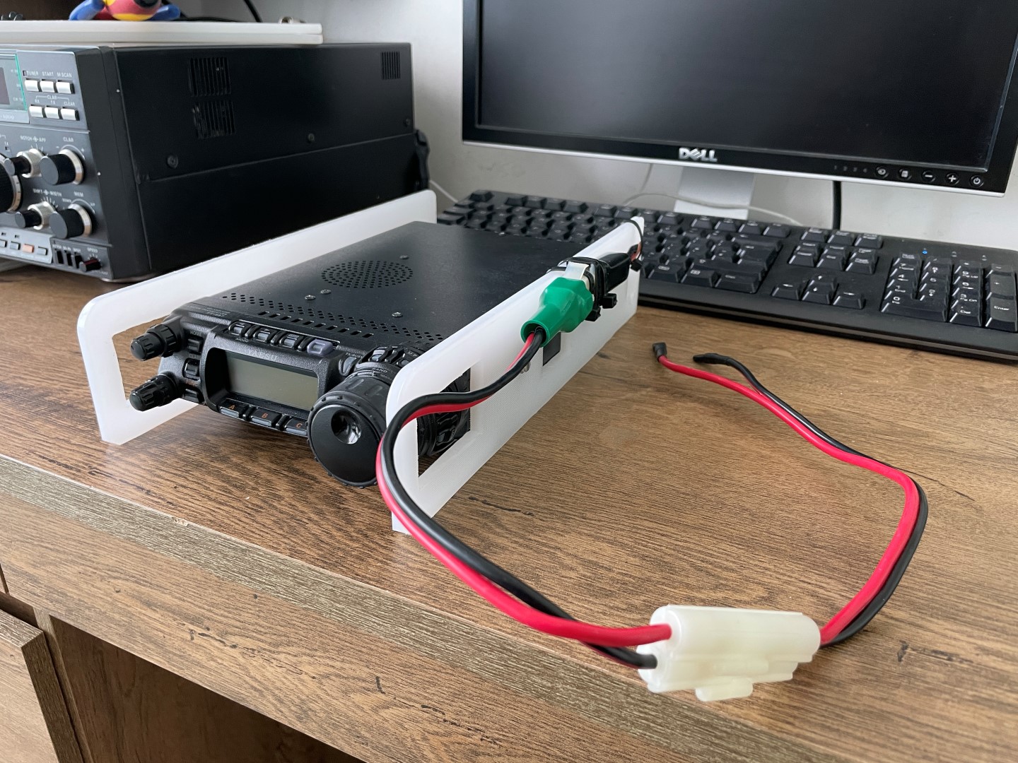

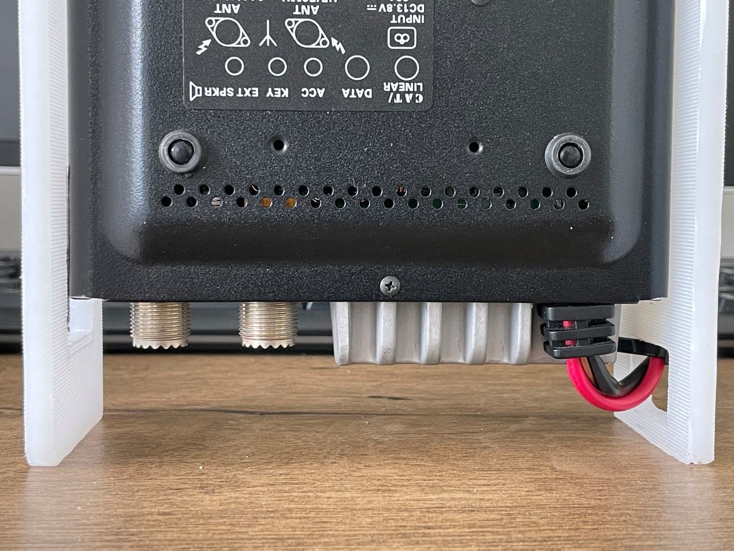

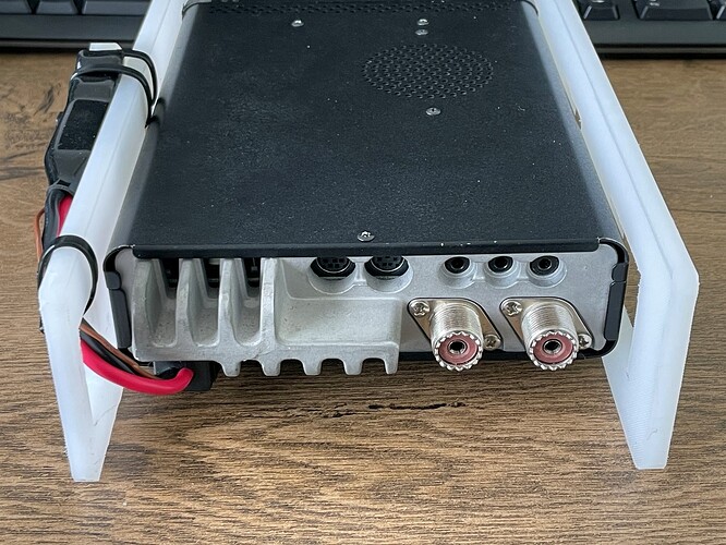

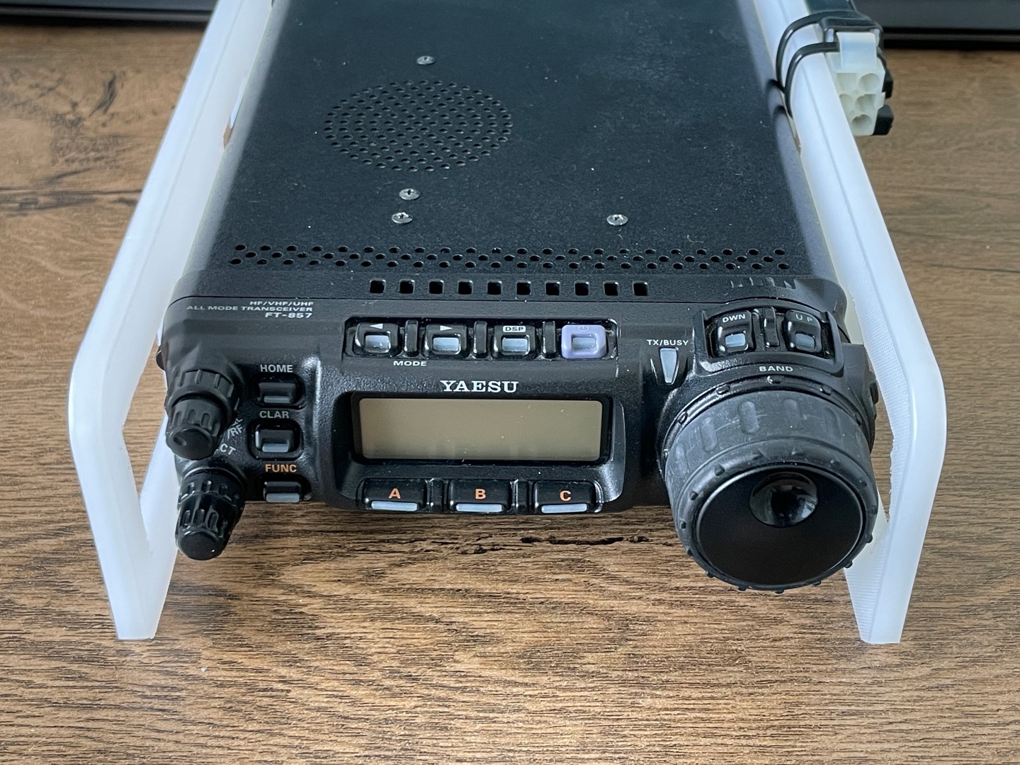

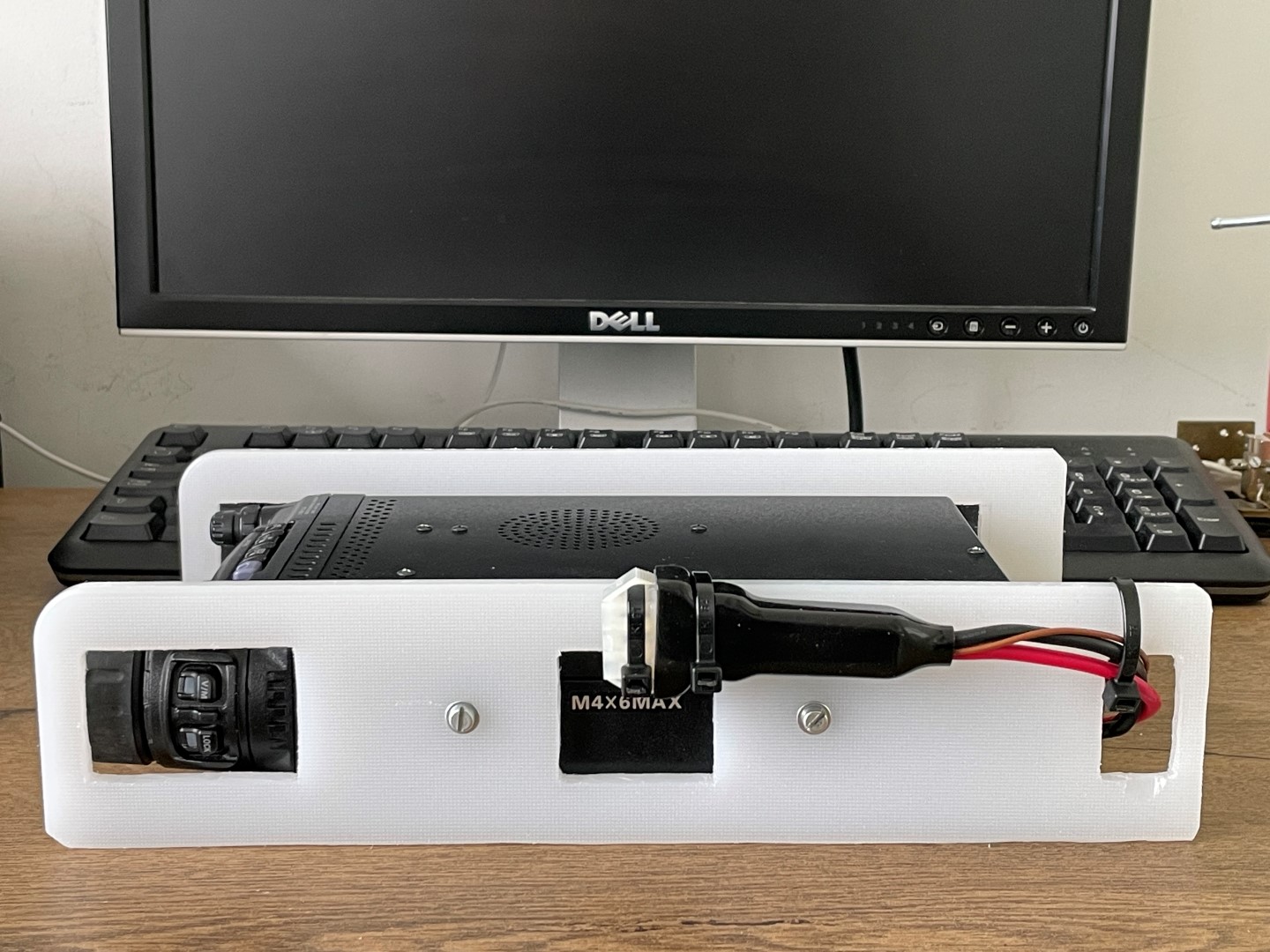

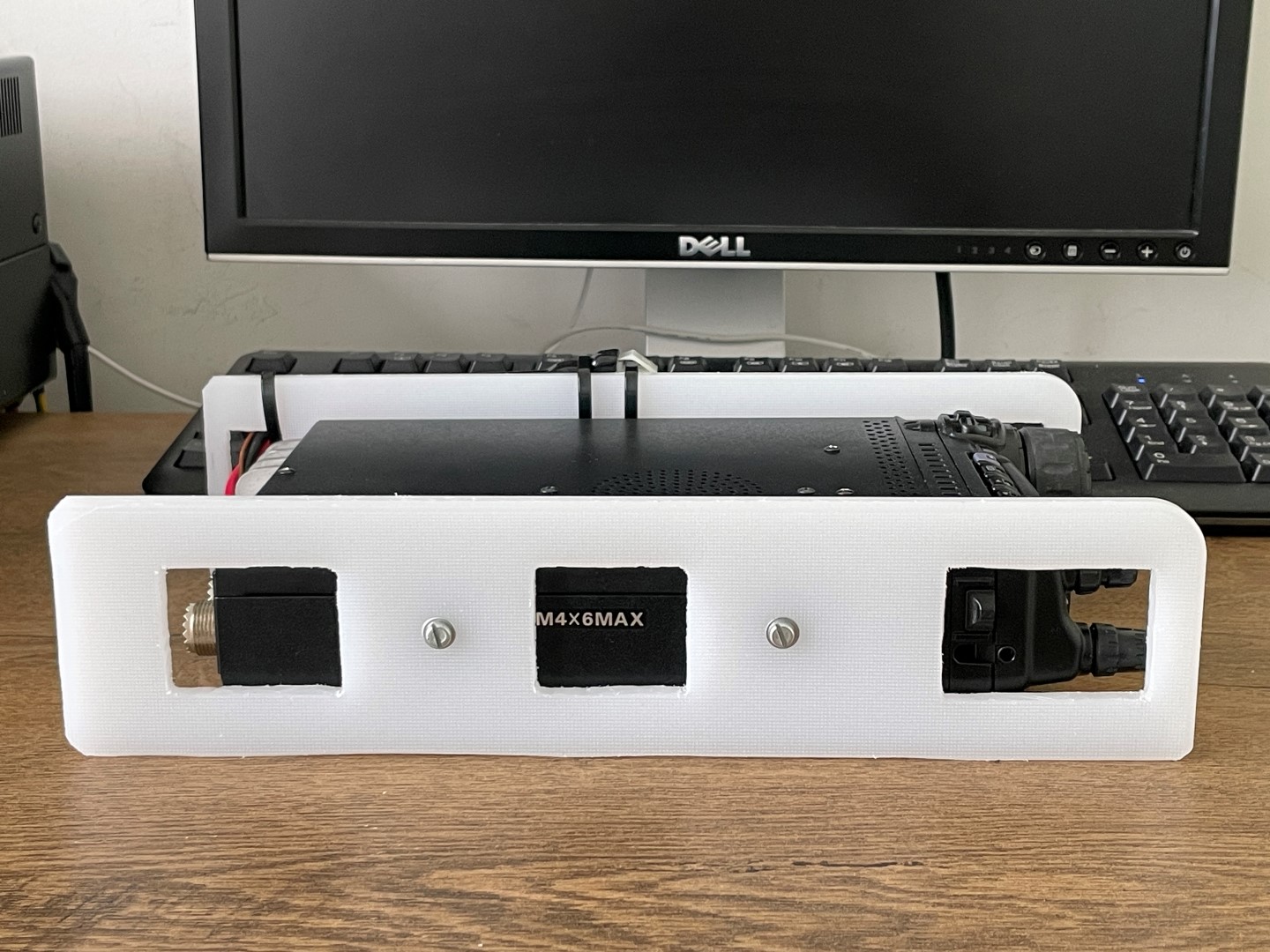

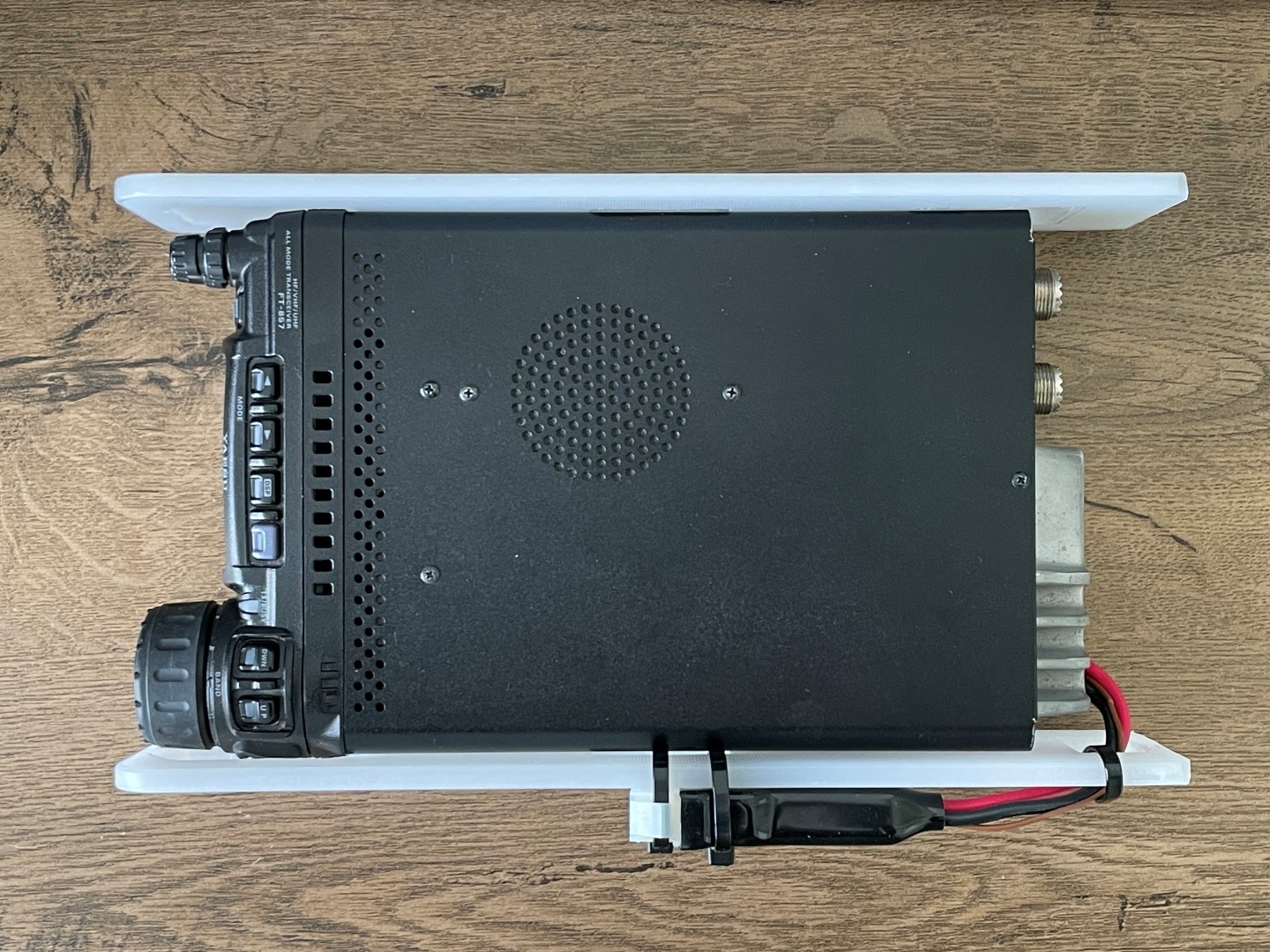

After looking around for a best field operations bag for my FT-857 I’ve tried few different backpacks and camera bags. Finally I’ve realized that whatever I choose, the radio controls are always at risk of getting a hit sooner or later. Also, I wanted to have an option to operate the rig vertically, without fear to bend or even cut cables at the back. I want protective rails in any way.

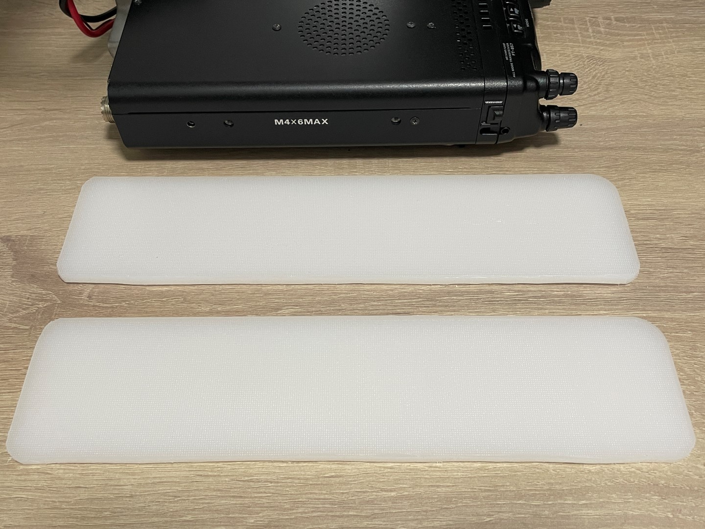

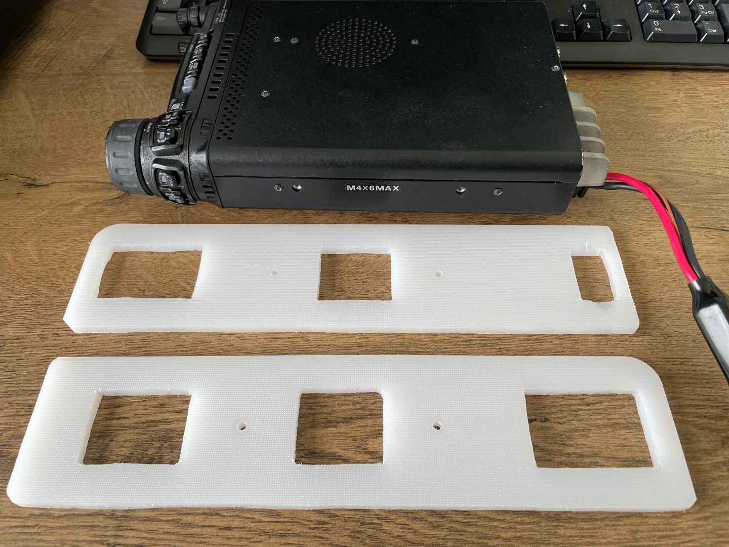

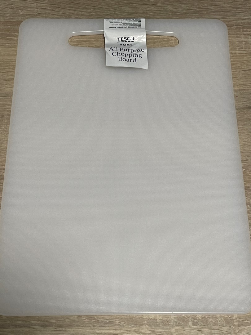

While I’ve already settled with my go for bag, the next step would be to find suitable railing. Although there is a plethora of choice on the net, this time I’ve opted for a custom made version. The only problem was where to get a readily available and easy to work with material. I’ve recalled that many years ago I’ve bought a plastic cutting board somewhere which could potentially serve the purpose.
On the next day I’ve indeed found a 3.5 EUR cutting board in my local Tesco! Those boards are made in India, plastic is very easy to work with. It is fairly flexible and soft, doesn’t crack easily and looks to be sturdy enough to use in the field.
So here is the project and what I’ve got at the end documented:

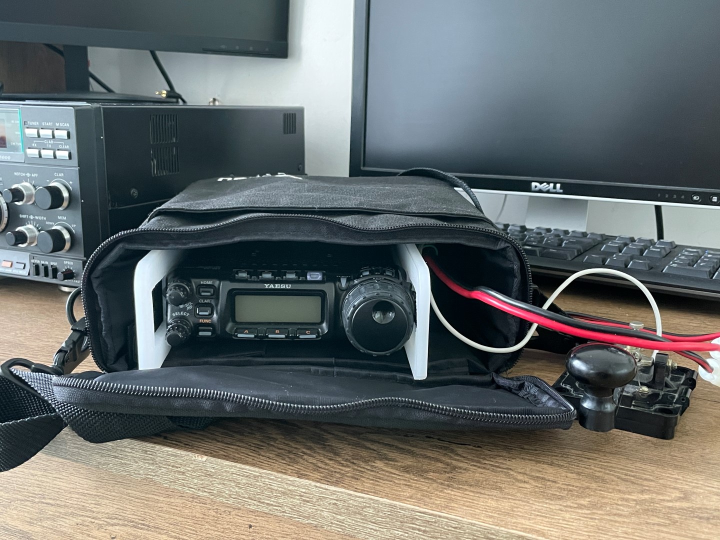

What bag/case are you using to house the radio?

That is an industrial JDSU Smartclass Ethernet tester bag. Inherited the kit from work, not using the tester anymore so it just sits in a storage. The bag appeared to be almost an ideal fit for FT-857. With rails attached the rig fits in very well and there is space left for a straight key and a hand mic.
