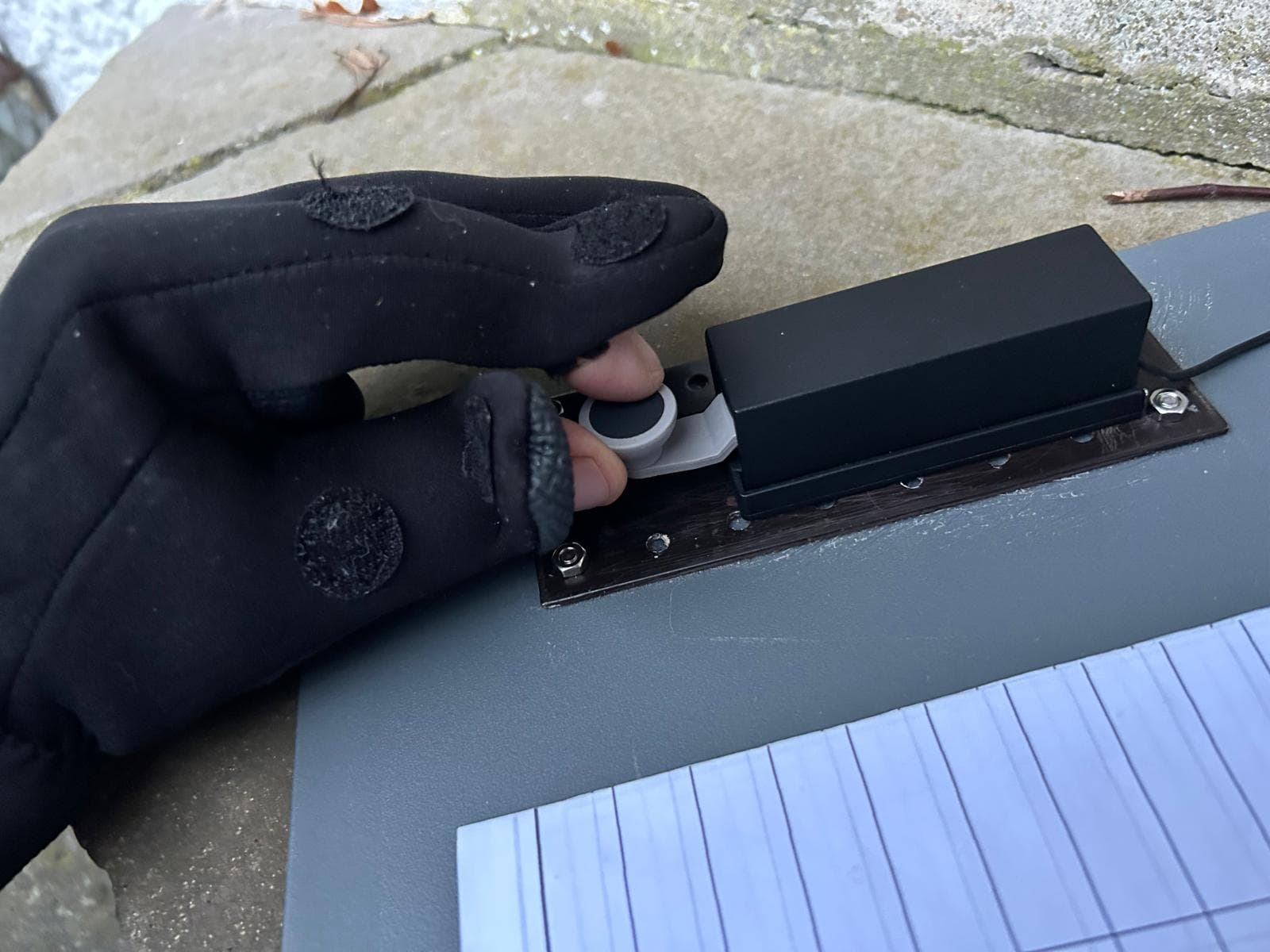

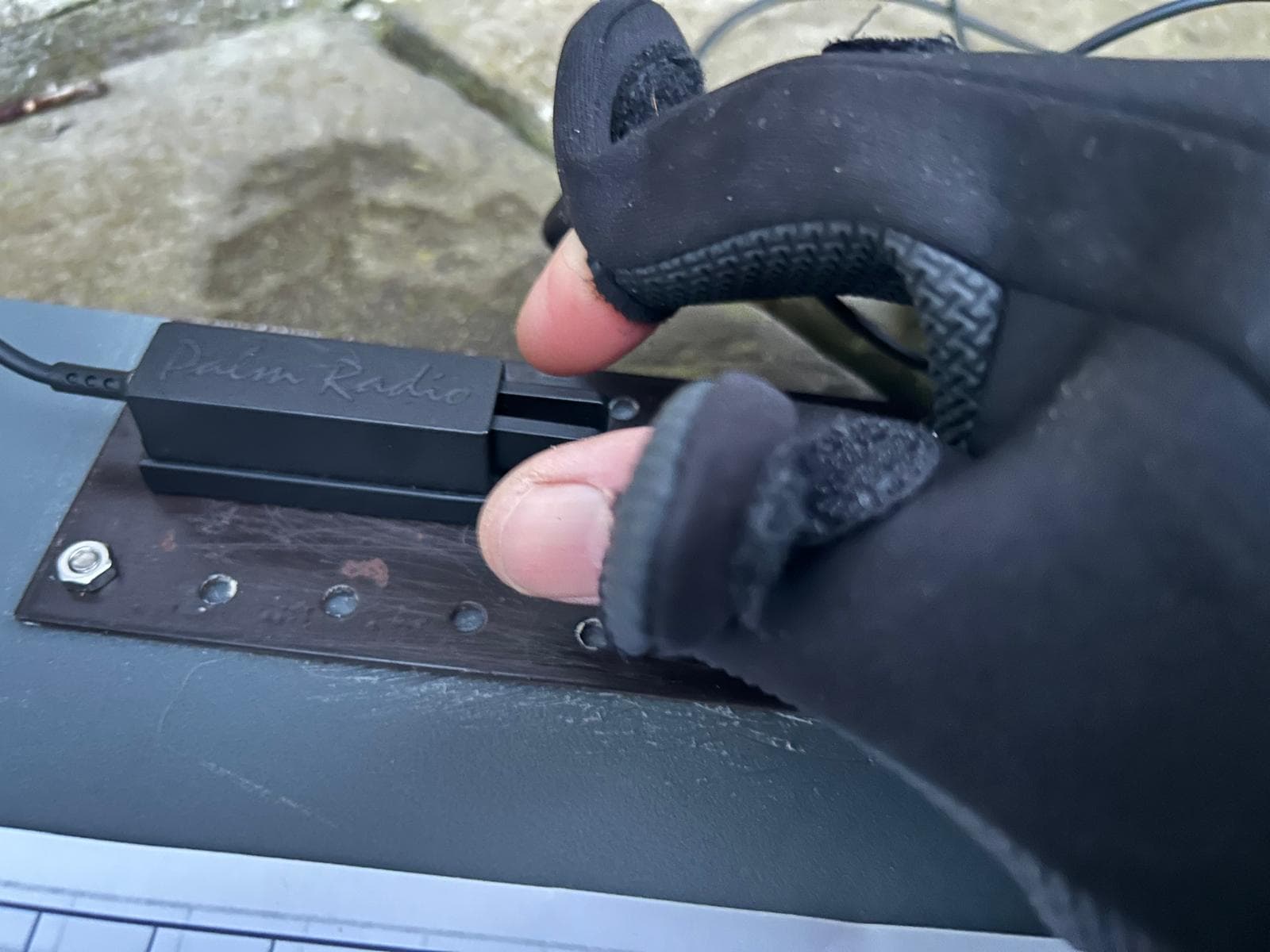

Forgetting to take my gloves with me one cold day recently I bought a pair of Bentu Premium Neoprene gloves with ‘slitted’ fold-back thumb and forefinger from an outdoorsy shop.
I’ve tried wearing them whilst keying with my Palm Pico paddles and my straight key (Palm Portable Key, PPK). I can work the paddles with gloved hand but it’s a bit uncomfortable and an effort to maintain error-free sending. On the other hand, I could operate the SK as well as when ungloved.
I’ve thought about why that is. When using the SK, my thumb, index finger and middle finger form a clamp around the SK knob - those digits don’t move relative to each other - and the keying motion is from the wrist. In fact, I don’t even need to use the fold-backs, so probably any pair of thin gloves would work [except in my case my LH is also my writing hand and I need the fold-backs to write with a pencil]
With the paddles however, although the fold-backs on the glove allow the thumb and index finger joints nearest the nails to be naked and flex in an unimpeded way, the main (knuckle) joints are still in the glove. The resistance to flexing that joint causes a slight discomfort (enough to cramp my style) so, on the last two activations, I pulled off that glove after my initial CQs and just suffered the cold [which wasn’t as bad as on some other winter days].
Conclusion: the method of gripping and keying a SK is more tolerant to wearing gloves than the more delicate finger / thumb movements needed for [non slapping] gentle paddling.

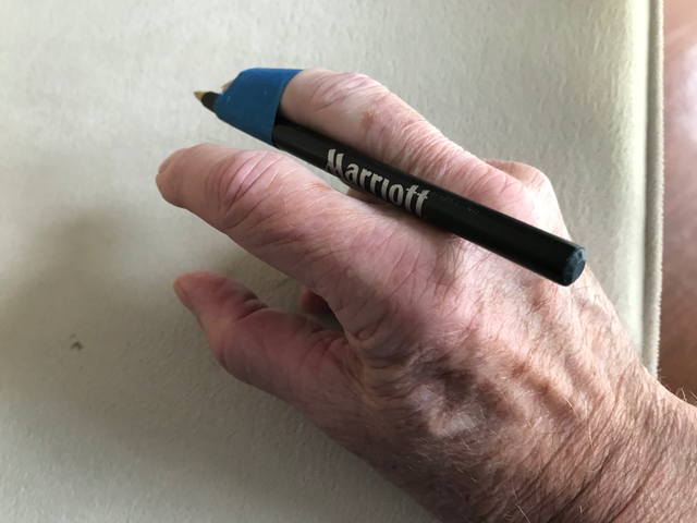

I solve the problem of picking up a pencil by taping it to my middle finger.
That leaves my thumb and forefinger free to work the paddles, but I can still write nearly as well as I can with the pen in the normal position, and the pen doesn’t get dropped on the ground.
Haven’t tried it with gloves on, though. A rubber band, velcro, or a sleeve sewn onto the glove might work better in that case, rather than tape.

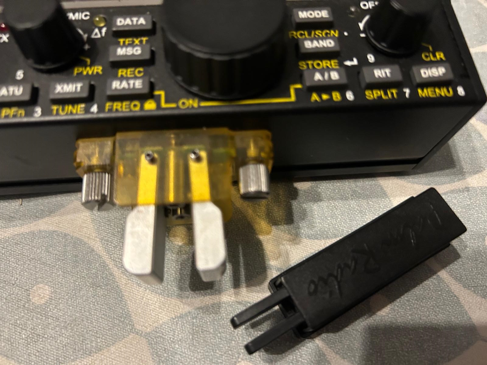

Looking online at a photo the paddle size and spacing look larger than with the Palm Nano.
Huge KX2 paddles vs. tiny Palm Nano (the latter are lovely to use)
I have no trouble paddling with the KX2 bolt-on paddles (KXPD2) wearing a glove but in general don’t like them (especially the travel distance needed to close the paddle switch). The paddle size and separation are big enough for a troll’s hand.
