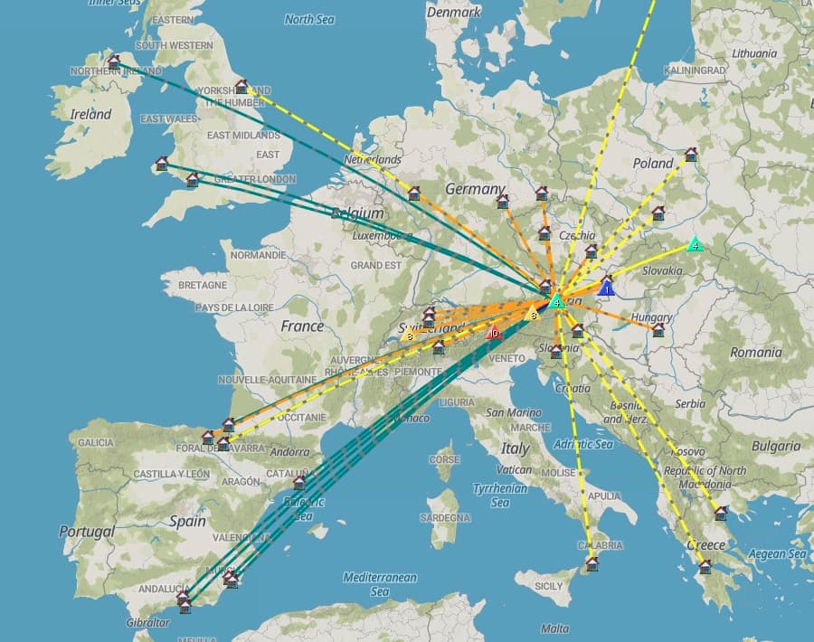

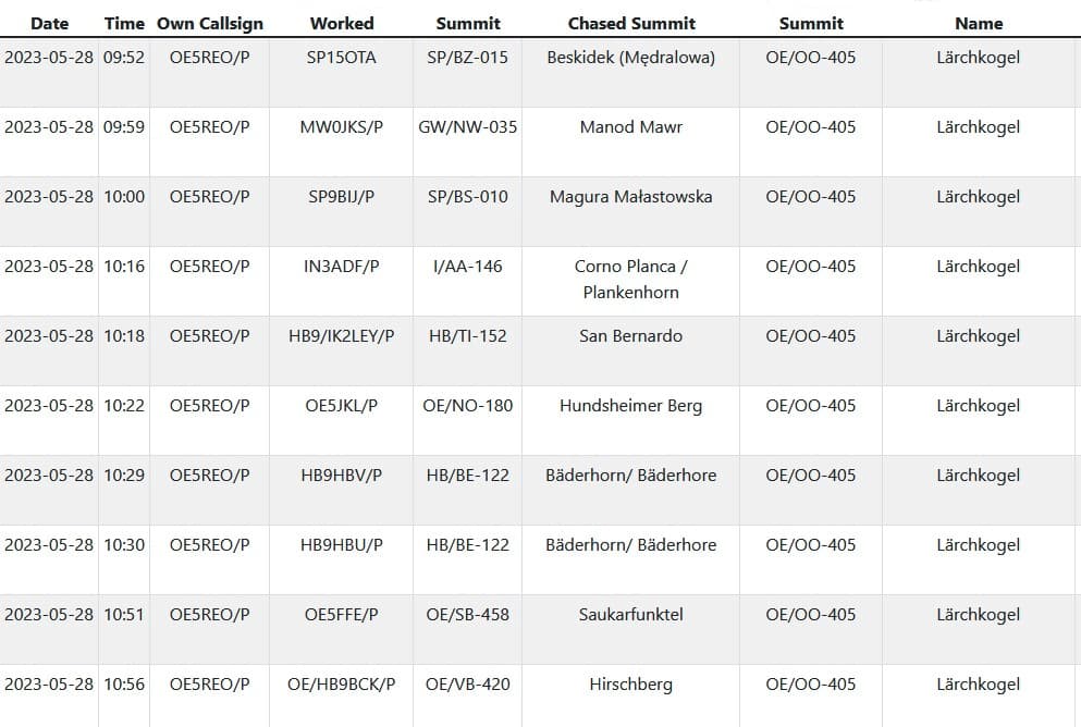

On my activation today I had 10 S2S (and 51 QSO in total):
I noticed that at the QSO map there are only 5 S2S showing:
So I did a quick check of the complete log and found out that these calls are missing on the map:
S2S
  • SP15OTA
  • MW0JKS/P
  • HB9/IK2LEY/P
  • OE/HB9BCK/P
  • HB9HBV/P (HB9HBU/P is showing … same summit)
CHASER
  • EA8DKV
  • F4FTJ
  • SQ9NOT (SQ9MDF is showing … same QTH)
  • SV2CNE
  • F/DD6DO
  • SQ9BQW
  • 9A8RA
  • DD7UW
  • OE5GFI
Probably the chasers don’t have any locator information on their profile and/or qrz.com page. But I wonder why only half of the S2S contacts are displayed on the map?

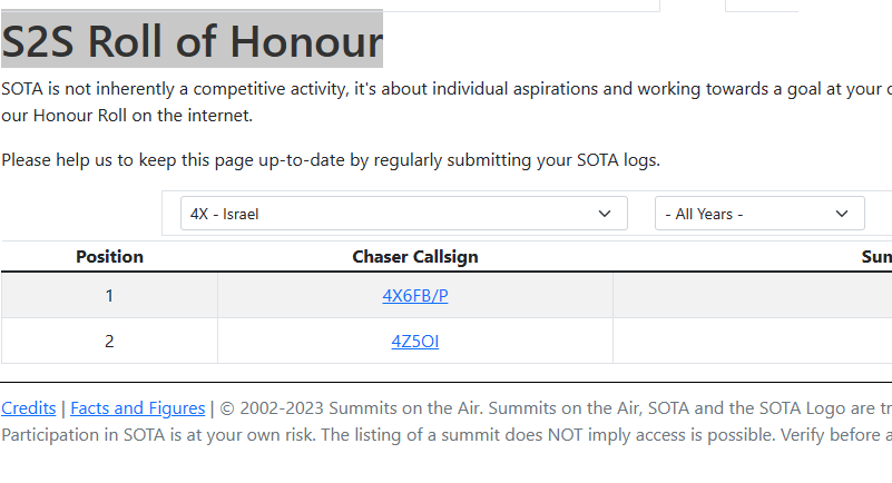

Hi Andy

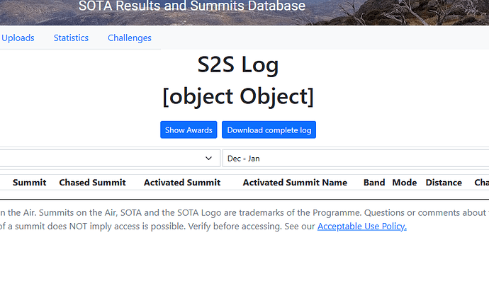

I have noticed that for the S2S Roll of Honour when the chaser callsign begins with a number e.g. 2E0ABC then you try to view the S2S log the following screen is displayed.
I tried it for other numbers and get the same. I think it is a T-SQL issue it doesn’t like objects beginning with a number, they have to be bracketed. The fault doesn’t appear on the other Honour Rolls.
It all works fine on the old SOTA database.
73 de
Andrew G4VFL
It’s a Javascript issue that i’ve seen on other pages - basically we test to see if we’re a number (User ID) or a callsign. The test for numbers is aggressive enough that it allows a starting number, drops the remaining non-numeric text and then assumes it’s a UserID. There’s no corresponding user ID, so you get the error.
I’ll dig into it later.
Best to check for both formats - all-numerical ID or callsign - using regexes. Then you can be sure - here’s one in PHP which I used in the SMP to check callsign format:
preg_match('=^[1-9]?[a-z]{1,2}\d{1,4}[a-z]{1,4}$=i', $callsign);
Works for 99.99% of callsigns…

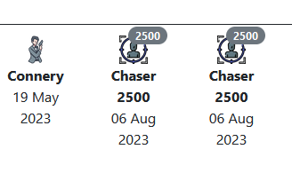

I’ve just uploaded my logs from today and I’ve received the chaser 2500 badge - twice. I think I should just have one badge:
Yes, this appears to be a subtle bug where you have a 0 point chase that corresponds with your 2500 point chase, so it has multiple “2500” point chase levels, if that makes sense. I’ll push a fix sometime later tonight.
Thanks Andrew.
If you want me to break anything else let me know :slight_smile:

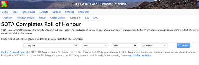

Hi Andrew
Sorry to trouble you. It appears that there is the old problem of callsigns beginning with numbers on the Completes Roll of Honour.
I have also noticed that if a band is entered in the “Completes” the “Loading” does not terminate. On the old database it used to just ignore I had put a band in. I assumed this to keep the load on the database low. The way I reset this is to clear the browsing data.
Many thanks for all your efforts with the database.
73 de
Andrew G4VFL
I have this fixed already, but I haven’t pushed it live yet as I have a bunch of other changes included in that batch that I don’t want to inflict on SOTA until they’ve had more testing.
So this hasn’t worked forever. I also have a fix for this that will be part of the other batch of changes, but actually is broken on the API side and has been from the get-go. Any combination of band or mode for completes does not function correctly at present (other than in our dev environment where the other stuff is undergoing testing).
Expect both to be released (along with the rest) in a week or two.
