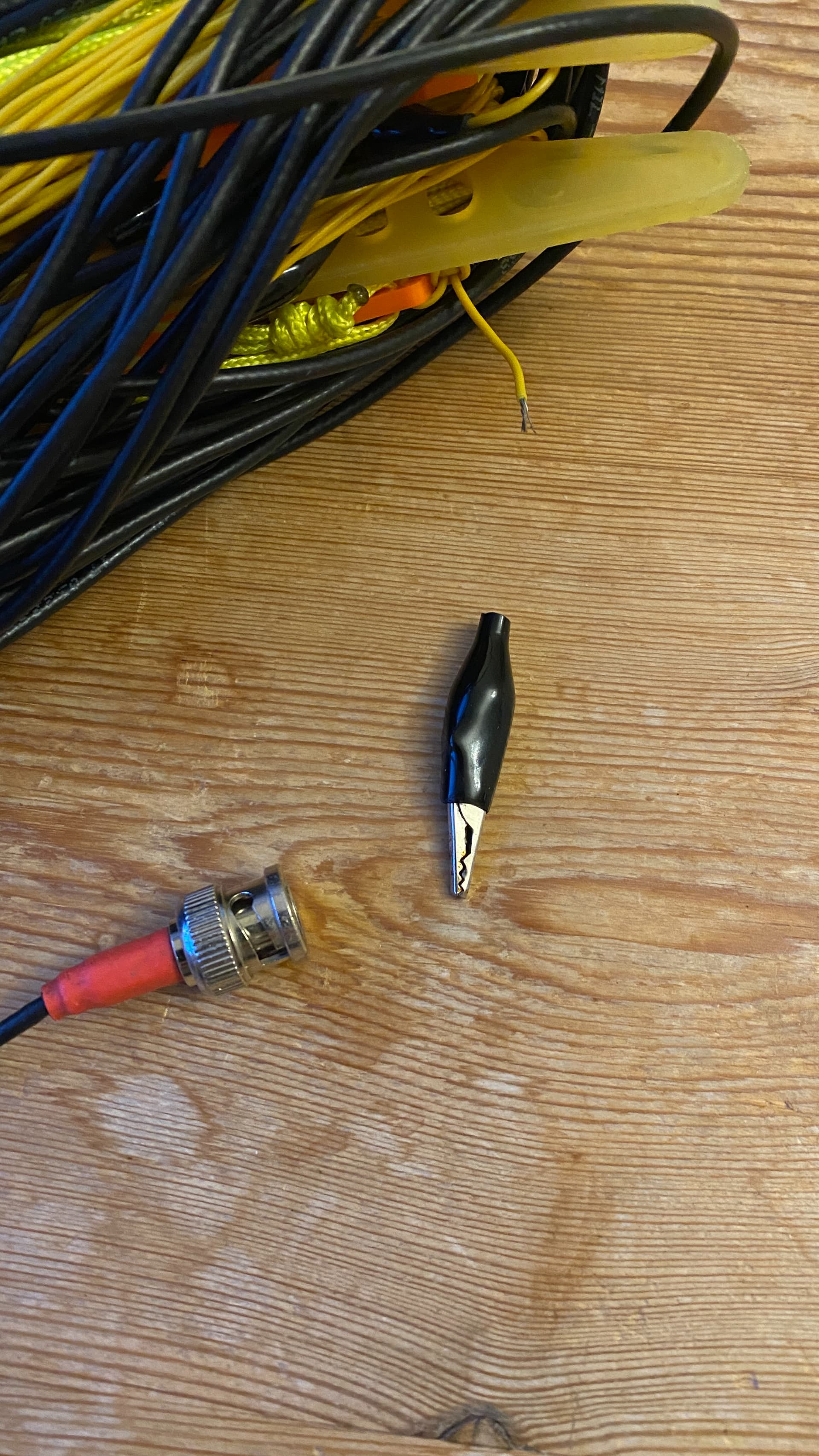

This happens to my [ageing] 60/40/30/20 linked dipole - in the field - from time to time. The UltraLite wire breaks off right at the solder joint on one of the croc-clips used to make the links. I effect a temporary repair by using my teeth as wire strippers so I can stick the bare wire in the other croc-clip. I’m taking that linked dipole tomorrow, so fingers crossed.
I’ve had that happen. Ideally the rubber boot would support the wire better and reduce the flexing on the soldered joint which is why it fails - but it’s easily fixed with a soldering iron. :slight_smile:
The one of the plastic clips broke as well previously and fixed this temporarily by using a piece of guy line - which has become the permanent solution…
Got the soldering iron out and all fixed now. Put a couple of layers of heat-shrink tubing to cover/hide my handy work as well as part of the metal clip itself. Let’s hope it’ll stay in place for a while. :crossed_fingers:
Replace the croc clips with these.
Easy to stress relieve the connection with heat shrink.
Simple to connect and disconnect even when wearing gloves.
Don’t seem to corrode or rot even in Scottish weather.
I’ve been using them for years. A massive improvement over croc-clips, Lucar connectors etc.
FMF suggested resoldering all of them awhile ago on another thread - good if you can be bothered but I find it’s less time and effort to solder them back on as and when they break off. My temporary field solution (above) is good enough to continue the activation.

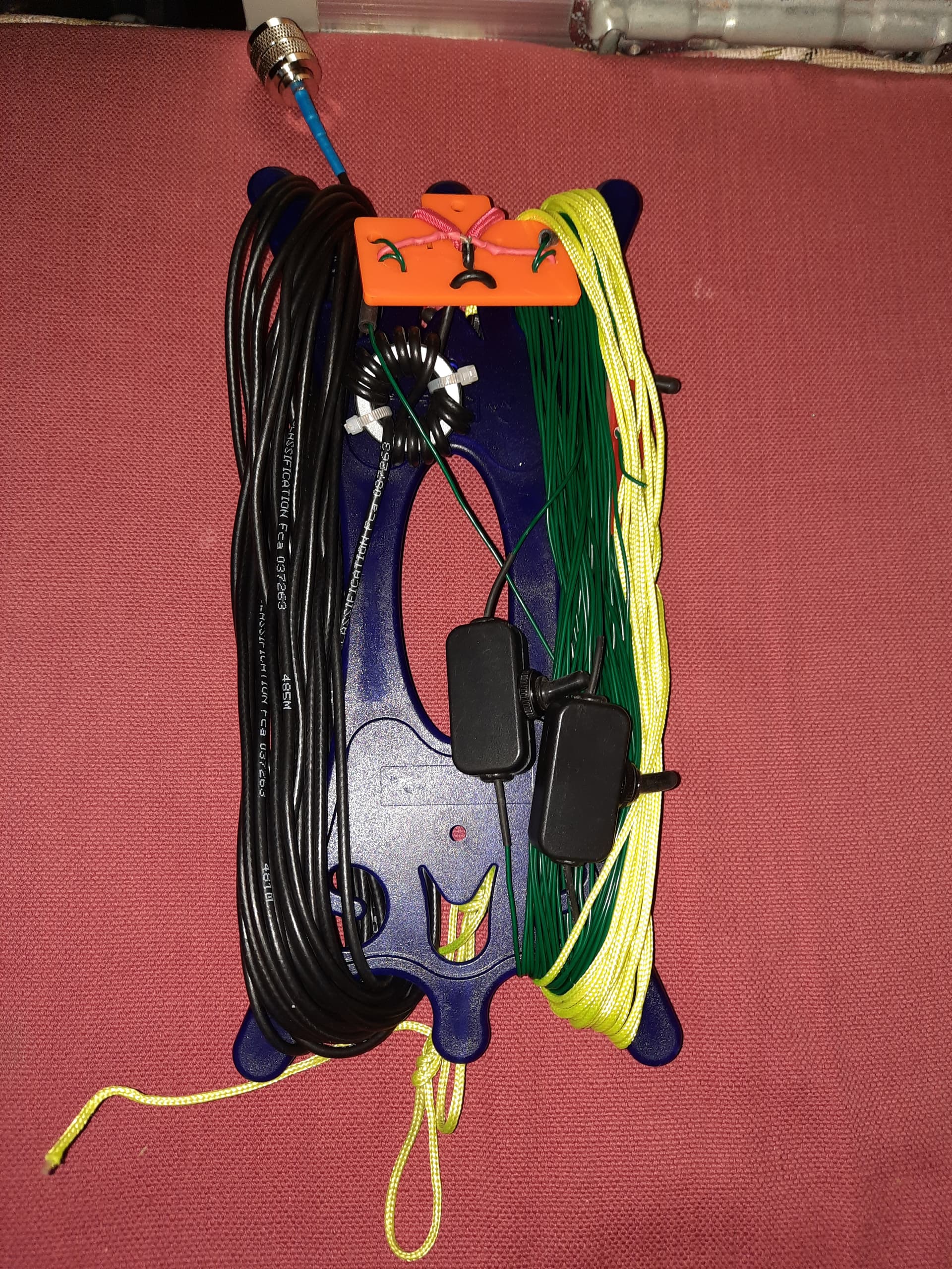

Having spent far too much time resoldering dipoles Dave, M0JKS and I have been using a ‘switched dipole’ for the last six months. With no issues up to now. We had to recalculate the element lengths because of the capasitance effect, but it seems to work well. This one covers 40/20/15.
