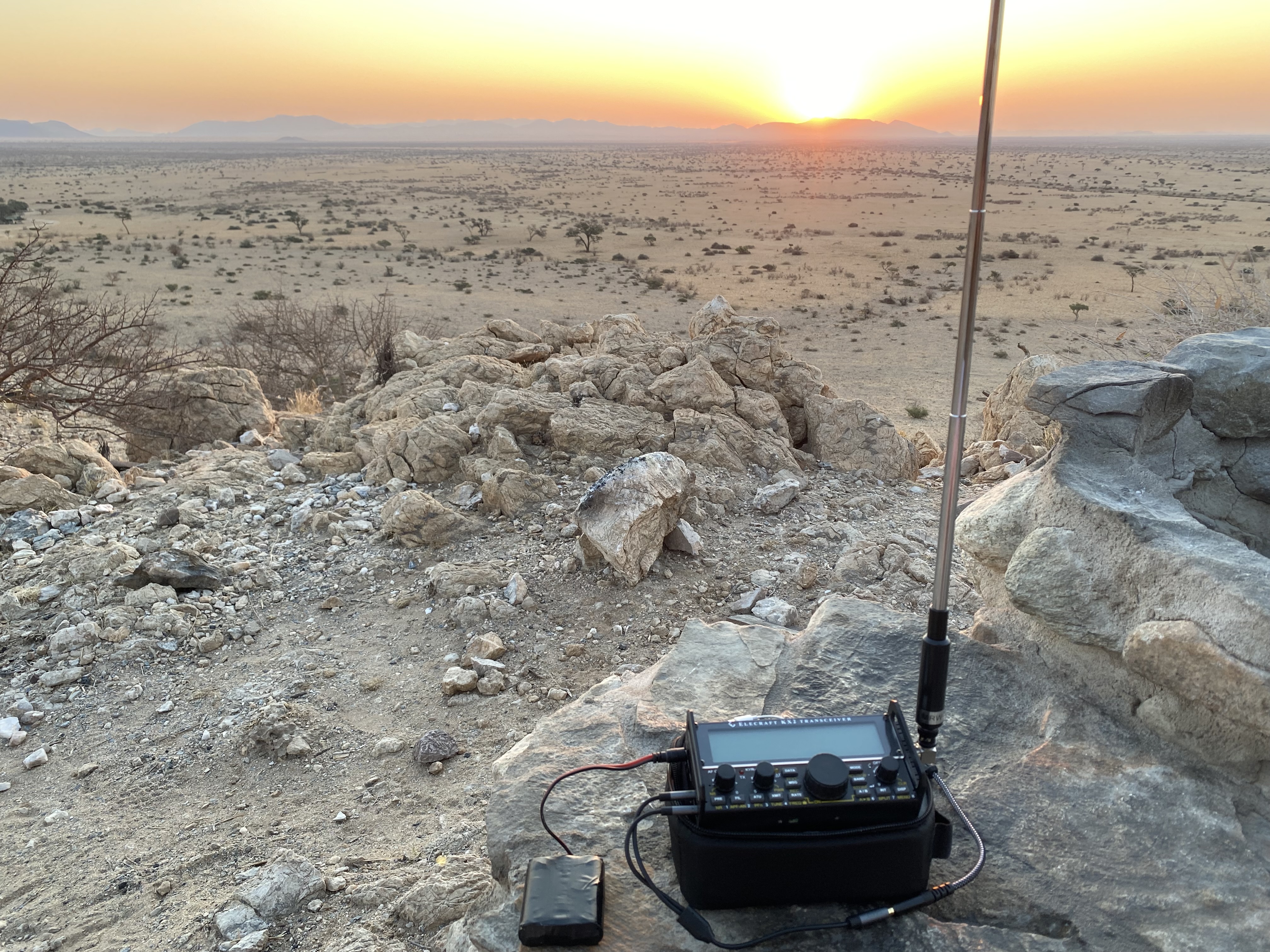

Amazing radio. Use it a lot for digital work. Took it travelling to Namibia last year and lost my main antenna for a week. Had to use the short whips I took in my hand luggage until I got my bags sent to meet us at a camp. Made a lot of contacts using just a short whip from remote locations.
What antenna is that you are using? Well done also for conducting the first SOTA on the surface of Venus!
That looks like one of the MFJ HF whips. They made them from 40m up to 6m. I’ve used the 20/15/12/10m versions and they’re great with a KX2 with an ATU.
With MFJ out of business, we’re left with homebrew versions or the Elecraft whips.
Chris
Yes indeed an MFJ antenna. I have two, one for 15m and one for 18m. Setting up from camp in the evening I was regularly getting into North America from V51 with the antennas and 5w FT8. Not quite SOTA on this occasion but yes might as well have been the moon!
