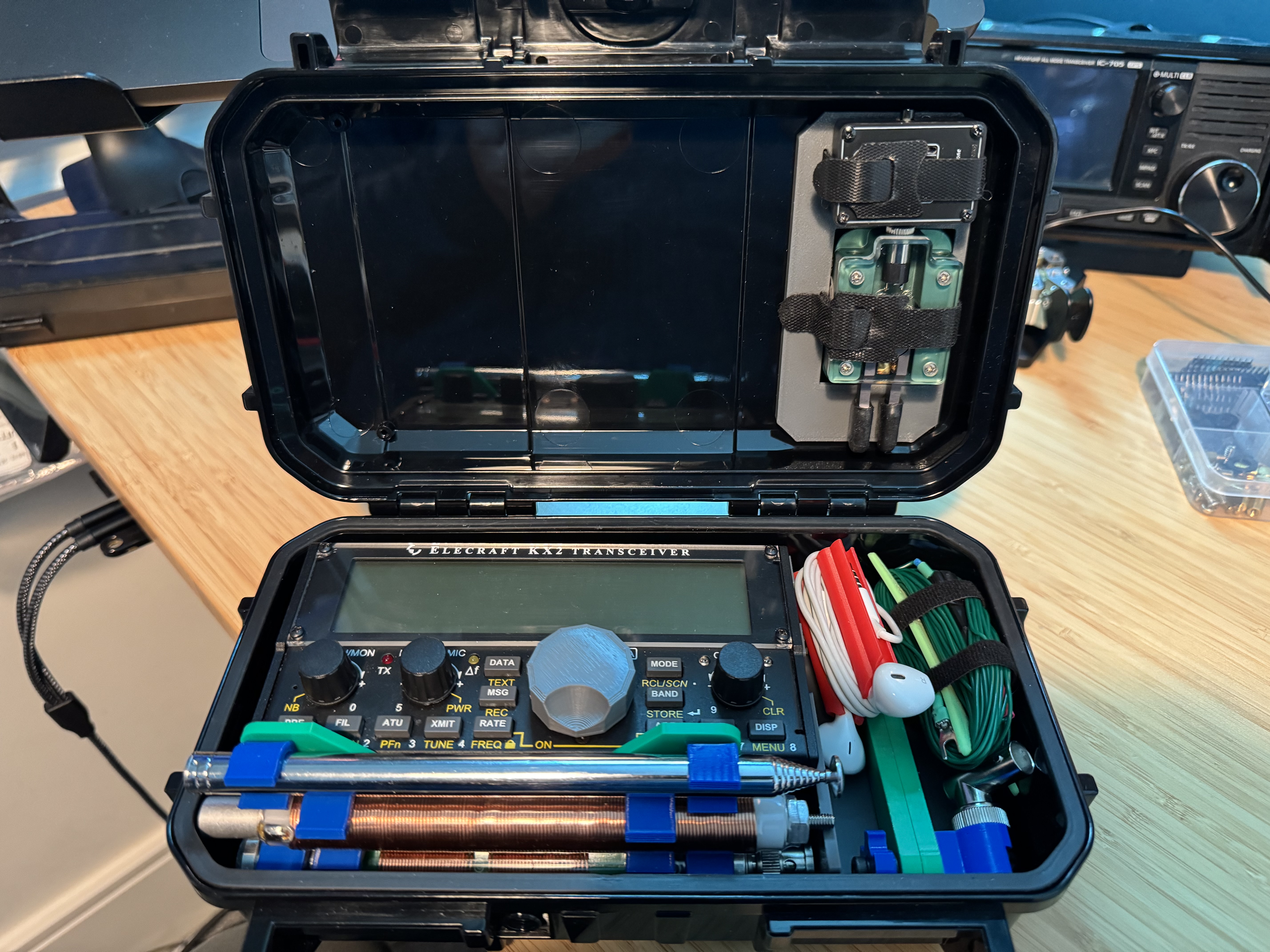

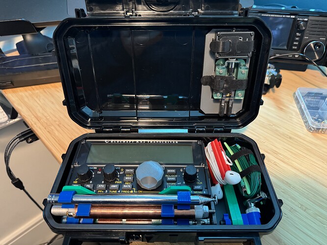

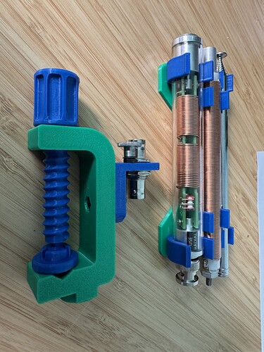

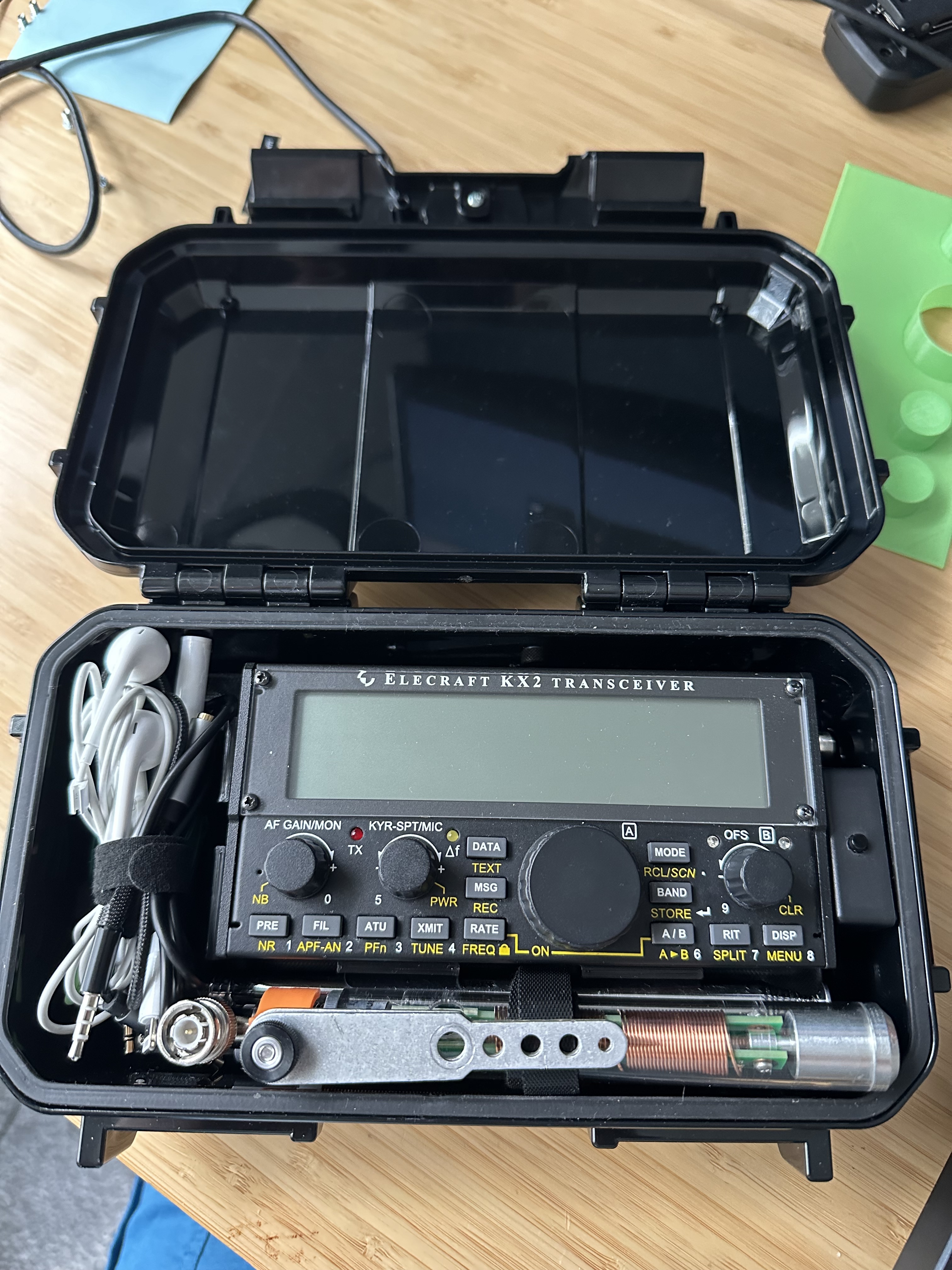

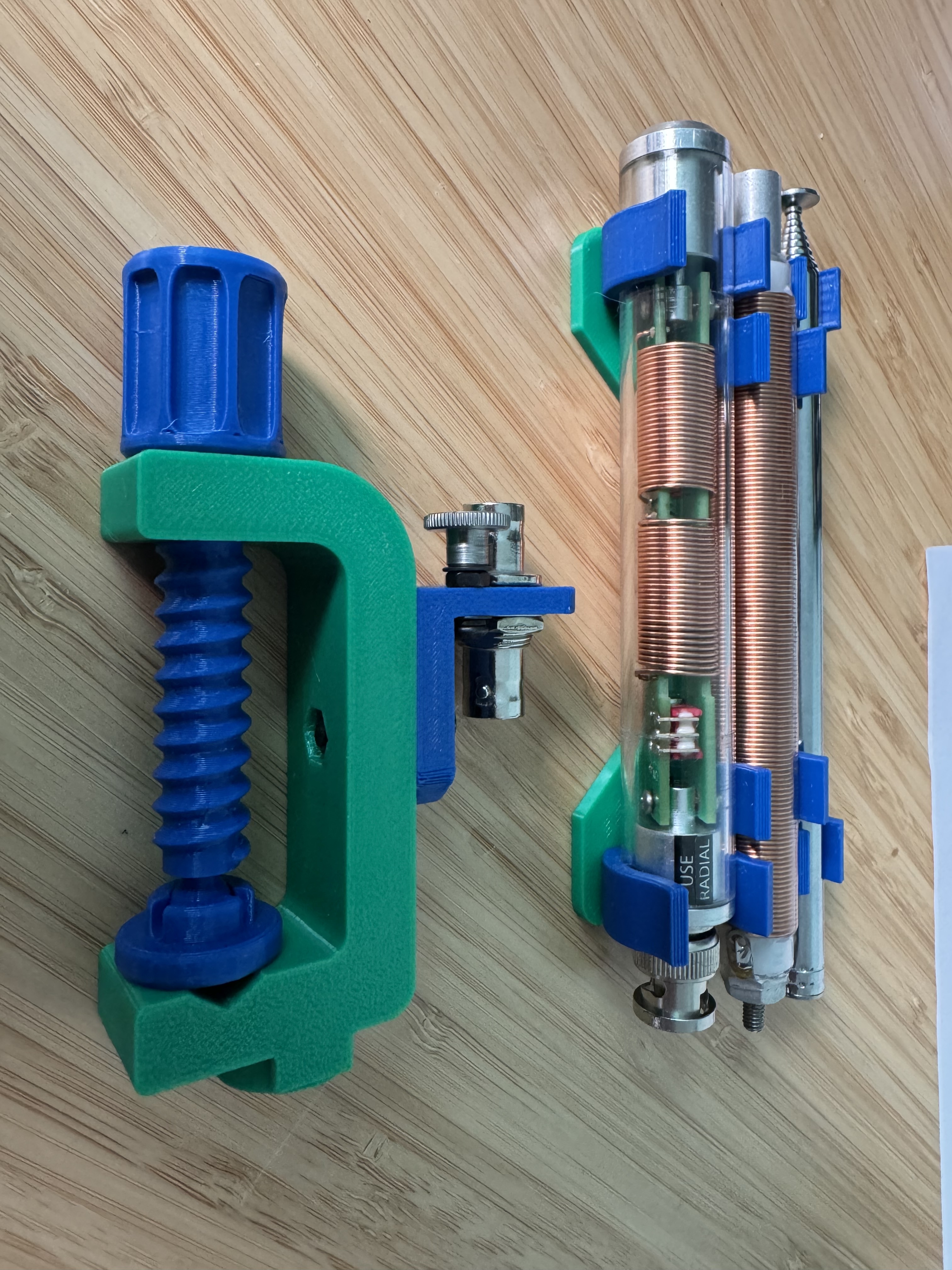

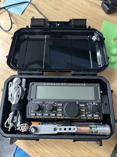

Just to add another case into the mix, I grabbed a Seahorse SE56 case (from Amazon, but they seem to be available elsewhere now) and remixed SA2CLC’s printable inlay to give me a bit more space.
I’ve since been reworking it entirely to tidy up further.
Making use of a few of the fantastic prints here.
