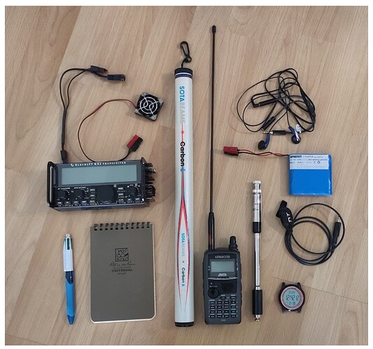

I use a normal plasic box for my KX2 … see the photos:
73 Martin
OE5REO

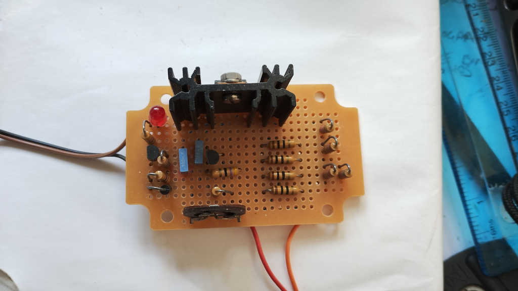

Make a charger, LM317, 2 transistors and some resistors. Else open wallet and spend mucho dinero. I know what I’d do and that’s what I did.
The link at the bottom of this post is what I built.
Already done that getting the KX2, and still having therapy for it. :sweat_smile:
£70-£80 for a charger is ridiculous. I’ll have a look at how you built yours and see can I give that a try. I checked the inner board of the KX2 and the PCB says REV.A on it. I’m hoping I’ve not been sold a load of old pony. Is the Rev A issue fixable? EDIT: Yes it is. Looks like mines been done, though hard to be 100% sure as really you are just looking for a washer… :grimacing:
Mine was made from junkbox components at zero cost apart from time.
The 317 gets warm at about 225mA charge current. The heatsink could be much smaller but that one was in the junkbox. Brown/Black are DC in and Red/Orange wires are the output tothe KX2 battery.
